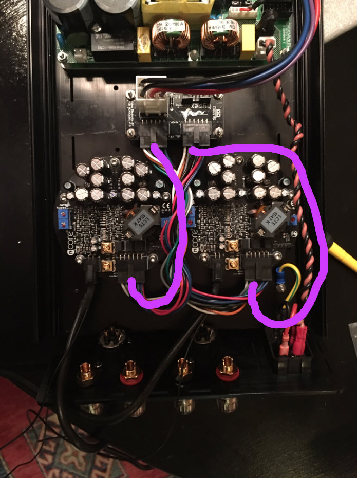

Maybe the best way is to turn each 90 deg so that the nC power connector face each other.
I was thinking the same, but it might be tricky considering the limited space. I would start by verifying if it is an issue or not...
I will be trying various things to investigate. Any pointers are appreciated, especially things i can do to investigate if the NC400 amps i hooked up are in some form of distress causing them to under perform.
Do you have a standard oscilloscope? It would be good to verify that there is no oscillation going on.
Any thoughts, suggestions, advice welcome.
I do not see the 10 pole flatcable in the picture. Do you have one? It should be connected...

Maybe the best way is to turn each 90 deg so that the nC power connector face each other. This might require some offsetting alongside to accommodate the cables. I would have liked to run the power feeding to them close to that transformer on the board - that means splitting the paths and probably an offset position of the splitting board.
Yes, if I had it to do over again I would definitely have gone with a wider case - I didn't realize how close together the nCore's would be. I do have a longer set of power connector cables that came with the nCore boards - I was thinking I could route them as shown in purple in the picture below. Julf makes a good point - I should probably get things up and running to see if there's an issue before obsessing over an "ideal" layout.

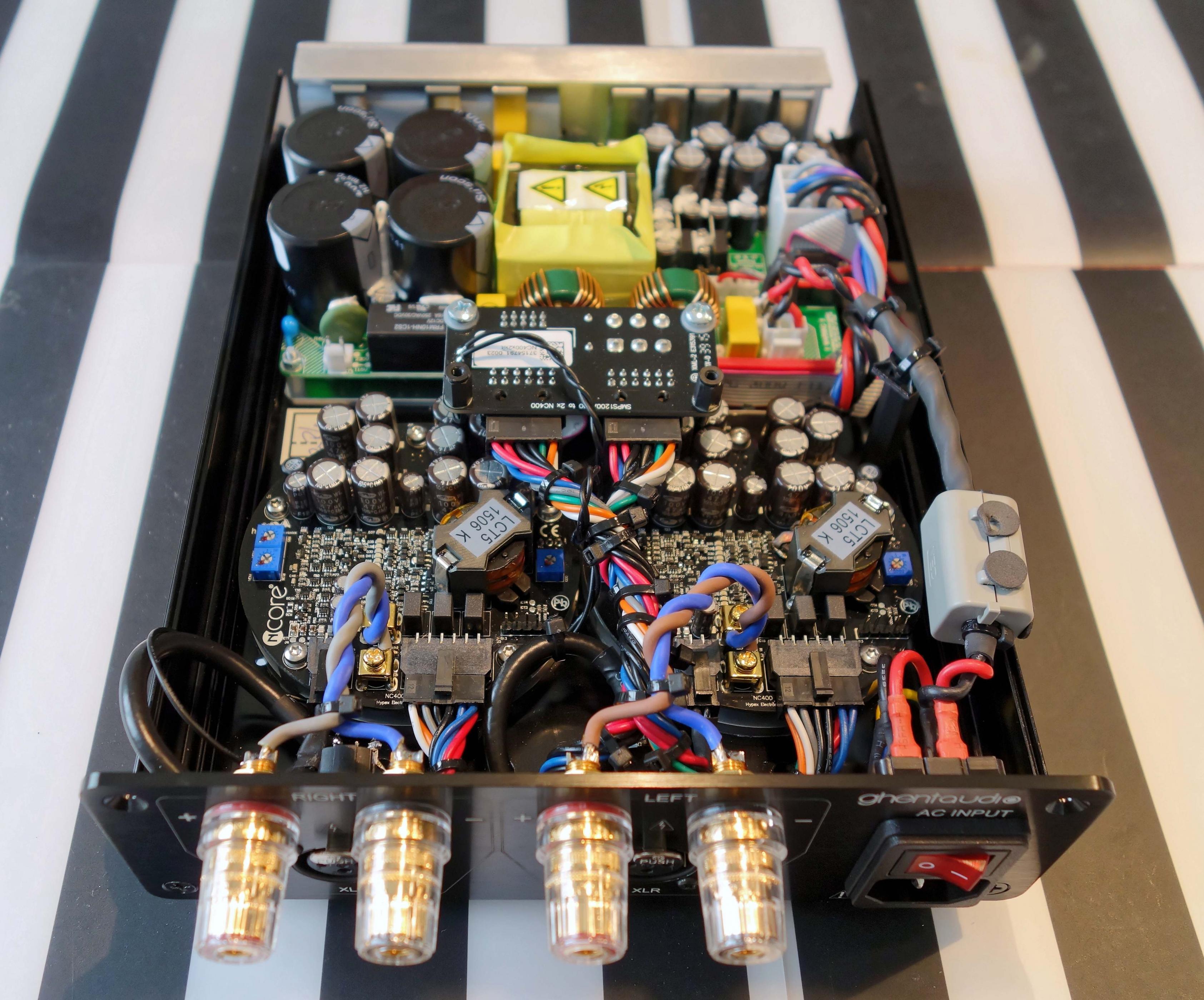

I used the same stereo case from Ghentaudio to built my stereo version with the NC400s and the SMPS1200 power supply. It is a tight fit, but manageable. I routed all my cables through the middle using cable ties over the NC400 units from that cable splitter board supplied by Hypex. I used the original holes drilled by Ghentaudio for those NC400 and the SMPS 1200 modules. The power cable from the power supply has been affixed to the case at the left side in a somewhat elevated position. I drilled some additional holes into the bottom half just behind the PS and in front of the rear assembly for increased convection.. The only "real" problem in my opinion is the heat generated by those two NC400 modules and especially the PS in that small volume (> 45°C). I ended up mounting a moveable fan vertically on top, blowing across the case in my sideboard, which reduced the case temperature by about 10°C.

Is that gray box in the lower right a fuse? I hadn't thought of installing one, but I guess that might be a good idea because looking at the SMPS1200 it seems as though the fuse is soldered to the board.
I probably got the "old" version of Ghentaudios's stereo case, which seems to be sowmewhat shorter than yours, same length like the mono version. I thought, he would switch to a wider one in th emean time, as he sent me a drawing of that some time ago, but it looks like he changed his mind and converted it from "wider" to "longer" instead.
That picture is from my stereo unit.
PS.: That gray box "fuse" on the power supply cable is actually an inductor...

I am using my stereo unit now for several month without any noise or hum whatsoever. So this routing shouldn't be problematic, especially because those twisted cables just carry mostly DC signals. In- and output are fed separately and routed the shortes possible way at the rear.

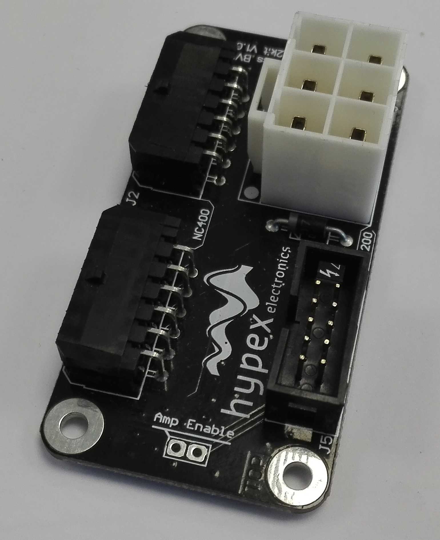

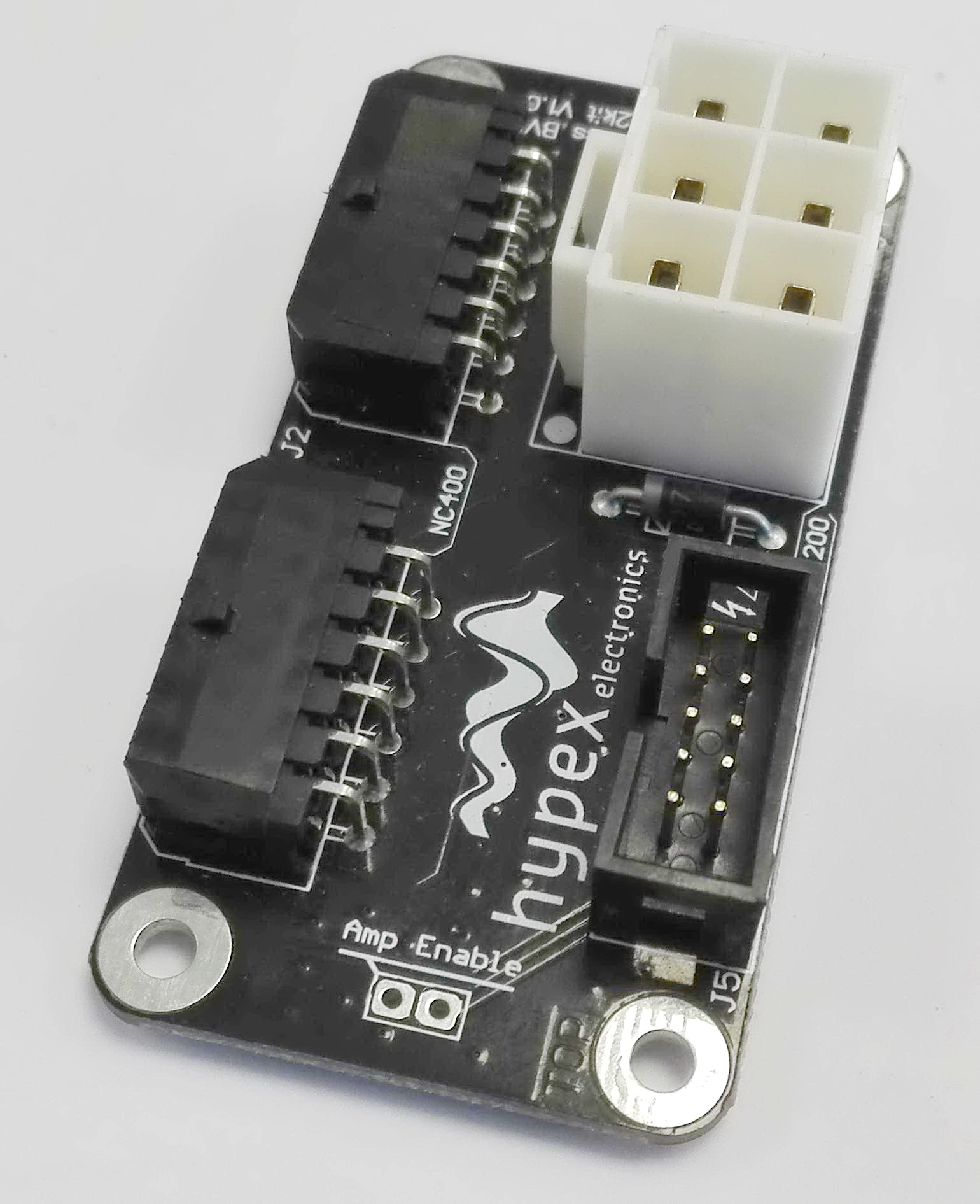

For the NC400x2 kit, there should be a cable that connects the J4 header on the power supply to the adapter PCB (J5 in the attached picture).
I corrected the picture exposure somewhat... to make it clearer 🙄

It seems, that you havn't got the "Amp Enable" connected on that little bridge board at least on the previous picture you posted. Your amp won't turn on without this connection...

As you can see in the SMPS1200 datasheet, this flatcable carries the Vaux, Amp Enable and DC Error. Mind the jumper settings...
You can still connect the nAmpOn of the NC400 to a ground point, as you would do if you use an SMPS600. The NC400's software will check the input voltages and determine when to switch on. The SMPS1200 has an Amp Enable feature (open collector). When usinging the Amp Enable in the breakout, the nAmpOn of the NC400 will be automatically pulled low. Its an extra 'feature'. Just check the datasheets for more information.
True, one can go the separate way and hook up the "Enable" of both NC400s somewhere else, but the combined "Amp Enable" on the bridge board does all that neatly in one place.
