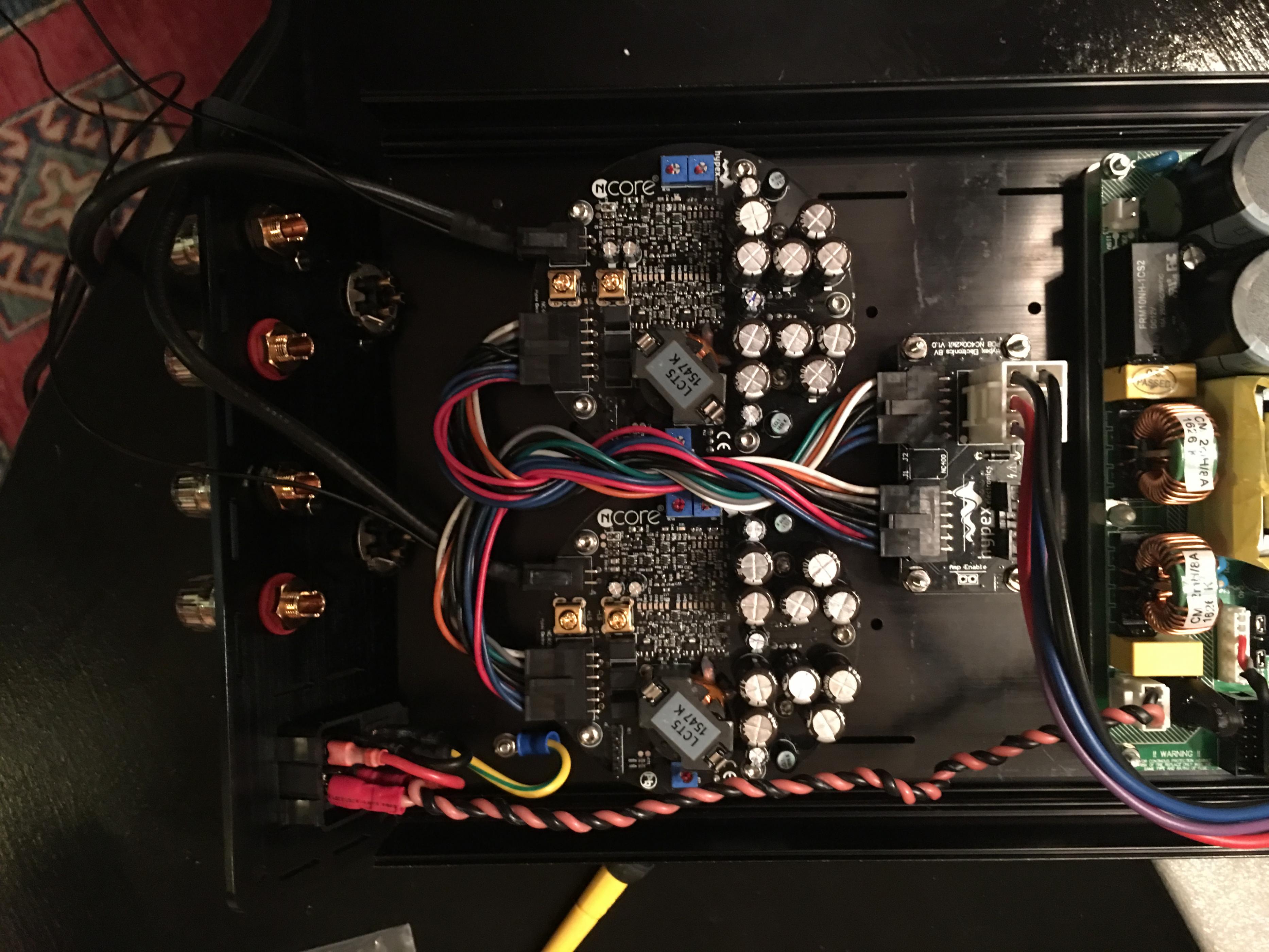

Ncore layout question
Apologies if this had already covered (this is a very long thread!), but I'm looking for some layout advice for my stereo NCore build. I bought a case from Ghent Audio and a NC400 - SMPMS1200 connection kit from Hypex, in addition to the NCores and power supply. Ghent provided me with a longer case than the usual Ncore stereo offering - but I'm worried that the orientation of the power cables isn't so great. Specifically, I'm worried about the proximity of the cables from the power supply to the inputs/outputs, and the fact that they pretty much have to make contact with the NCores the way things are currently configured. Any thoughts, suggestions, advice welcome.

A wide case would probable have been more ideal doing stereo.
Maybe the best way is to turn each 90 deg so that the nC power connector face each other. This might require some offsetting alongside to accommodate the cables. I would have liked to run the power feeding to them close to that transformer on the board - that means splitting the paths and probably an offset position of the splitting board.
