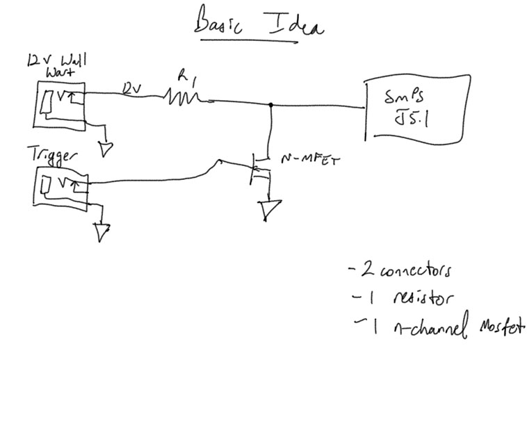

I looked around already for some kits and/or universal versions and found only a few, mostly overprized for what they are supposed to do: 12VDC in at ~ 5mA = Power On. A 12VDC relay version usually draws to much power already for this purpose, because those 12V trigger circuits on preamps etc usually provide only about 125 - 150 mA max for that purpose, which is just about the input current of one 12VDC relay coil. Even the DIY market here doesn't offer anything, at least to my knowledge.
The trigger voltage just needs to take the applied voltage to ground to turn the SMPS on. Surely this is incredibly easy. A couple of resistors and a n-channel logic level FET would do the job - with the 'standby' applied voltage coming from a wall wart or other convenient source. Easily bundled into the enclosure or an external box if desired. What am I missing?
I do find it odd, however, that Hypex deployed an external trigger option which is the opposite of every external trigger I have encountered (i.e. a +ve voltage is required to maintain standby/off for the SMPS rather than turn it on).
You could just solder the necessary parts directly to the connectors (mounted on the rear of your enclosure).
I don't need one, but I don't think it would be hard to make. I only glanced at the SMPS data sheet but the basic idea is attached. When the external trigger voltage goes high it turns on the MOSFET pulling SMPS pin 5.1 to ground and thereby enabling the supply and amp. (Leave nAMPon set such that the amp is on when the supply is on.)
Of course you can make it fancier by building a supply to replace the wall wart but not sure why you would bother.

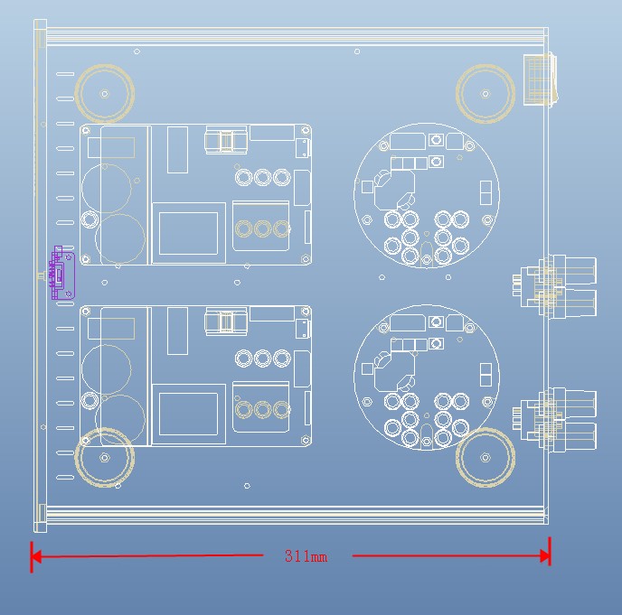

PS.: They are supposed to be working on a new stereo enclosure right now (see attachment), which is 311 mm in length and somewhat wider too. Should be avilable in the "near future" (pricin unknown to me, probably same or similar to the current stereo case). Will fit 2x NCore NC400 and 2x SMPS600 or 1x (?) SMPS1200A400. The new stereo cable kit for the SMPS1200A400 can be fitted too.
I asked Hypex support about that last year, and the reply was that their design goal is to keep stand-by dissipation at minimum.
Well yeah, that's dandy but as long as all other external trigger voltages work the opposite, it means you need another power supply just to keep this one in stand-by. If you don't want a wall wart, I suppose a 9V battery should last a pretty long time.
Yes we looked at options including internal PSU, extra circuitry or external PSU, extra socket for power, extra points of failure extra wall mains sockets. So we opted for a neat tiny self powered self contained opto, Triac solution, small, cheap, ultra quite and reliable. Opto sees a 12V trigger signal and energises the Triac. "Triac Circuit breaker" approach, surely pretty similar to ON/OFF switch?
Quite similar (apart from the semiconductor non-linearity in series with the mains feed, surely a concern for the "pure virgin unobtainium" power cable crowd), but instead of a triac switching power, I guess you could have used the same circuit with a transistor/FET triggering the SMPS standby.
I have a master-slave power strip, where my preamp is the master so it powers on everything else except the power amp. I'm sure it is using a triac to power the slave sockets, and I'm not comfortable with taking loads of current for a pair of large SMPSs via a triac. My power cables are quite ordinary, without any unobtainium involved.
If a triac controlled power switch was compatible with the rest of the SMPS design, wouldn't Hypex have used that?
