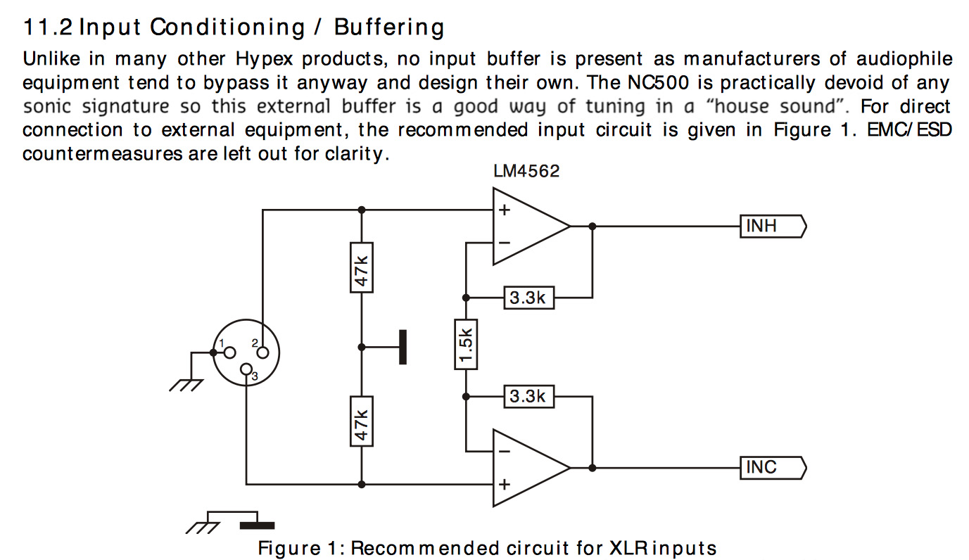

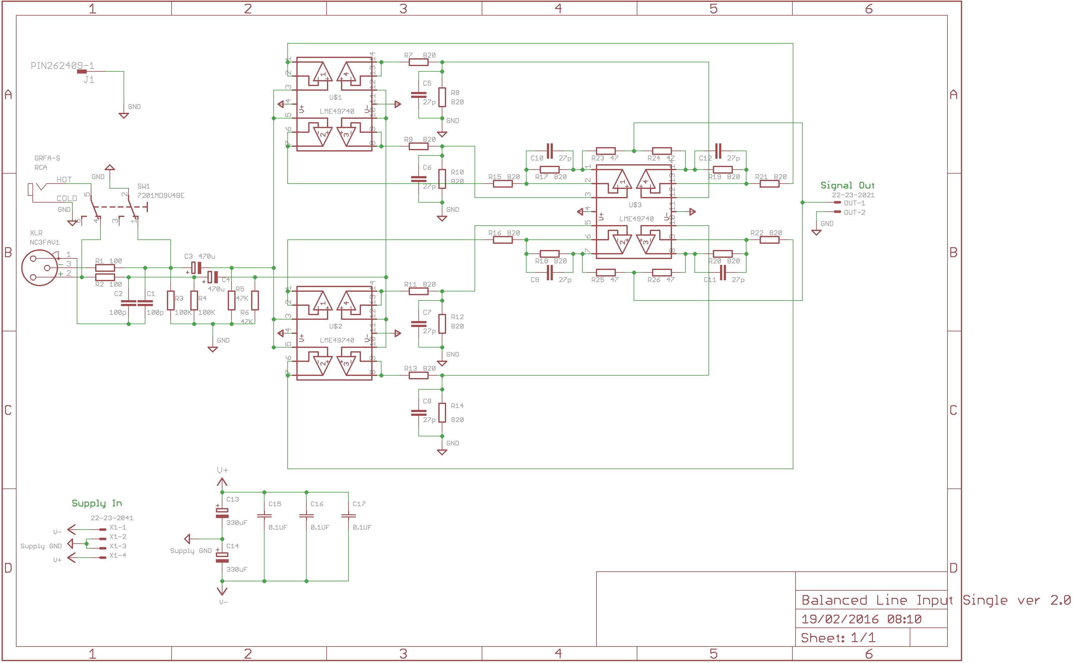

In regards to the discrete Opamps for the Hypex, the best reason I could see needing them in this application is that you can dedicate a lot more silicon to your differential pair transistors and push noise down (done right, that is) than can be readily achieved in a integrated chip. The output of the opamp is pretty lightly loaded.
He was very forthcoming with some additional values to the Input board. He has a broadcast company use them in the same application.
"Hypex's implimentation of there balanced buffer circuit has 4.7M resistor to ground on the input side of the opamp and there is no high frequency rolloff in the feedback path. This resistors Johnson noise becomes the dominant noise source and is slightly audible here in our lab setup using the NC500 buffer board. As our opamps are extremely wideband and fast, we have found that making the 4.7M a 10k to 47K will drop the noise floor about 36-30dB. We and several of our customers have contacted Hypex regarding this and they may of changed this input circuit by now. So just a technical heads up"
The other bit I don't get about this comment is that the 47K resistors aren't in the signal path. It's the noise of the 3.3K and 1.5K resistors that matter. And it is here that the discussion in Self's Small Signal Audio Design (2nd Ed.) may prove very useful (particularly the discussion from pg 527 onward). The challenge is to be able to lower the resistor values while still presenting a good input impedance to the source. Self describes the use of buffering the input with voltage-followers and doing so with multiple buffers to take advantage of RMS addition of uncorrelated noise sources. I am deploying his advice in a balanced input circuit to feed a single-ended IPS/VAS of an existing and extremely good amplifier design by DIYAudio member "astx". I attach the circuit in this application. To my mind, this would be a far more fruitful endeavour than randomly swapping out the LM4562 for noisier discrete alternatives.
Is there a way to wire NC500 so that I can select between a NC500 adapter buffer and a external buffer?
