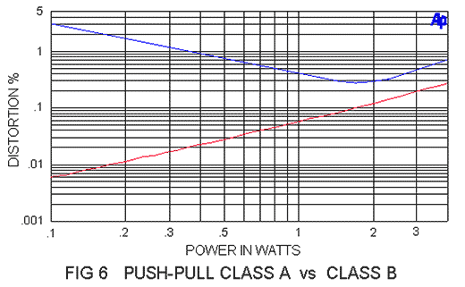

The THD+N graph of NC400 and about every class AB amplifier reminded me of Nelson Pass' comparison of class A and class B:
Here we see distortion profiles of class A (red curve) and class B (blue curve) without N; I had the class B graph in mind which shows rising distortion at low level (crossover artifacts), but realize that THD and THD+N graphs are not comparable.
With N involved the class A graph will look much more like class AB and D graphs.
Here we see distortion profiles of class A (red curve) and class B (blue curve) without N; I had the class B graph in mind which show rising distortion at low level (crossover artifacts), but realize that THD and THD+N graphs are not comparable.
Class B is very different from even class A/B. Yes, class B suffers from increasing (relative) distortion at lower power levels - pretty much a structural problem with class B. But that does not apply to even class A/B, not to mention class A and D.
