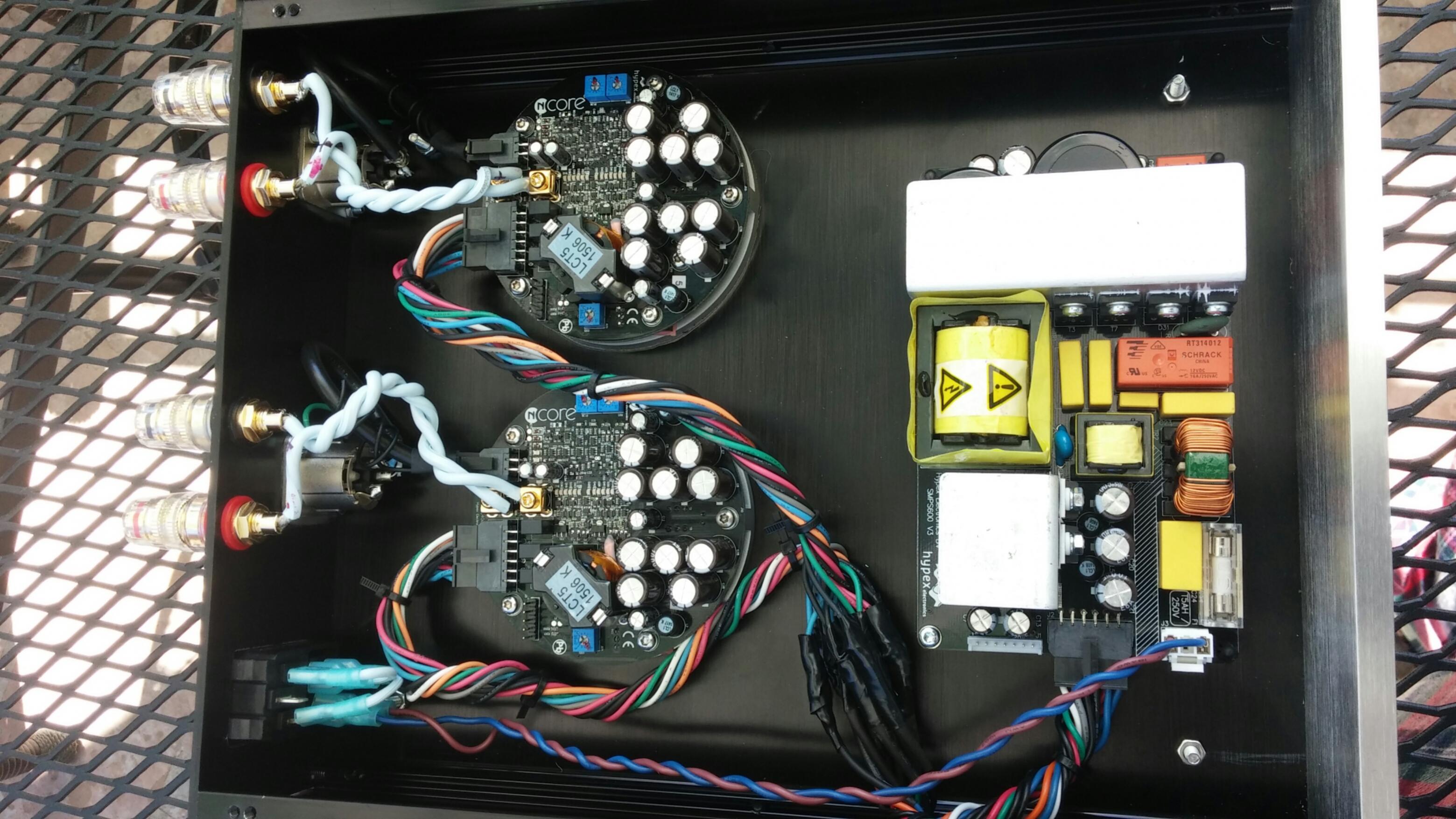

here is the first of 2 nc400 amps and 2 ucd400 amps under construction.
Havent powered it up.
Please suggest some basic tests to avoid sending it up in smoke as i power them on.
