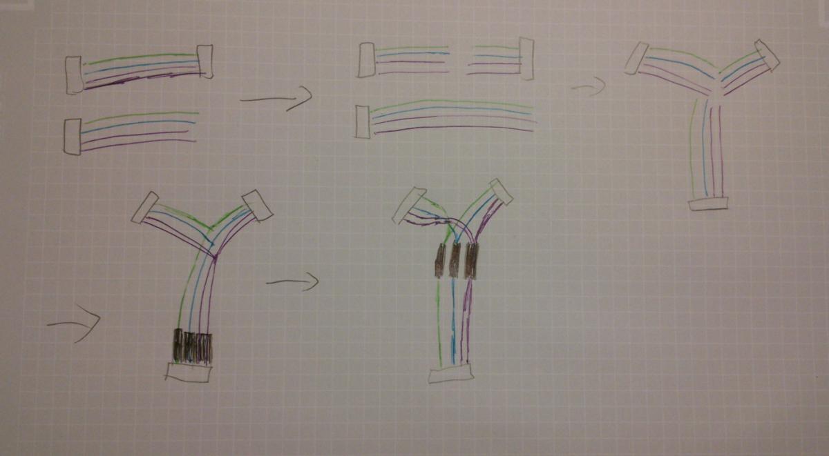

I am going to use SMPS600 driving two NC400.
Could you tell me how you spliced a Y cable to connect the single SMPS to two nc400 modules? It could be trivial, but some visual example will help me do it well.
It will be much easier for an SMPS600, its just a 1:1 splice. Simply strip off some insulation of the end-to-end cable that came with the SMPS600 and attach another cable (came with the NC400's) to each of the wires and solder to that. Remove each wire one by one from the plug to heatshrink.
You get one normal cable and then a cable with connector only on one end. Just split the complete cable in two, sort all individual cables by color, apply head shrink tubes and then solder together and lastly heat the shrink tubes and you are done =)

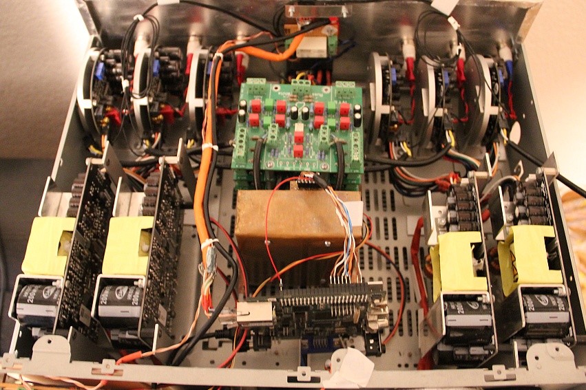

Hi All,
I'm almost done building my nc400 based amp, but struggling to identify the source of some noise at amp output.
The amp is a single-chassis combination of a dsp board running an active crossover, a multichannel dac and 6 channels of smps600+nc400 combo.
It runs and sounds good, but when I'm listening very close, a few cm from the driver a periodic noise can be heard on all channels.
I tried to identify the source of noise, but could not manage to find it out.
I made recordings of the dac output with my sound card, and there it seems to be pretty clear, down to around -118db. Normalizing the recording (~88db), the noise seems to be a white noise with no evident periodic patterns. (Recording was done with an emu 1820m, it should be pretty much free of any sound card artifacts).
However, at the same time I also recorded directly the loudspeaker output. That's around -69db at level, but when normalized to 0db, one can clearly hear a periodic pattern. It's roughly every 50ms.
I attached the two audio files recorded, probably somebody has some hints what this can be.
Thanks in advance,
igy
I forgot to mention, that there's no volume control, the dac output is directly connected to the amp, and volume control is done with digital attenuation. The noise on the amp output is independent of the digital volume and stays always at the same loudness. I verified using logic analyzer, that there's no junk data at the dac input from the dsp, the i2s lines are totally silent (0). The DAC is galvanically isolated from the DSP using Si8660 digital isolators.
Attached is a pic of the amp, though it's a bit unclean due to recent "debugging" session...
