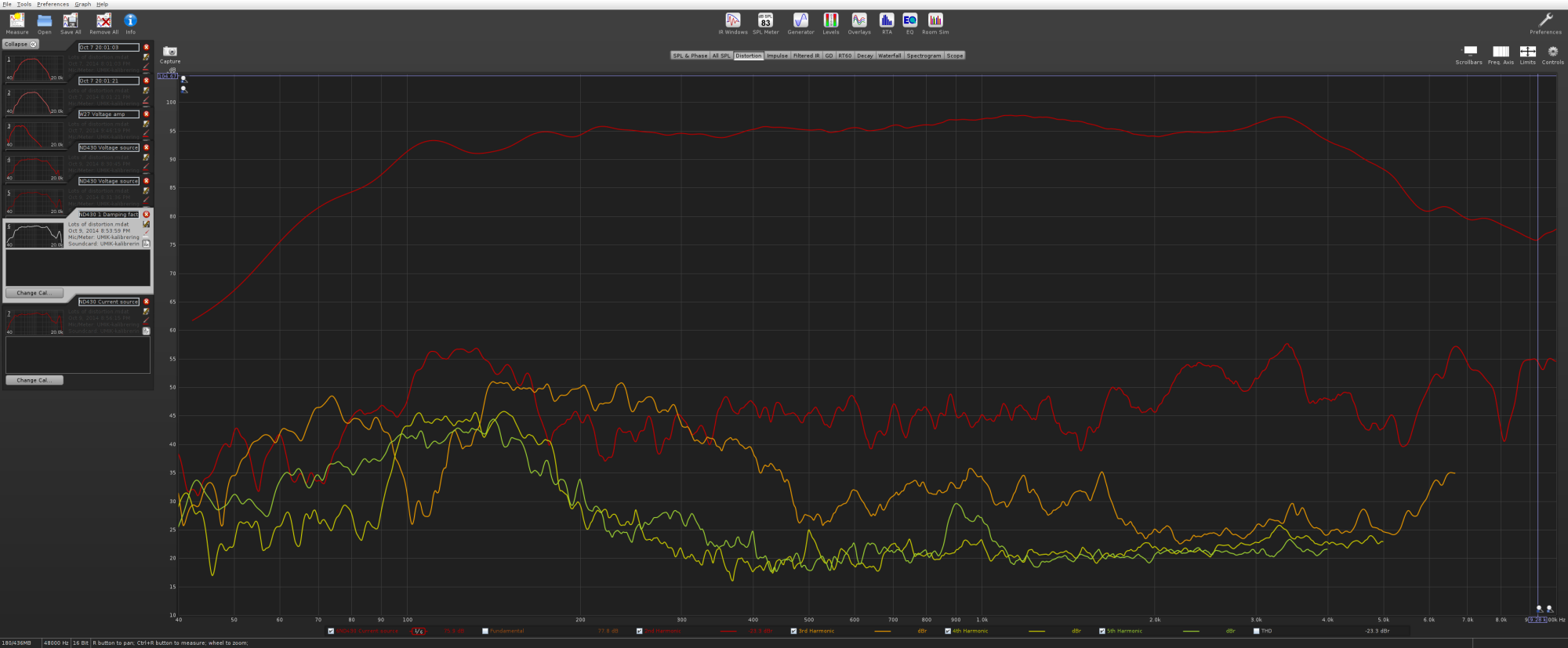

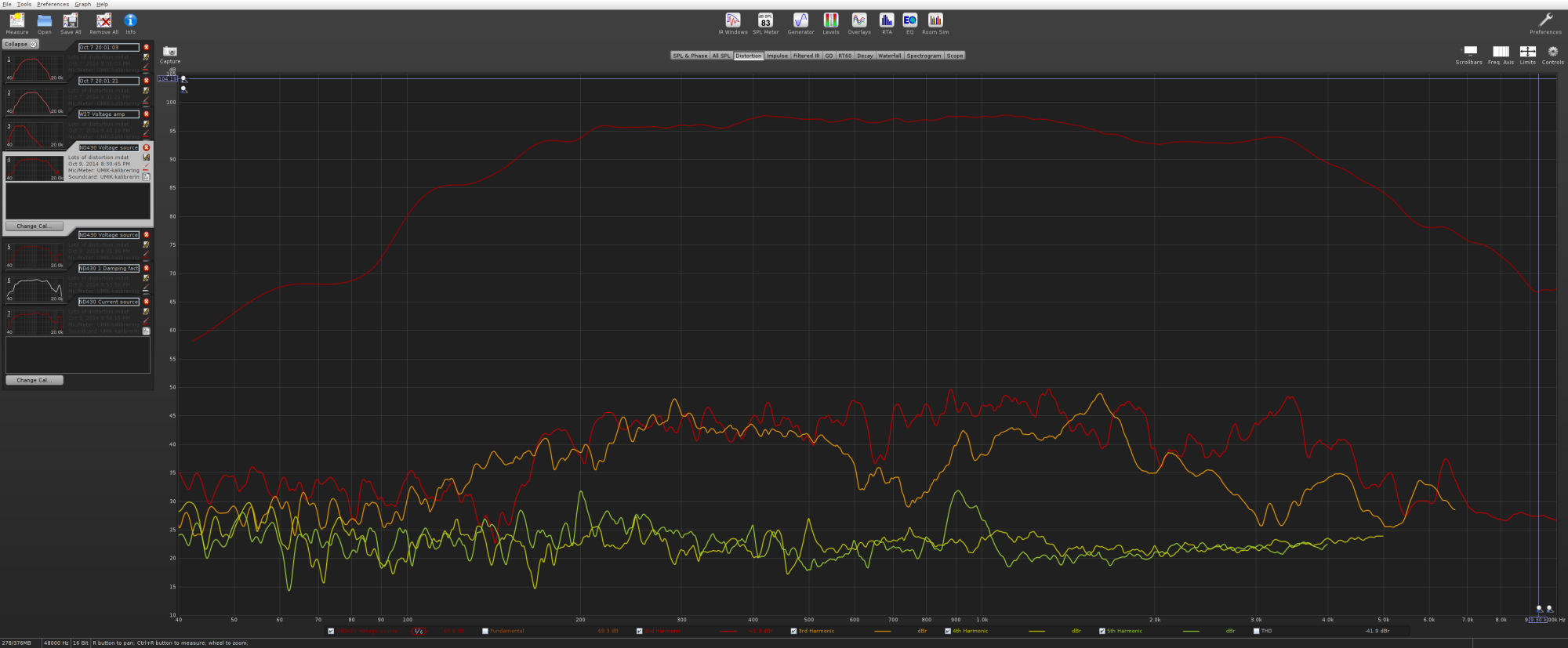

Now that I have home I can share some:

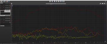

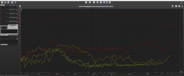

The first is the NCore on an average driver (Monacor SPH-170, 6" bassmid ), no fancy driver here with massive shorting rings:
The second is NCore + 8 ohm in series, the third with 35 ohm in series.
The fourth is the same driver but with a F2J with ~ 700 ohm output impedance.

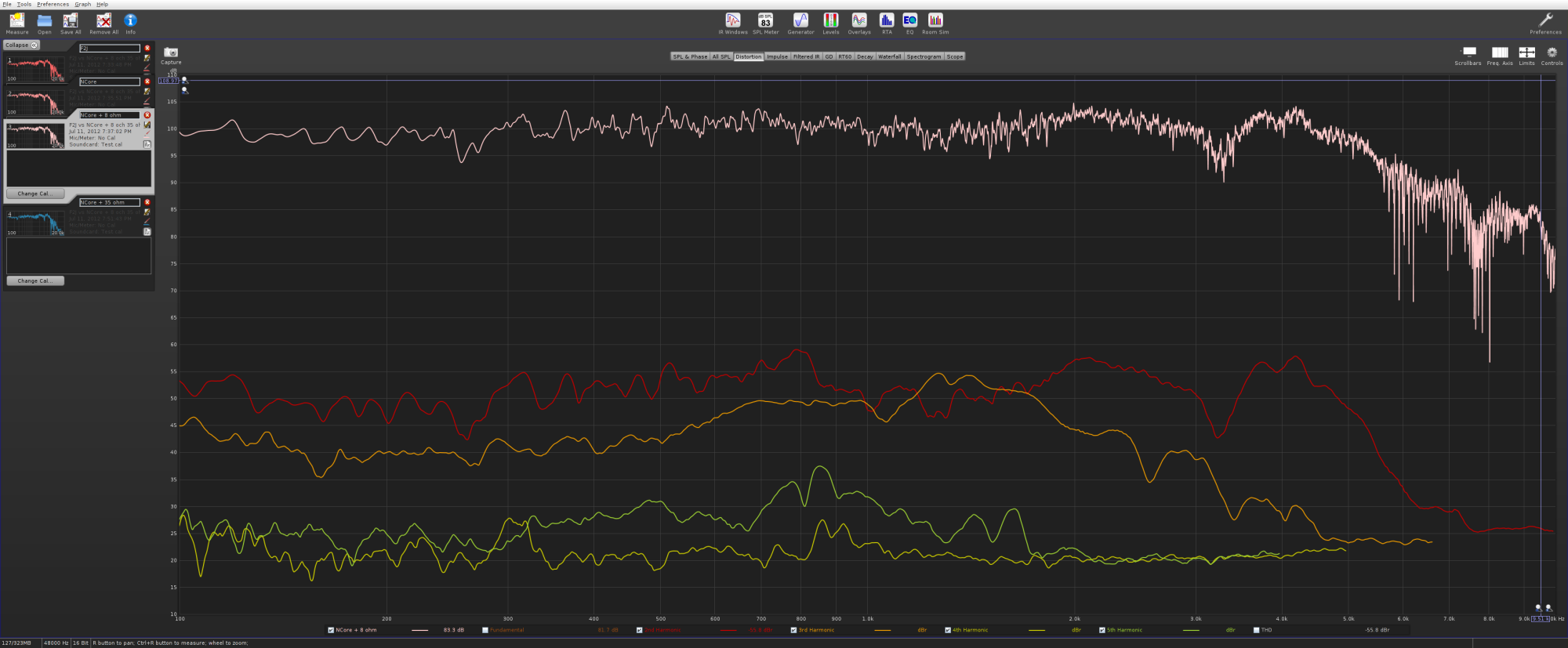

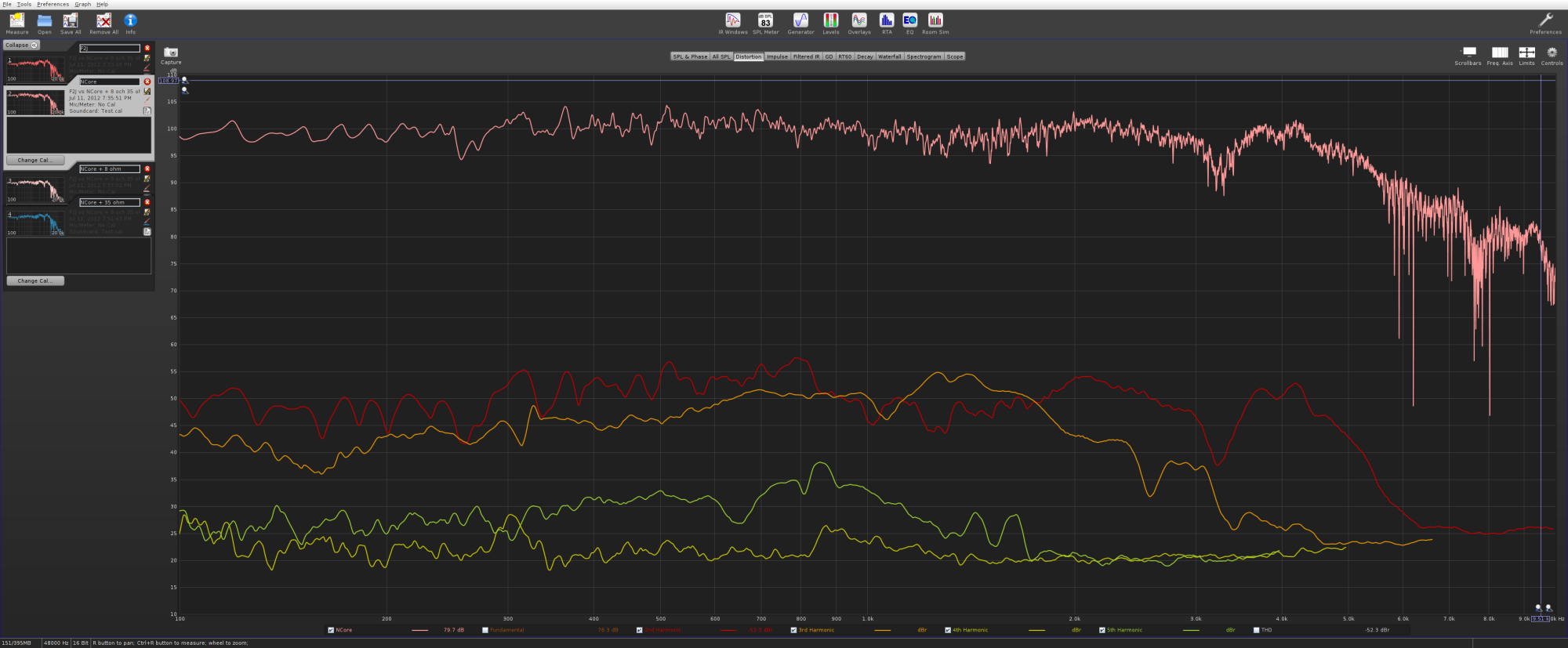

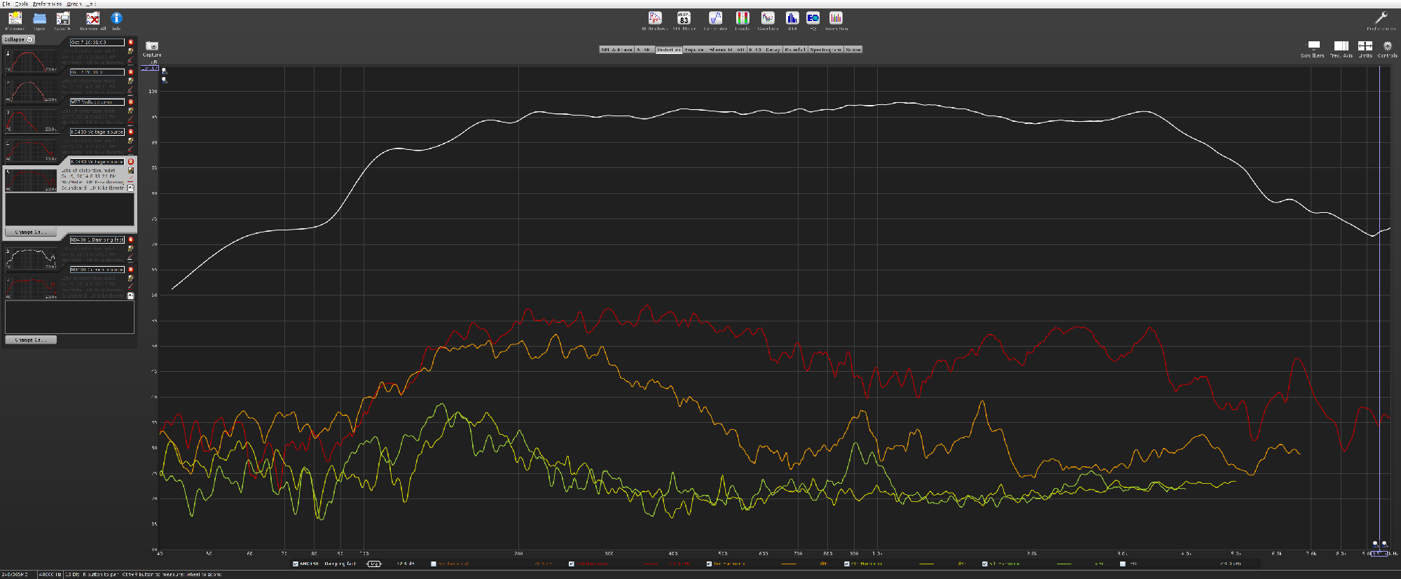

Here is with a driver that does have massive shorting rings, the TD6M:
First up is NCore, second up is the F2J: The difference is not there in this driver, if anything the NCore has slightly less distortion but most importantly the driver doesn't perform much better with current source than with a voltage one. The copper does eat a lot of efficiency though.

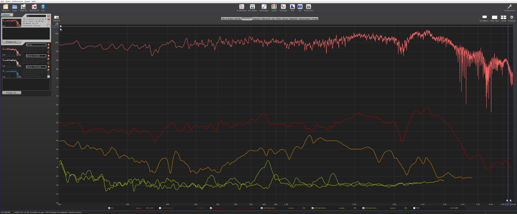

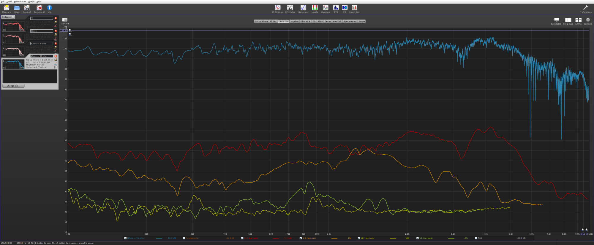

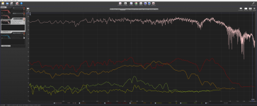

So for fun I also have 6x 6ND430 in an OB, far far more efficient than the TD6M as they have no shorting rings although they have very low distortion anyway. The result is the same, current source makes the driver go from having low distortion to stupid low distortion (above fs of course, this driver will not be used below 300 hz 🙂): The amp here is not a NCore though but another voltage source amp I had lying around close by.
EDIT: The first four measurements I'm not sure exactly what the SPL is but it is same for all measurements, same for the 2 following: 100 dB there is not actually 100 dB but same scale on both. On the last I calibrated it so 95 dB there is 95 dB / 1 m.

very interesting, thank you OllBoll.
I really like the evolution in the first 4 graphs: 0ohms, 8ohms, 35ohms, 700ohms.
I did not expect so much difference between the 35ohms and the 700ohms versions.

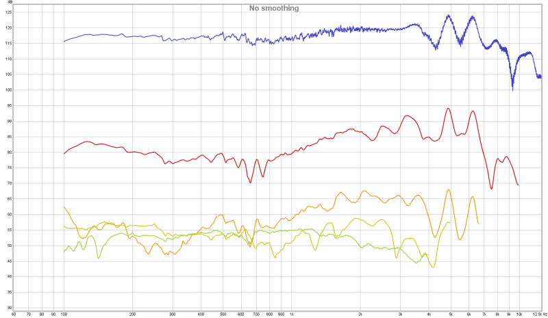

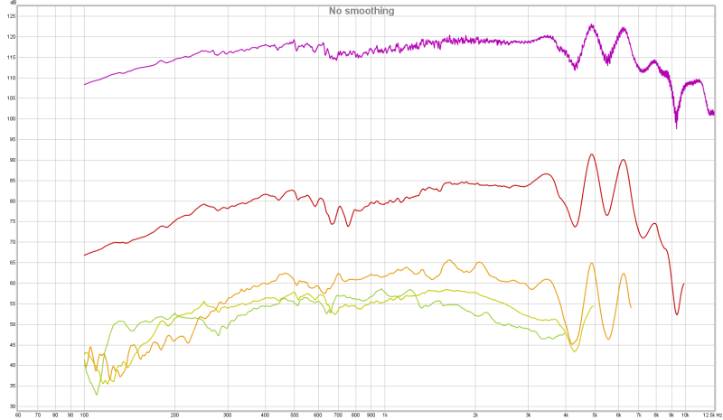

Yup, it looks to be very driver dependant. Here we have the 2x 6ND430s with 16 ohm in parallel with the current source amplifier to get 1 damping factor:
2nd and 3rd harmonics skyrocket on the low end but the distortion is otherwise a mix between voltage and current source, the high end distortion is almost as good as the current source. This driver would probably be fine with less output impedance than 700 to perform well than the other one.
