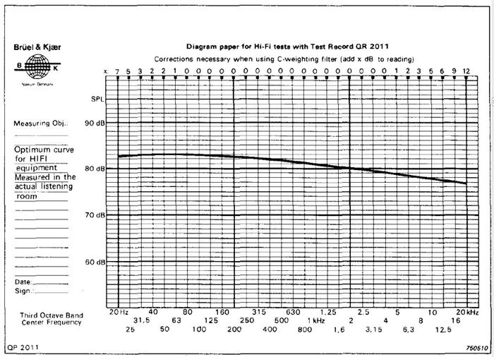

Off-topic, but Bruel & Kjær studies on frequency response tells us that a flat response isn't necessarliy neutral and correct in tonality.I have worked in studios for years, primarily with ATC and PMC active monitoring systems. They are as close to 'flat' as the designers could get at the time and they don't sound great for home listening. Too revealing and to 'cold' sounding for hifi lovers is generally the feedback we get from clients, but nonetheless they are great for doing 'forensic' audio work, as proven by the results we get.
When music is recorded under far-field conditions, it will contain a suitable mixture of direct and reflected sound, and the curve ought to be absolutely flat in that case. This is true for recordings, for instance, made with two B &K condenser microphones in the far-field.
However, since most recordings are made as a combination of near-field and far-field information, the curve should boost a little at low frequencies and roll off a little at high frequencies. A suitably shaped curve is shown in Fig.5.
The curve shows only the necessary tendencies. This curve was derived partly as a result of listening tests and partly by consideration of
curves from average concert halls. According to Beranek (Ref. 2) the average concert hall has a roll off similar to that in the curve shown, but at twice the rate. Only half the rate is chosen because most recordings are equally distributed between near-field and far-field recording.
Pratice has shown that this characteristic is absolutely reasonable for reproduction of most commercial recordings.
Indeed, that curve is pretty well-known (and mostly acknowledged to be correct). The problem is the issue of where the roll off happens. What you want is the smooth roll-off applied to the end result of the whole chain (including the room), so the amp is probably not the best place to accomplish it. An extra challenge is the fact that some recording engineers already apply that curve at the mastering stage...

The soft, smooth B&K slope doesn't require very sophisticated EQ - good old tone controls are actually pretty good for that.

That graph above is for measuring dB with a C weighting, A & B also exist and we (as in the people i work with) usually use A for measurements concerning music. There are too many factors at play here, and quoting stuff like this doesn't prove anything.
