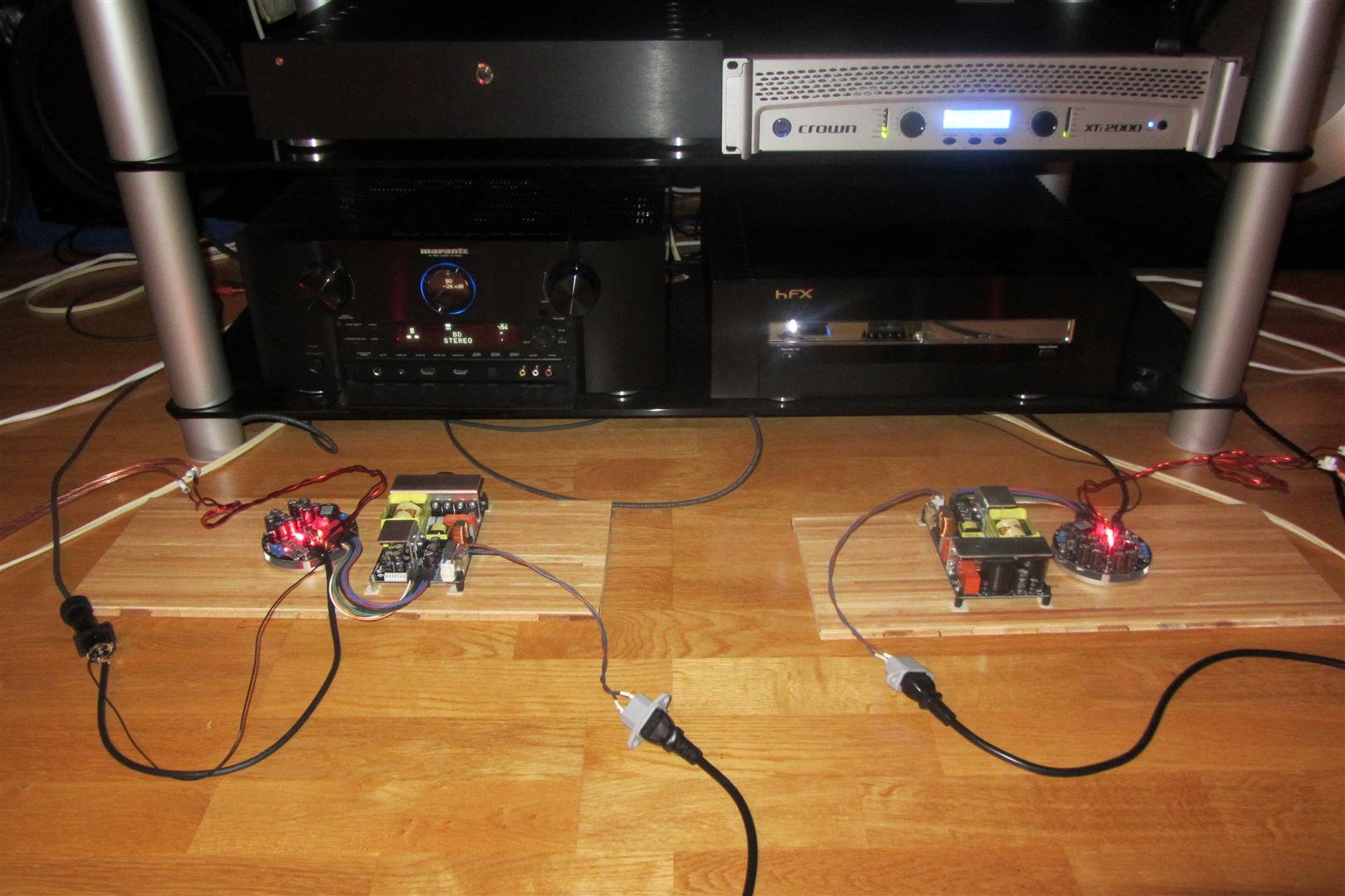

i made some measurements myself and the results are puzzling me: same room, same speakers, same position, same levels, same microphone - only the amps change. Some amps show low distortion values (0.2-0.4%) over the whole mid+high range, others show high values (2.0-3.8%). Of course the amps measured by them selfs show all values under 0.01%.
What could be the cause for this behaviour?

I measured it =)
The F2J has a lot 2nd order distortion though so if the NCore with it's less distortion would be a current source that one would be as low as with the vanilla NCore.
If I've understood correctly a current source can compensate for nonlinearities in the motor, more specifically BL and inductance if I remember correctly which is a major cause of distortion unless you buy very expensive drivers with very well built motors. ( Like for example AE lambda drivers where the performance on those is so good already the difference is marginal )

The big difference was when I tested with a current source F2J where the F2J hadily beats the NCore in actual speaker distortion so I decided to go that route instead. Since I'm building my speaker myself using a current source amp isn't a problem and yields big advantages.
look at my measurements. The higher distortion amp is a current source amp ... that behaves quite different that yours.
I wouldn't jump to your conclusion that fast.

I also did testings with a series resistor on the NCore and the bigger resistor the closer did the NCore performance get to the pure current source F2J. It's not really practical to put a 100+ ohm resistor in series with your speaker though.
well, i don't doubt your findings, but other (current source) amps and/or other speakers would maybe behave differently.
