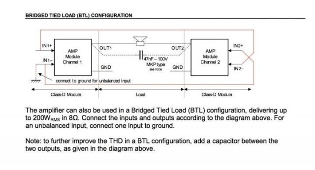

I am interested in building my own amps with ncore 400. Have seen there are some amps that are bridged with two modules together. Is there any wiring diagram how to wire two modules in a brided monoblock? Do they need their own power supply or is it possible to connect two nc400 to one supply?

Why do you want to bridge the amplifiers? If it is for more power, you would probably want separate power supplies - sharing one supply limits the total power (as the power has to come from somewhere).
I have read some users saying bridged modules was better. Why bridged, these modules is pretty cheap in compare to many factory amps so if i belive i get a few % better amp it may be worth the extra money. Sorry for not reading all the 600+pages here but if someone have an wiring diagram to share i be happy.
I may start with a single NC400 module/monoblock see how it´s working but interested to add the extra module later.
One qoestion more, any running them with an DAC with volumecontrol? No preamp? In case i build i run them trough an DAC with volyme.
A couple of people seem to feel that they sound slightly better when bridged, others disagree. Nobody seems to have done any proper, controlled and level-matched double-blind listening, so no objective evidence this way or that.
My suggestion is to start out with one, and see how you like it - and only start thinking about things like bridging if you are not happy with the sound. If you go down that route, you'd better figure out what you are not happy with, and try to address those issues specifically, and verify each step with proper double-blind listening tests, otherwise you most likely end up wasting money or even making the sound worse.

On bridging:
Wiring bridged ncore is basically to connect two ncores to either one or two PS. Then using only the "hot" speaker connections of both ncores while connecting the signal inversely to them. The idea is that they mirror each other so the signal appears amplified across the two "hot" terminals. A detail is that the "cold" terminal also should be connected through a small cap -can't remember the recommended value, but the amp should "work" without though better with...
Buy either 2xncore + one or two amps 600 or one smps1200 63V version.
Love that and buy another pair of ncores and another 1-3 smps600 or one smps 1200. That should work just fine. ncores will dissipate more heat if not using the smsp600 unless you roll your own driver supply...

Connection diagram for bridging ucd, the same is valid for nCore.
150nf cap was recommended for ncore by Bruno in this thread a long time ago.
We have compared my bridge ones against my friends standard build. He is now going bridged as well.
The impedance the amplifier sees is halved when bridging, that you need to consider as well.

One theoretical pro for bridging is that noise from the power supply is cancelled out, if the same PS is used for the two bridged amplifiers.
Some theoretical pros for bi-amping is higher damping factor, and that lower impedance speakers can be used.
