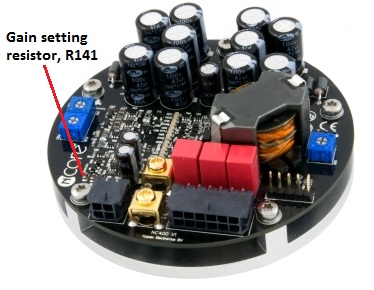

Could anyone be kind enough to circle the R141 on a picture taken of the module. I am still too scared of getting rough with the modules, but that kind of picture might help me getting over the mental barrier. I would like to try the modules with lower gain since i am only using a small fraction of the power it offers and the DAC has 4.5V balanced output. Any negative experiences (but the module getting broken) from lowering the gain?
from the pdf:
R141, the resistor furthest to the left of the input connector.
and an illustration:

I didn't have any problems either with removing R141, just make sure you save the resistors in case you wish to reverse the change. I put them in one of the small plastic bags the screws came in and duct taped them to the side inside the chassi.
I was especially glad I did that since I have put R141 back in preparation for switching to more power hungry and inefficient drivers. Wasn't the easiest soldering I've done but it went all right 😀
