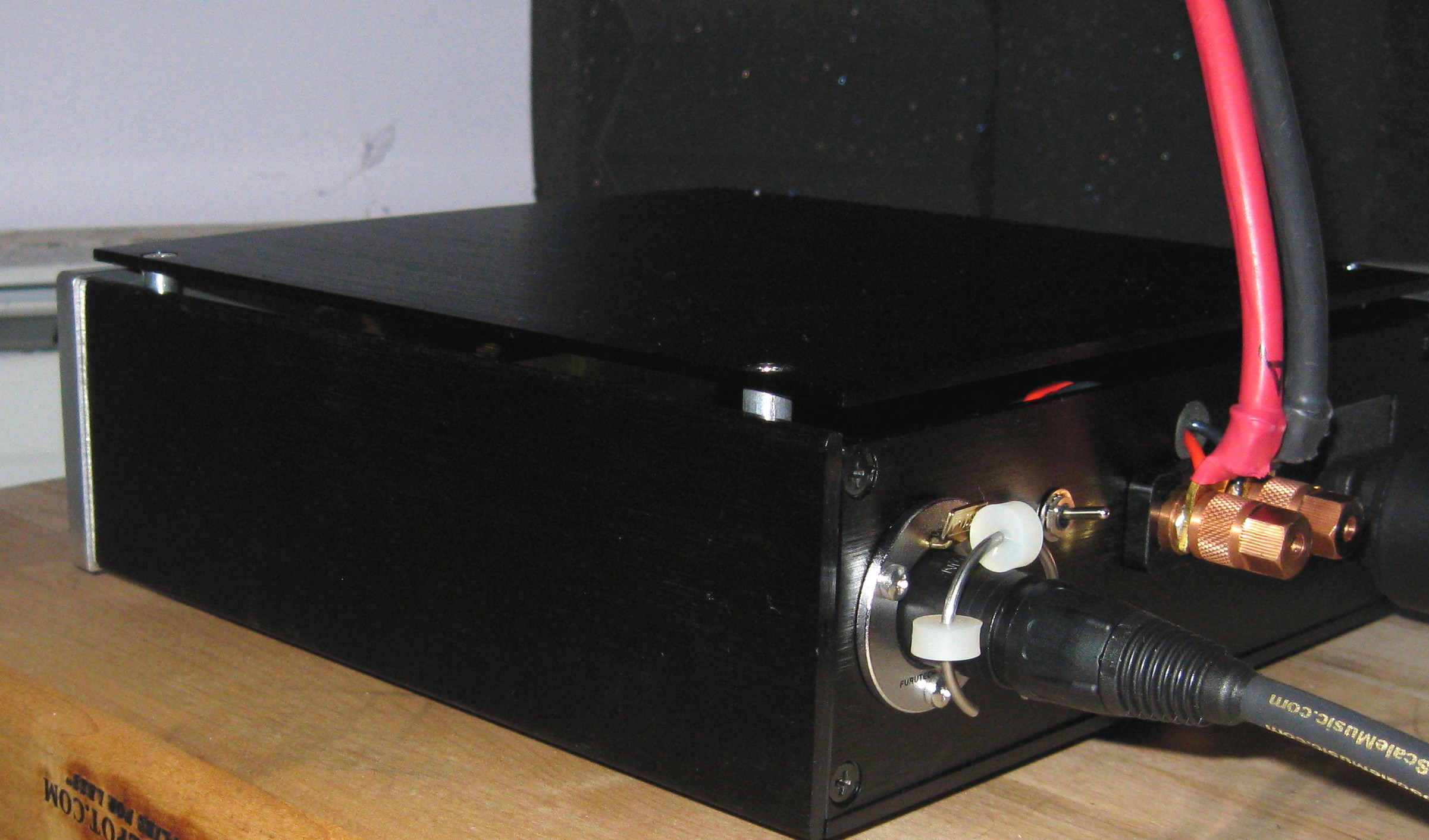

I checked the temps on the SMPS large heat sink with the temp probe on my DMM and found it to be 20F cooler with the top off. Now, even though the temp was well within the limits of operation, I thought I would like some venting just to attempt to prolong life of electrolytic caps. I installed four aluminum standoffs to vent the top all around the edges.

Chris,
Nice solution and easy to test the effect without drilling holes in my nice black case tops.
Tom
Is it safe to put the heat sinks of the SMPS to ground (ie touching the chassi) ?
Yes, that's the whole point
The instructions in the data sheet are pretty clear on this.
The SMPS is class 2 (IIRC) and requires at least 6mm air space around the live areas - as indicated in the diagram in the data sheet. The 6mm spacing is inherently provided underneath by the standoffs
It's all designed to be class 2 so there's no need to fuss.
- bolt the amp to the case
- bolt the smps to the case using the standoffs - one of which is conductive for improved emi
- ensure 6mm clearance everywhere else
- connect as recommended in the data sheet (no mains earth)
- for a single module, don't worry about ventilation
- sit back and enjoy
I´m just in the process of building a pair of cases for my NCores and also encountered some problems with too much heat.
One amp plus smps produce around 14,5 watt of heat (measured the consumption at idle). I put them in 100 x 60 x 250mm cases (one for the amp, one for the power supply) with a little ventilation but they keep turning off after 2 or 3 hours of use with very efficient 12 ohm loudspeakers.
It´s the smps getting too hot.
Drilling some holes in the case (one 50mm on top, one at the bottom) helps to keep them from switching off but the little heatsinks still get quite hot.

Just so I get this right - correct me wherever I am wrong.
If I do not ensure 6mm clearance on the top of the SMPS by clamping its heat sinks directly to a case panel, I am in direct violation of class 2 rules unless I implement the alternative, which is 0.5mm of insulation material, IMHO.
I was not talking about anything else there, as the need for additional heat transfer seems subjective depending on what exact case is applied. Hence, "no need to fuss" -- as long as things remain reasonably cool, and the clearance is achieved by the steps you outlined. If I am completely paranoid about thermal issues, and my resulting implementation goes against the principles of class 2, I am supposed to either check how I can get back in line, or go for a class 1 setup altogether - or so I thought.
yes it´s a class 1 setup. The problem is not about being completely paranoid but of a smps switching off because it get´s too hot. The space inside the case is rather cramped with only 52mm height and 92mm width.
I will try some ventilation holes directly above the heatsinks and see what happens before trying to increase the heatsinking.
