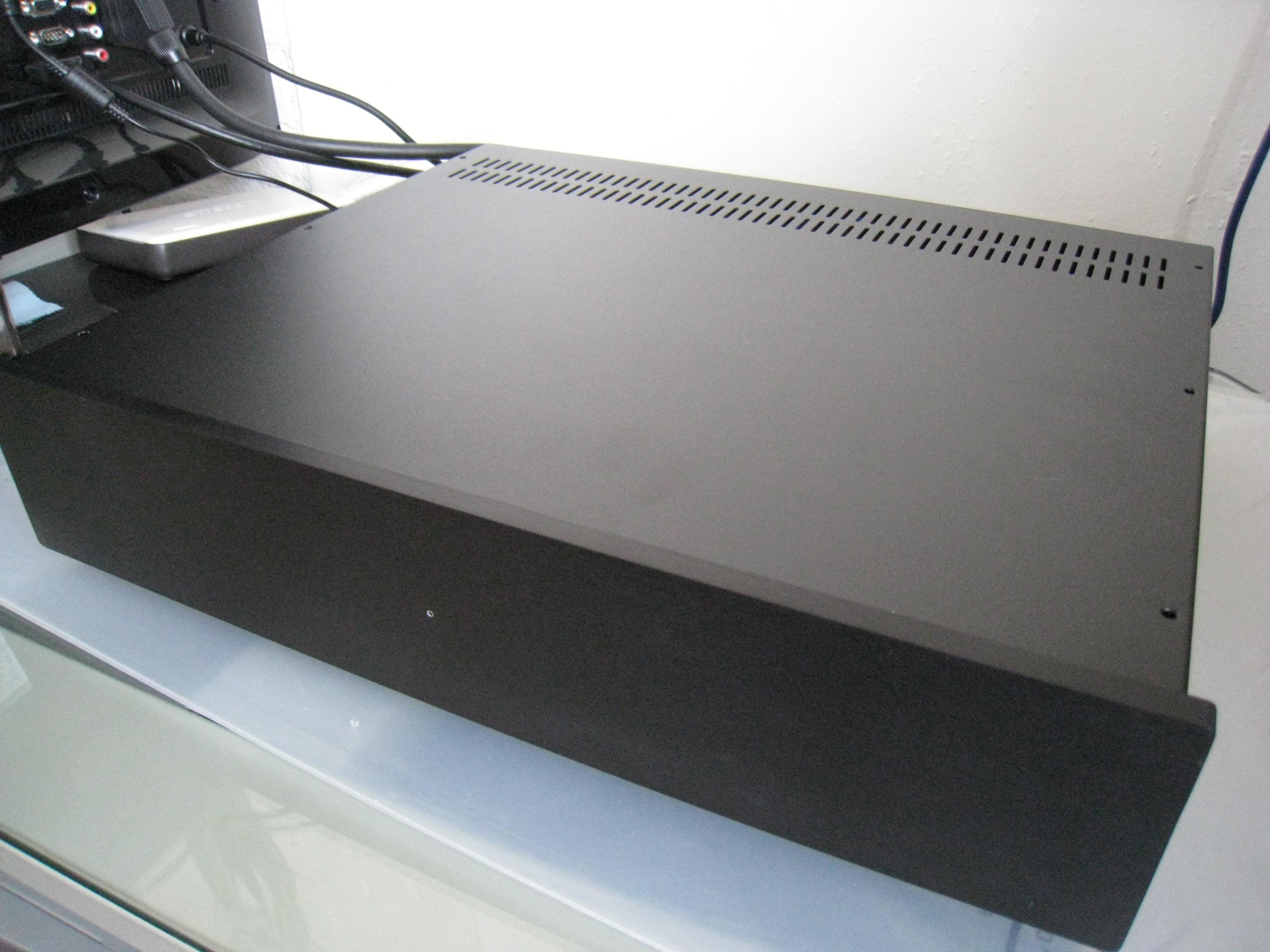

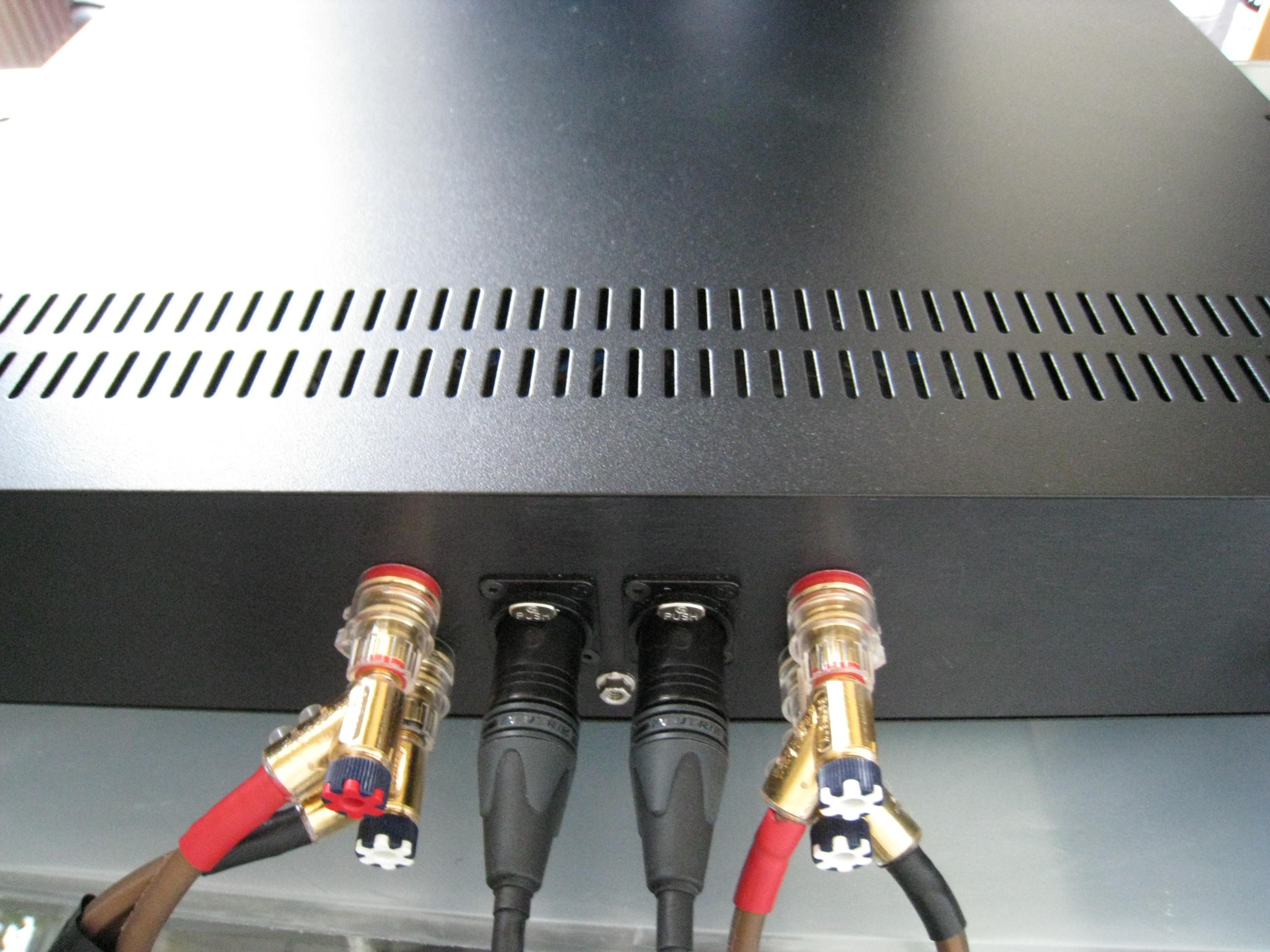

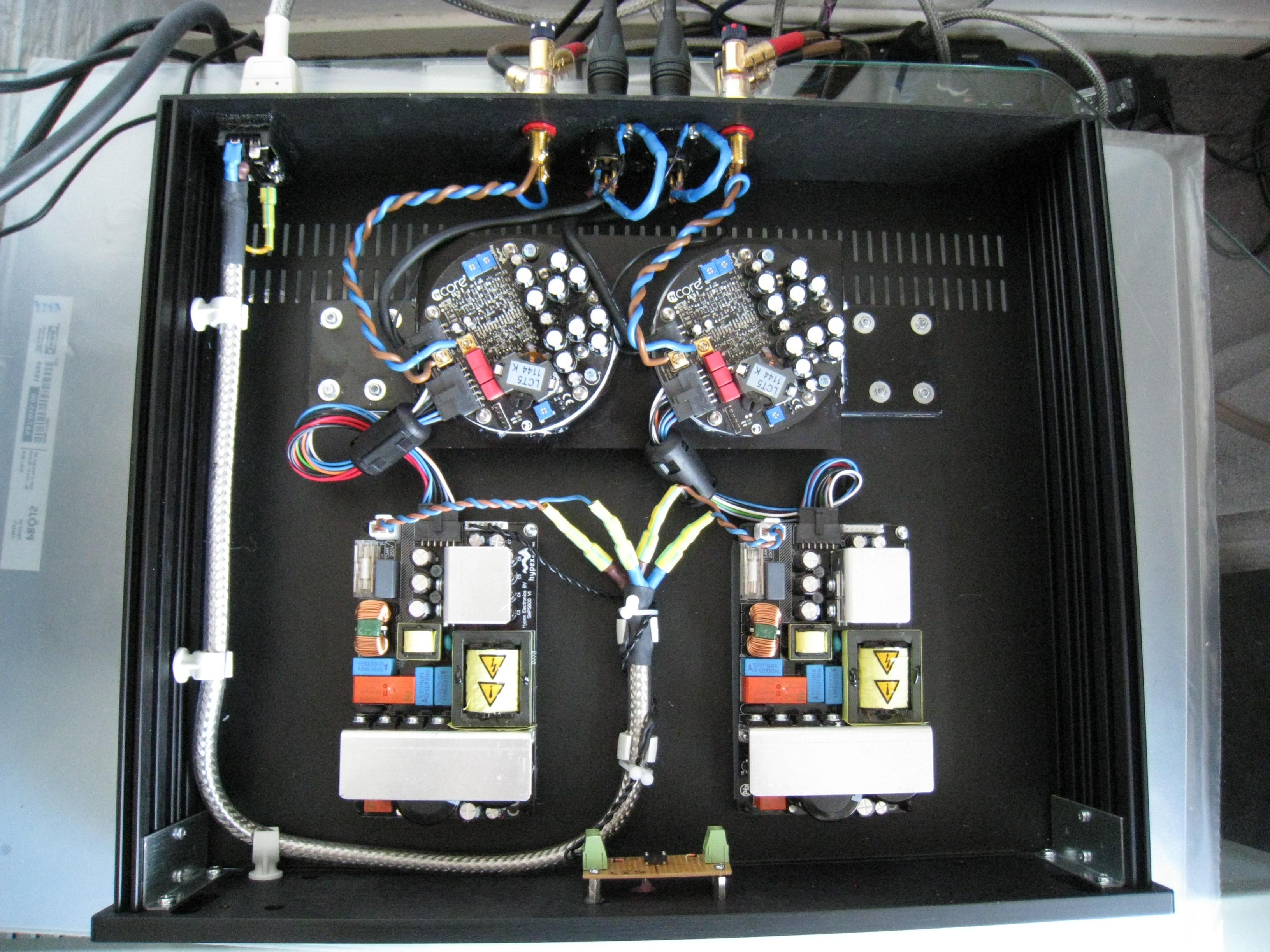

For those who are interested. Here are some pictures of my stereo power amp. The internal speaker wires are going to be replaced with "Van den Hul SCS-12" as soon a I receive that cable. There are still no feet mounted, the postman still has them...
I'm also not to happy about the LED circuit at the front plate. I'll have to design another circuit for this because the resisters are dissipating to much power in my opinion and therefor get a bit to hot. I used 2W resistors, they can have it but still... Perhaps it is a good idea to use a voltage regulator. Any other suggestions are welcome.

Thanks for the clear photos. How does it sound?
The mid and high frequency range sound great and the low frequencies are OK too. It is a bit cliche, but it is a very transparent amplifier. With this you will hear everything. At first I found it to be a little bit exhausting that everything can be heard, but I think that I got used to it now. My other power amp is a Linn 2100. This is also a great amp, so I used this for comparison. The Linn tends to sound a bit more laid back then the Ncores, and I can not decide yet which one I like more. I think that my Linn has some more control over the lower frequencies and the Ncores have more control in the mid and high range.
