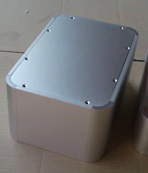

I've been in contact with the friendly people over at SiliconRay regarding an enclosure for NCore.
They have agreed to produce a custom run of a smaller RE3222-style chassis, if we manage to get a small batch (15-20 enclosures) ordered.
I'll probably grab ~ half of those (for me and friends), so there are a few missing to reach the quota- the more the merrier of course since the batch hasn't been ordered yet. Please do let me know of potential interest so I can... put more pressure on the SiliconRay staff. 😀
Factory reports a lead time of 3 weeks which I believe is acceptable (they'll begin shipping more or less around the same time as the next batch of Ncores).

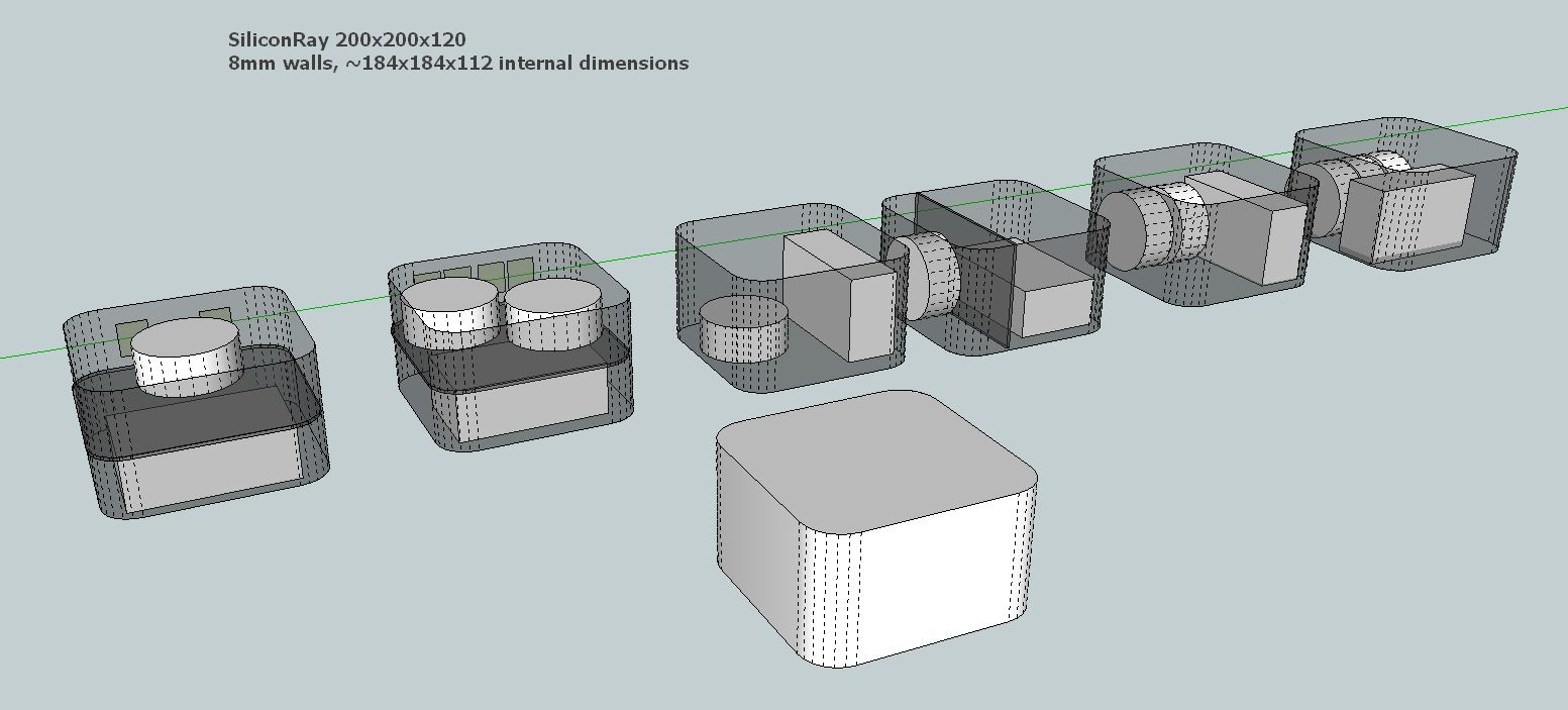

The enclosure will be 200x200x120, side panels 8mm (!) thick and top/bottom ones 4mm (so internal dimensions will be ~184x184x112).
Internal panels and brackets will probably be included (still working that out).
The quality looks top notch but they've promised they'll give us more detailed pics soon.

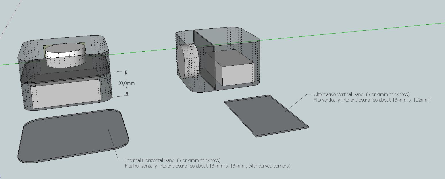

I have attached a few variations I did regarding layouts of NCore+SMPS600 that could fit in said enclosure (using exact dimensions of course) but these are only a reference and, obviously, a subset of possible layouts and uses.
If you look carefully, at the back of the first to variations (from the left) I've sketched standard Neutrik D-Type connectors, just for size reference.

Great work The Shaman,
The chassis model you have found sure does have some pleasing visual and technical attributes and if you can get them to custom make it for specified dimensions as it seems, then I have some questions about your design.
Any particular reason for choosing those dimensions?
- One way or another those dimensions seem to be wasting a lot of air in the enclosure, and if there is something I have learned about the whole "box debate" in here that has already scared most off, it is that the box should not waste "internal air" and thereby be any bigger than needed.
If I may humbly propose (and i may be totally wrong of course...), then why not go for half height (ca. 60mm) and added depth (ca. 300 - 270mm) and maybe somewhat slimmer narrower (120mm) case. This should enable a much more compact case that fits in most racks and shelfs. The SMPS could thereby be placed closed to the front of the case and one ncore (or maybe two, if the case was carefully designed for this and a little wider) to be placed behind and closest to input/output connections.
If you go for a 200mm wide case (still only about 60mm high and slightly deeper), then two SMPS´s should just exactly be able to be placed next to each other making room for two ncores behind them to enable a stereo design or multi channel enclosure (for one multi way active speaker) around only one SMPS.
It seems that there are many like me who are into low profile cases, and with SMPS and switching amps there is actually no technical reason for making a tall enclosure. Unfortunately the expensive SMPS600 is too tall to be mounted in a 1U high enclosure otherwise this box hunting would soon have been settled...
(Bruno), if you should make a revision of the SMPS then please make it as low height as the ncore´s. For me it could take up double the mounting area if it was only of lower height. Also, if I may ask, would it be possible to make a dual/mono kind of SMPS with power reserve for two channels full power and dedicated (separated) power rails. I can´t read anything from the data sheets about this, but why not make completely separated power output rails for each power consuming function to reduce their mutual pollution of each other?

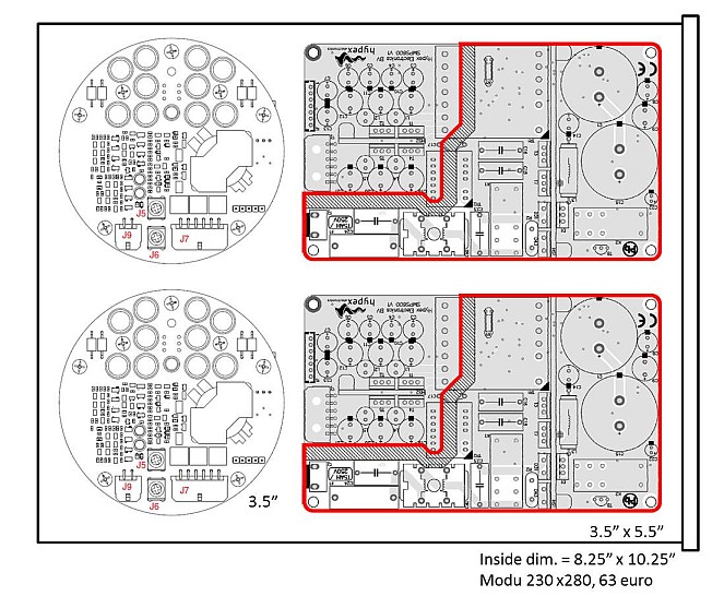

I too have been thinking about enclosures, and for those who want a stereo box and to waste little space, the image shows the approximate layout for the Modu Galaxy Maggiorato 230 x 280 x 80 mm which you can buy from Modu directly or here:

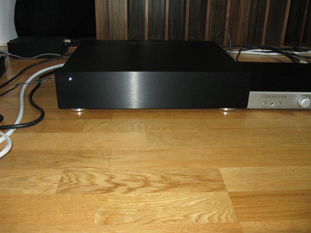

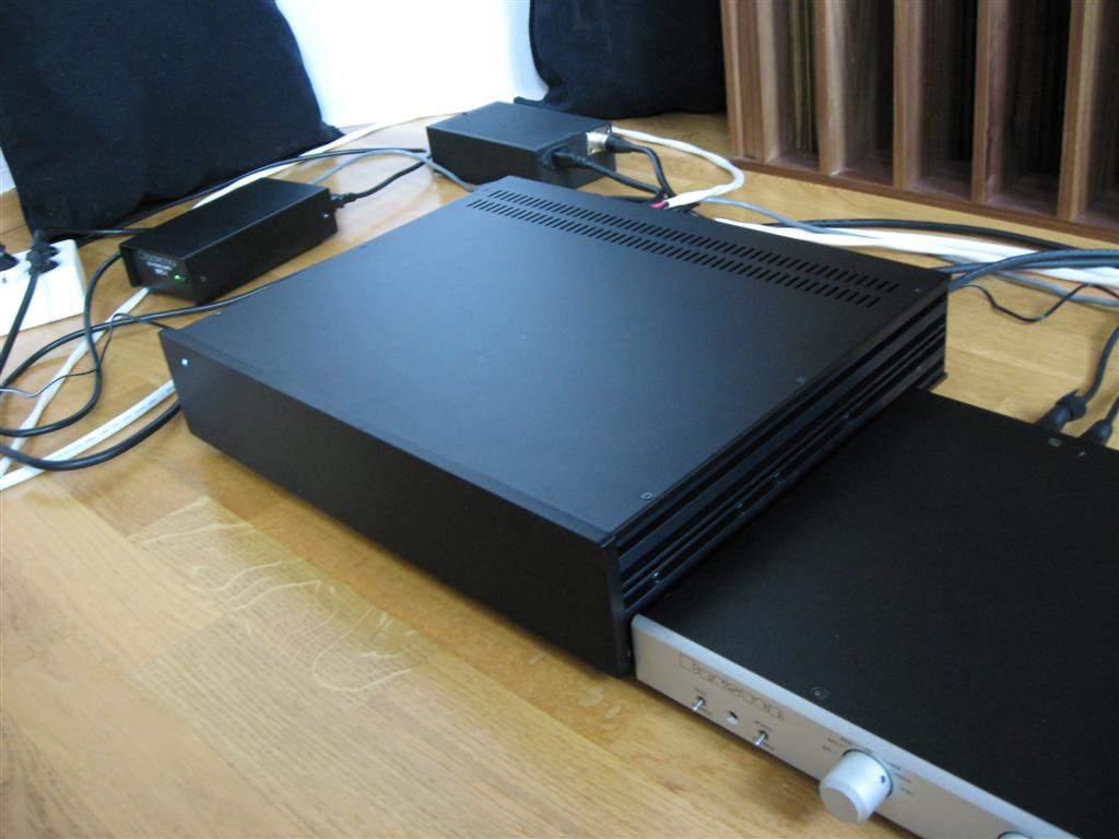

I have a Modushop Slimline case for my UcD modules. Though it looks pretty ok, I personally want something of a bit higher class for Ncore. The front of the Slimline looks good, but the top and sides aren't very classy. But it all depends on the price. I'm not willing to pay anything.I too have been thinking about enclosures, and for those who want a stereo box and to waste little space, the image shows the approximate layout for the Modu Galaxy Maggiorato 230 x 280 x 80 mm which you can buy from Modu directly or here:
Here's some pictures of my Modushop enlosure.
