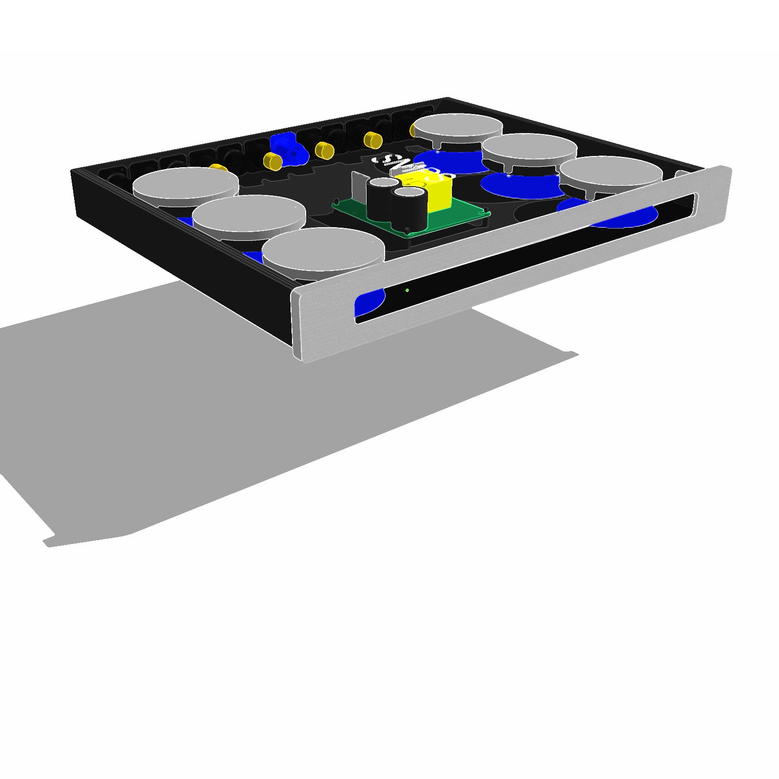

This specific enclosure is too big (300x200x142) for a mono build - a rough sketchup model indicates there is room for a dual mono and then some (i.e. 3 or even more channels, depending on arrangement and SMPSs used).
I've asked for more pictures but build quality looks excellent.
I'm also trying to persuade the vendor to provide us with a smaller enclosure to better suit a monoblock build (180x180x100 or something). 🙂
Thanks. I like this with four large-radius vertical corners. Will it fit 3x NC400 and 3x SMPS600? If yes, I will have local (N. Utah) CNC shop cut the holes, save the plans, and resell if anyone interested.
I like the following idea: Setup/cut a chassis just large enough for 3-ch. If someone wants stereo the CNC shop either omits all holes for the center amp or cut for 3-ch and user ignores the center ch holes (add 3rd channel later if desired).

But i think my 19" 1U 40mm height enclosure might have better looks, front can be customized in other ways.
Hifi2000/Modushop makes pretty nice enclosures, monday i received an 19" enclosure for my 3xUCD400 bassguitar amplifier; they look very good.

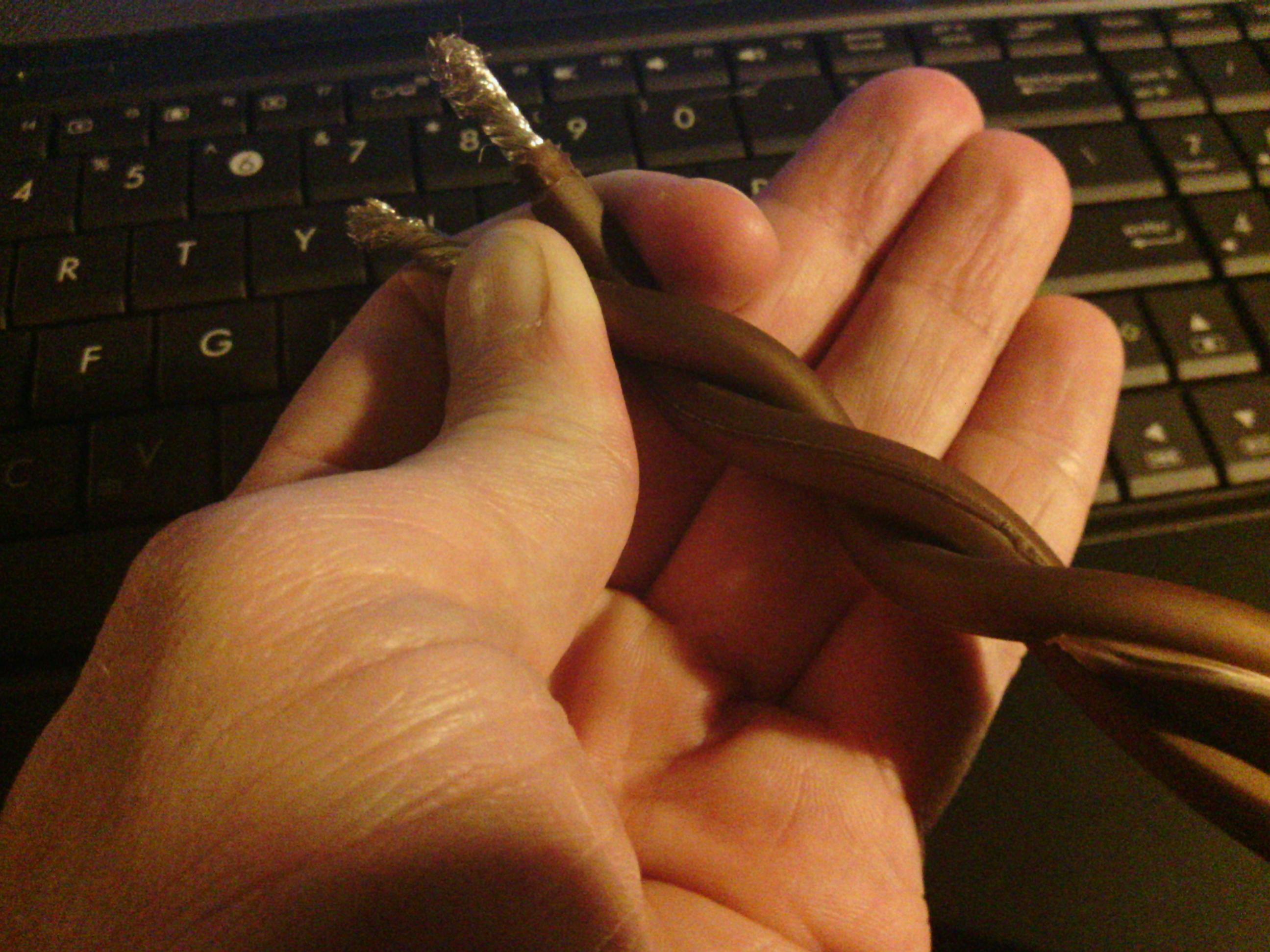

I'd wanted to use my leftover Van Den Hul D-352 speaker cable for wiring from the speaker connectors on the modules to the speaker connectors in my chassis, but these cables are quite bulky. When twisting them together it becomes even bulkier and unwieldy. It is not possible to twist them together as tight as a thinner cable. Will this be OK to use it or better use a thinner cable?
I'd also like to know how other Ncore owners connected the modules to the speaker connectors. e.g. which cable, single or multi stranded, cable length etc.
If you were setting it up for single cable feed, then split it into two feeds, one for each side of the screw. Don't twist the wire, you'll just make it thicker, let it lay flat. That is already twisted into a cable lay so more twisting is not a good idea or needed. You should be able to separate the cable lay easily into the two ends you need to insert. Make sure no loose strands are left out to cause trouble. You may need a small amount of heat shrink to make it safe.
No way you can use that wire for an optimal bi-wire set-up. See Bruno's earlier post about set-up for bi-wire and the Ncore.
