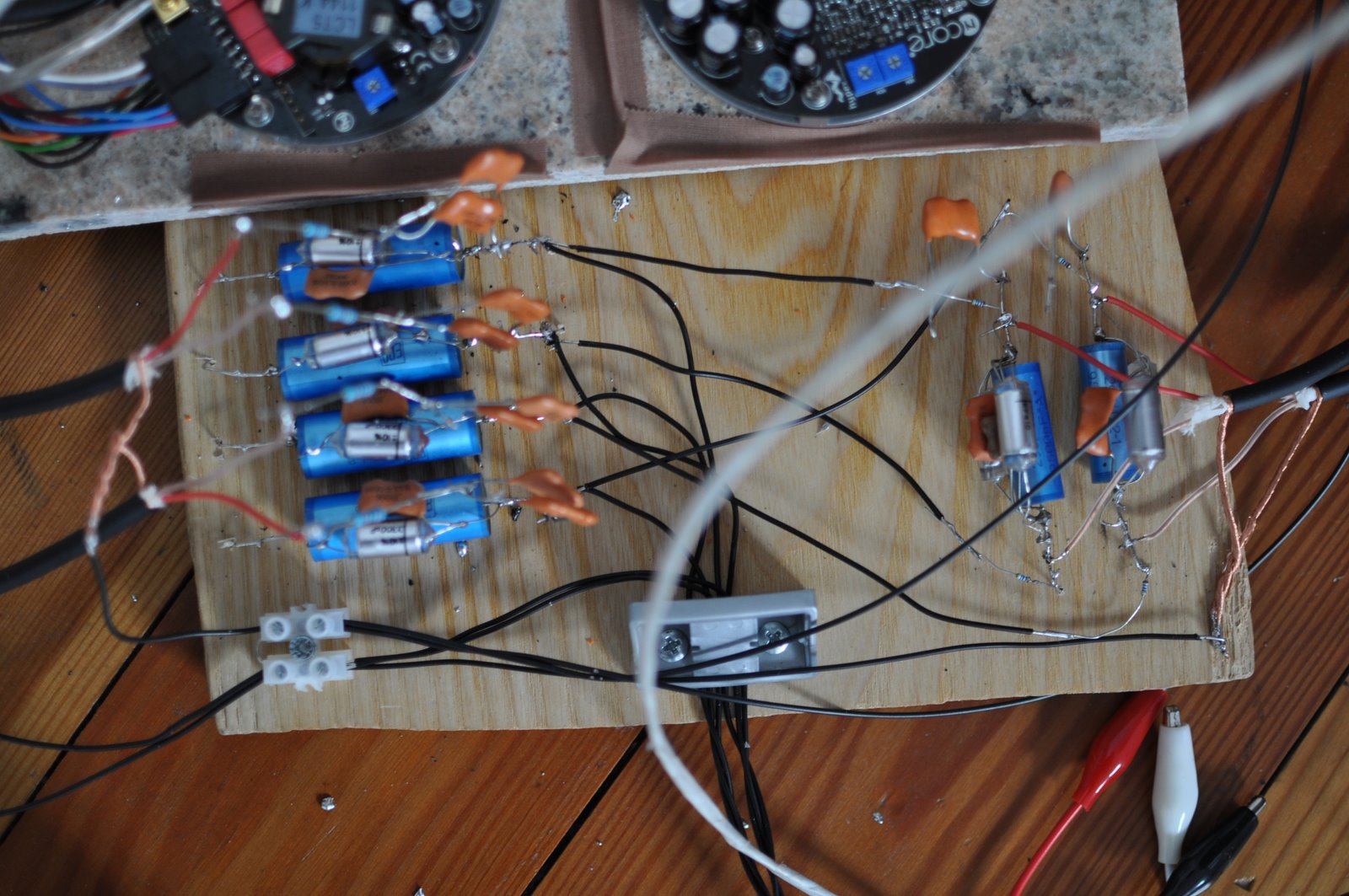

R141: I can only surmise that either you're taking the wrong resistor for R141 or somehow the parallel resistor isn't making contact. It has to work...
It is almost impossible that there is a bad connection on both channels at the same time. I paralleled the resistor at the outside of the module, near the N and the C from the ncore logo.

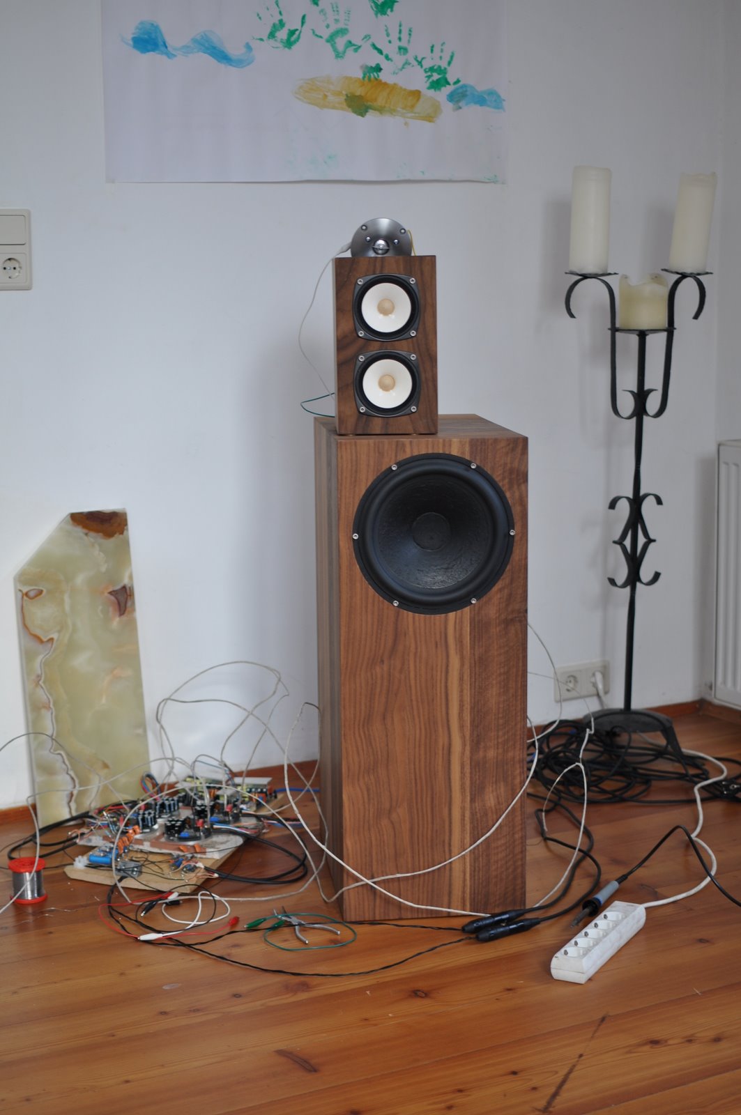

Re 1 vs 2 supplies: can you make a picture of your set-up? More precisely the input wiring. Connecting 2 modules on 1 supply creates a ground loop which should be shorted out somewhere between the amp and the source. The most obvious place to do so of course is at the XLR's (by way of connecting the cable shield directly to the connector shell and shorting the connector shells together via the chassis). If the ground loop is allowed to force current into your source equipment you risk getting some fairly serious intermodulation between both channels. This means if someone wants to try 2 vs 1 supply without a chassis he'll at least have to bolt the input connectors together.
In the current set up ground is connected at the input of the XLRs. The test set up were made with two modules on a passive speaker, the connection were present at the same point too.
I don't think I'll be adding input sensing to the amplifier anytime soon but as an external module it makes sense. Especially since people are also asking for a pushbutton switch. For safety that requires a standby supply but I felt loath to sell a standby supply just to replace a mains switch. But if at the same time it can power a signal sense circuit that could make sense. One thing I'm not sure of is whether people will like the idea that the first 2 seconds of their music is lost while the SMPS and power amp turn on.
I think people will live with this situation. If they have not turn on each active speaker ;-)
