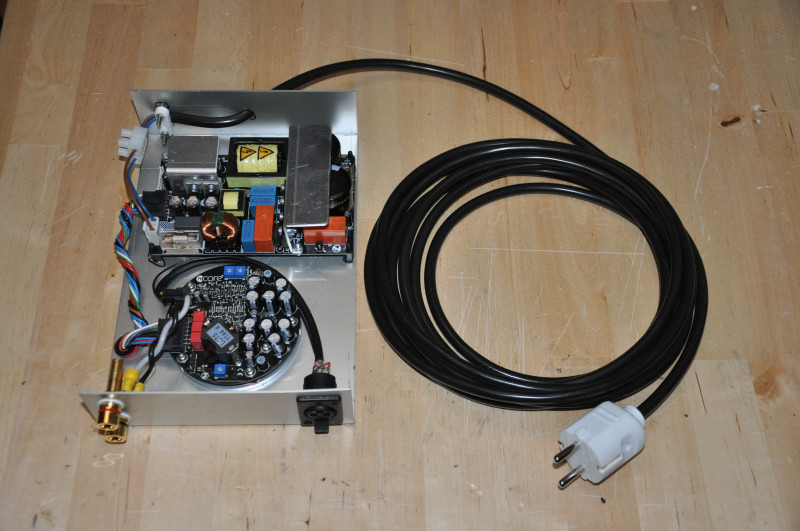

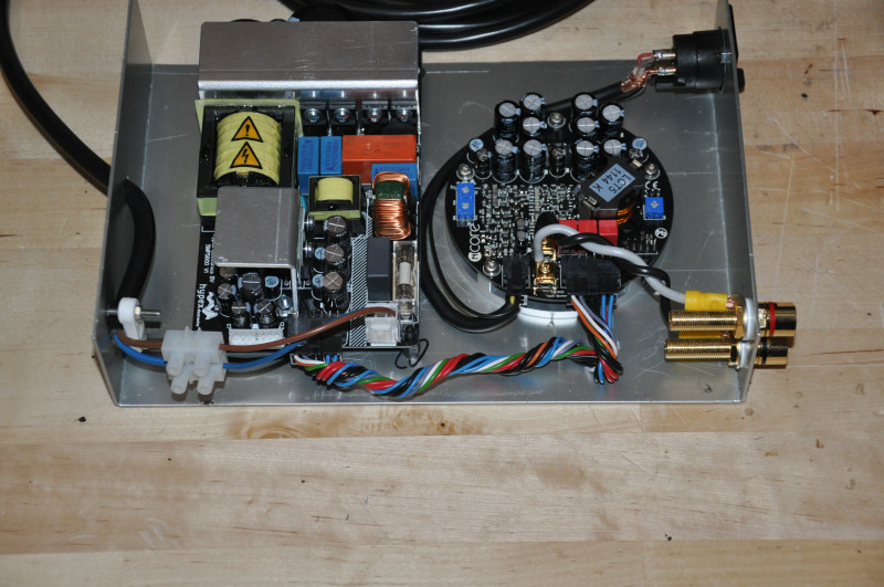

Here's two pics of my recent Ncore build. They are simply mounted on a piece of alu sheet, and will be placed inside my H-baffle woofers. I have four of these.

Stig, if I were you I'd rotate the NCORE 90 degrees clock wise -> shorter input cable and it doesn't run near the PS. I'm not sure if this is bound to make an audible difference but it's free.
one mistake I made with my UCD implementation was that I ordered the case before having all the components in front of me. as a result layout and wiring is suboptimal and I never got to fix it (lazy). it basically needs a new case to be fixed. most likely the next upgrade for me will be a more appropriate, custom-drilled case. with an amp like the NCORE I'd make all efforts to do everything by the book.

Ah well... originally I had intended to have both the SMPS and NC400 rotated 180 degrees from what I have now, but then I by accident mirrored the drill pattern...... 😱
But I dont care to fix that... it works like a dream, and there is absolutely NO noise even with close to 120 dB / 2.83 V efficient speakers!
I asked about that earlier in this thread, the answer was you can place the NC400 as close to the SMPS as you like, and in any orientation. Apparently no problem with the signal wire either. I have NO, absolutely NO, noise. Even if I put my ear at the speaker cone itself, I cant hear any noise. And this is with 98 dB sensitive woofers.
The drivers are 98 dB nominal. I have four per channel. That is +12 dB. And they are mounted in H-baffles, which increases the sensitivity by almost 10 dB around 150 Hz, hence "120 dB". 120 dB in a limited frequency band, but even so..... 🙂
