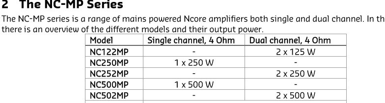

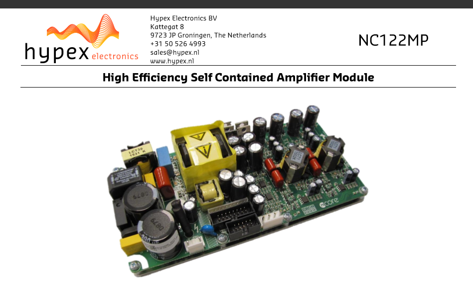

Yesterday I visited ISE 1016 in Amsterdam.
At the Hypex stand I discovered a nice range of lower power Ncore boards with integrated SMPS, very well suited and apparently aimed for active loudspeakers.
Integrating these in a quality loudspeaker will make this thread rather redundant as IMHO much more is to be gained this way instead of playing around with a socalled "best" input stage for an NC500....
The NCxxxMP????
Why not....the modules are officially presented to the professional crowd so no reasons to hold back the datasheets or?
