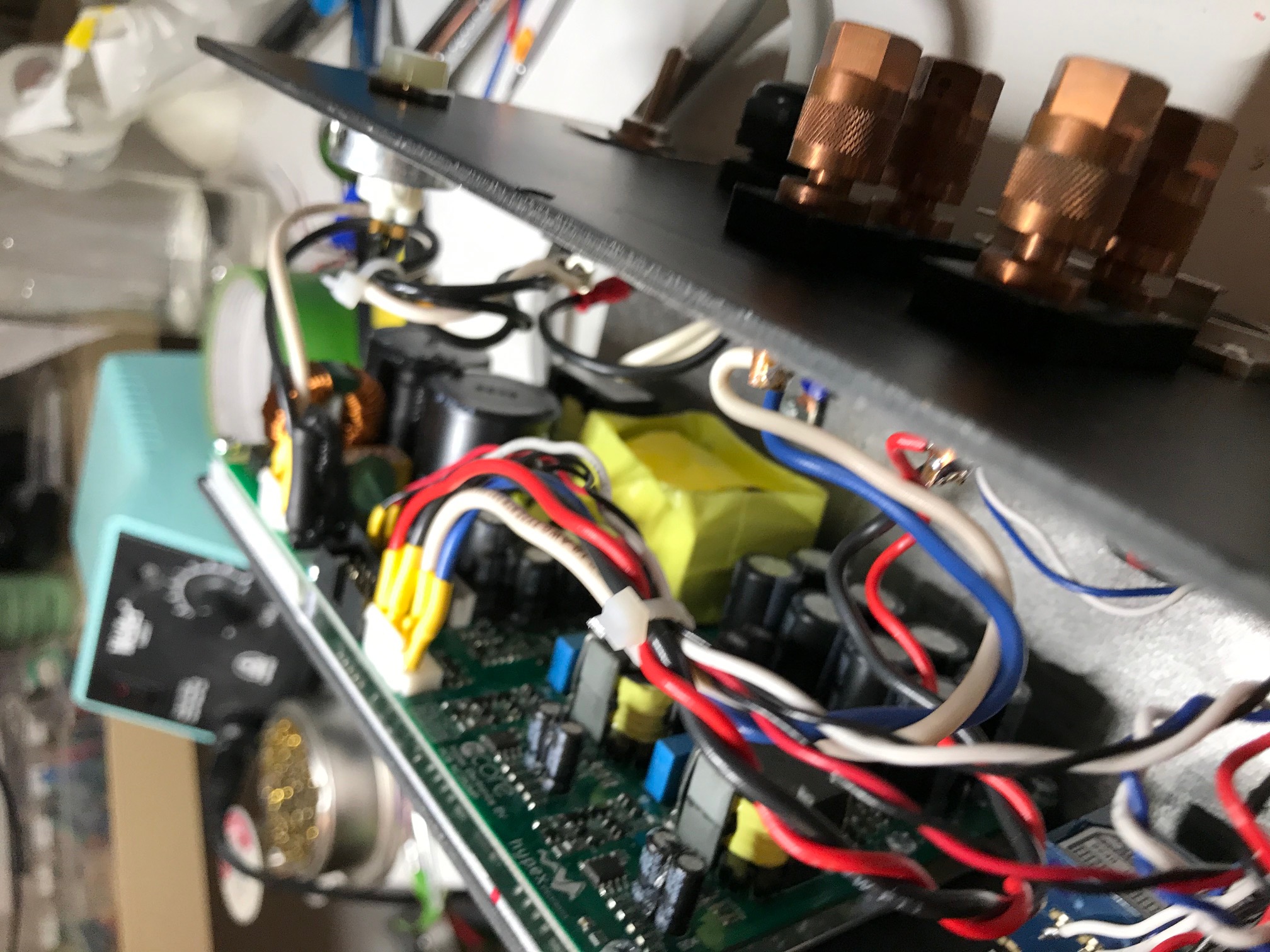

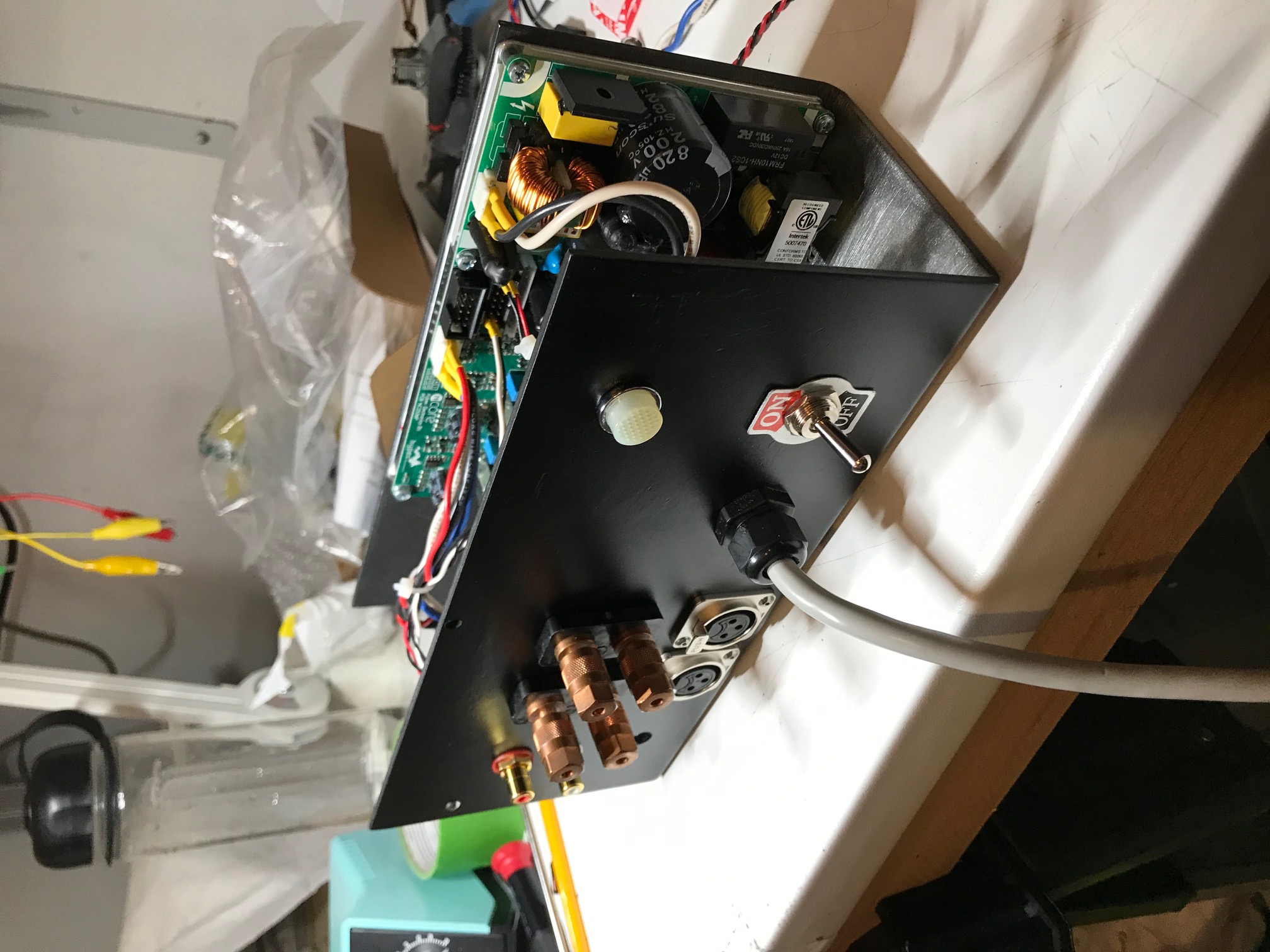

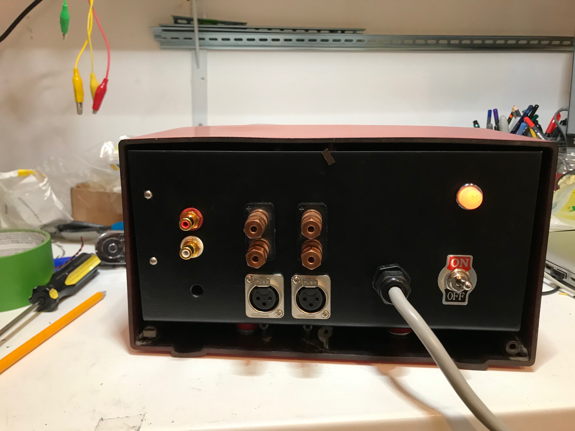

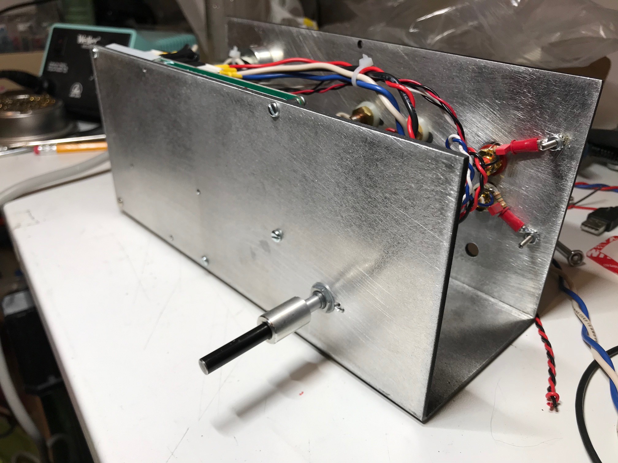

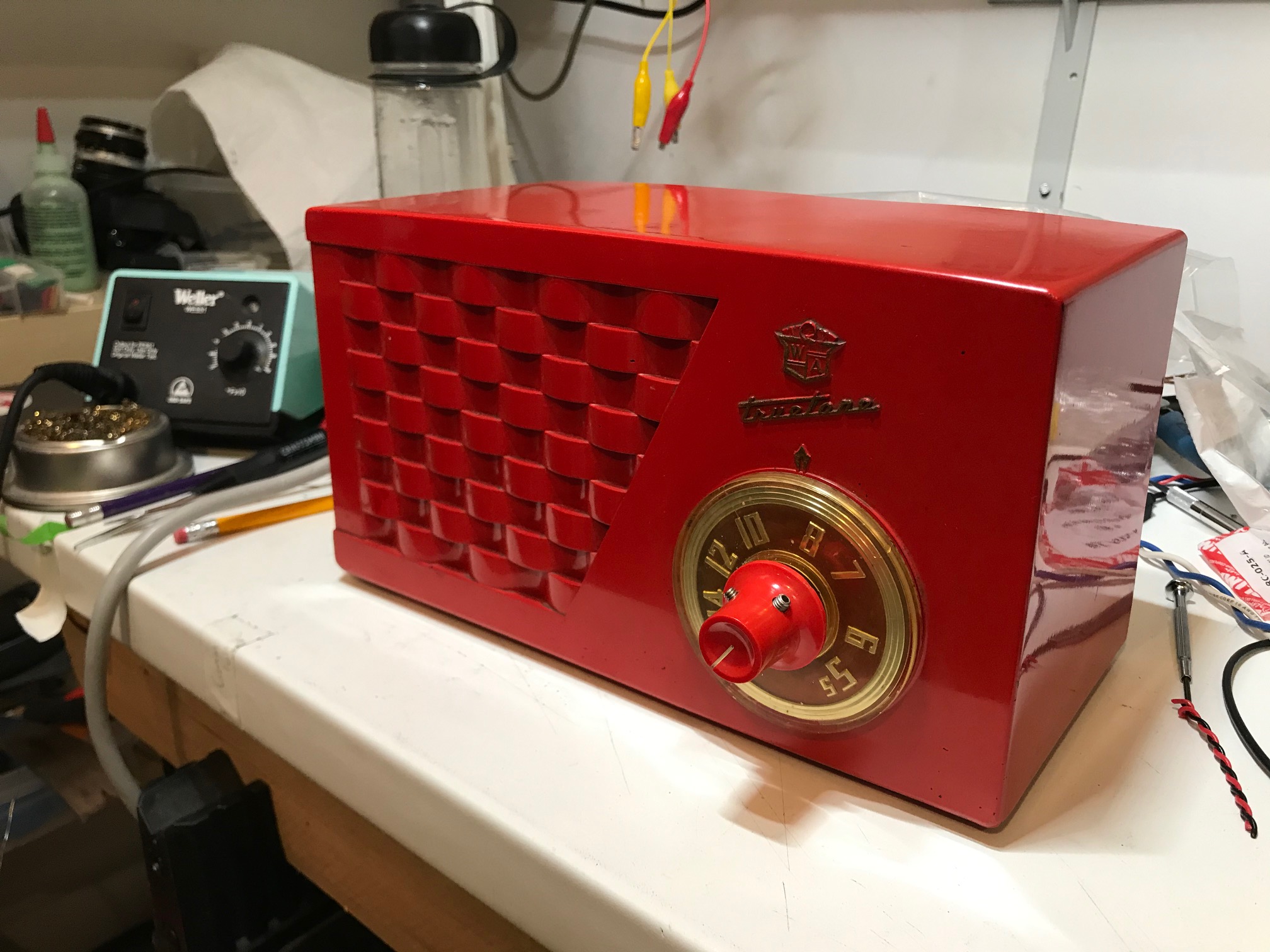

I just put this little amp together. NC252MP board stuffed into an old 1950's radio chassis. I had someone bend up the aluminum U, and then just assembled everything. Haven't done any serious listening, but sounds pretty good so far!

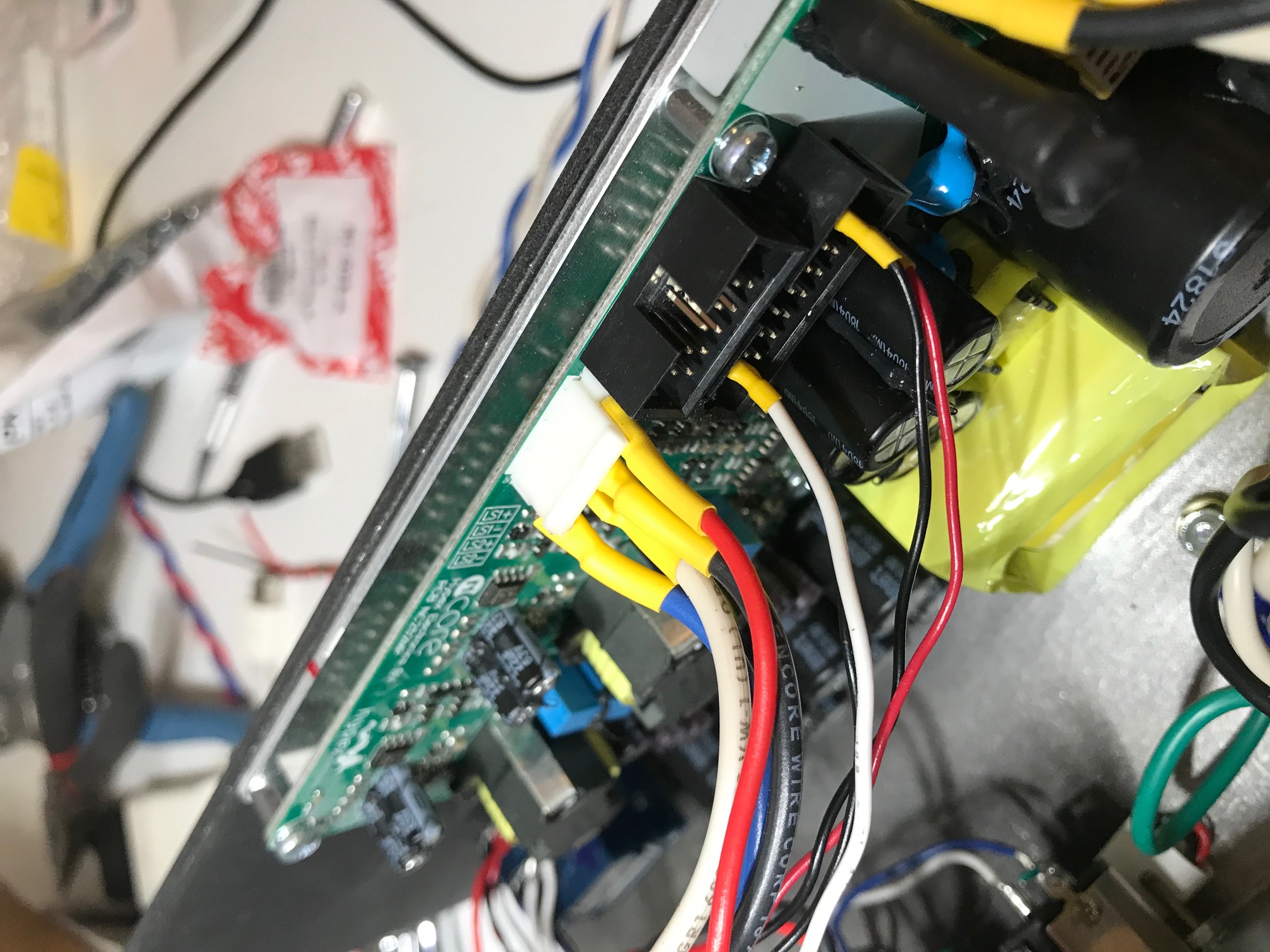

I have a question about the Hypex NCore standby connectors.
My NC122MP's standby connectors are connected directly (No switch between), and amp's main switch turns on/off the amp. I hear a little thump when it's turned off, and I wonder if this configuration would damage or add stress to the NCore module, or it's perfectly ok?
I'm definitely no hypex expert. This is the only one I have done.
But what I do is just power the amp on/off just with switch to the AC power.
I did insert a switch in the Vout(enable) to the PS enable input pin. So I have the option of putting it into standby if I want to. But generally I just leave that enabled all the time, and use the main AC switch to turn it on.
I do hear a tiny sound when I turn the amp on either way, but it's very minor and I wouldn't quite call it a thump. Maybe a mini-bump is all.
I doubt either configuration would harm anything (mains AC switch, or using standby), but hypex is pretty responsive with questions, so I wouldn't hesitate to reach out to them if you have a concern about it.
