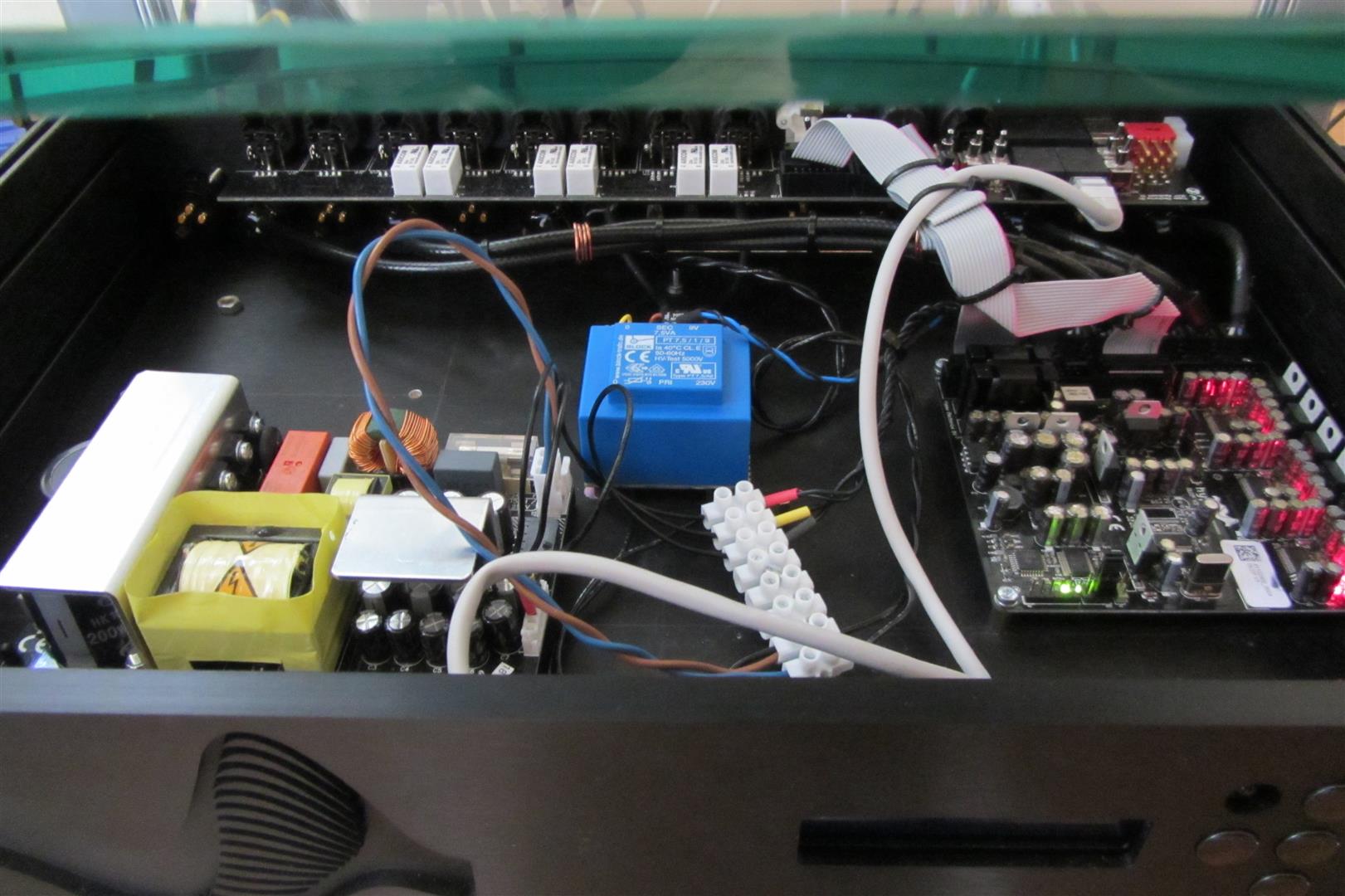

With help from Tytte71 my DLCP is now back in business. We changed the powersupply to a SMPS600 as a temporary solution.
attachment.php
However, when we turned it on I still had the on/off issue. When the chassis had been deassembled, I had tightened the screws on the control board. Tytte71 suspected then the cause was the standby button being too close to the panel of the chassis and thus going on and off. We loosened the control board and added some washers in order for it to stand out a bit more. Since then, everything has been working flawslessly and I have played for several hours.
Since two things were changed, we can't now for sure. But most likely the cause wasn't the PSU voltage but the control board sticking too close to the box. If I remember correctly Modushop did the drawings based on the Hypex 3D drawings. So this is something people should be aware of.
Most important thing is that it's now playing fine and sound quality is as before stellar. I have however had some issues were a new filer doesn't always upload to the DLCP and once the sound disappeared after trying to upload filters several times. Had to turn off the DLCP completely in order to get the sound back. If this continues, I'll contact Hypex. That's something I can't live with. Anyone else that experience simliar?

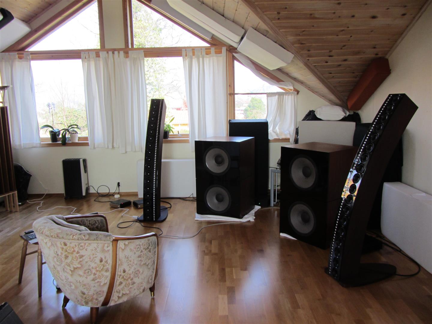

Here's a shot of the setup I'm using the DLCP in now. Very addictive sounding and hard to get away when I sit down. 🙂

"If I remember correctly Modushop did the drawings based on the Hypex 3D drawings. So this is something people should be aware of."
No, it is my drawing based on the hypex 2d files. And yes you need a washer between the pcb and frontpanel. This to give space for some protective window in front of the LCD.
"I have however had some issues were a new filer doesn't always upload to the DLCP and once the sound disappeared after trying to upload filters several times. Had to turn off the DLCP completely in order to get the sound back."
This is a known issue, Hypex is looking in to that. Another niggle is the DLCP loosing it's setting for the Hypex remote. Sometimes it resets itself to one for all.
