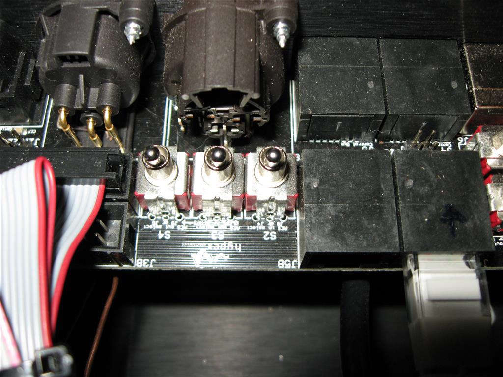

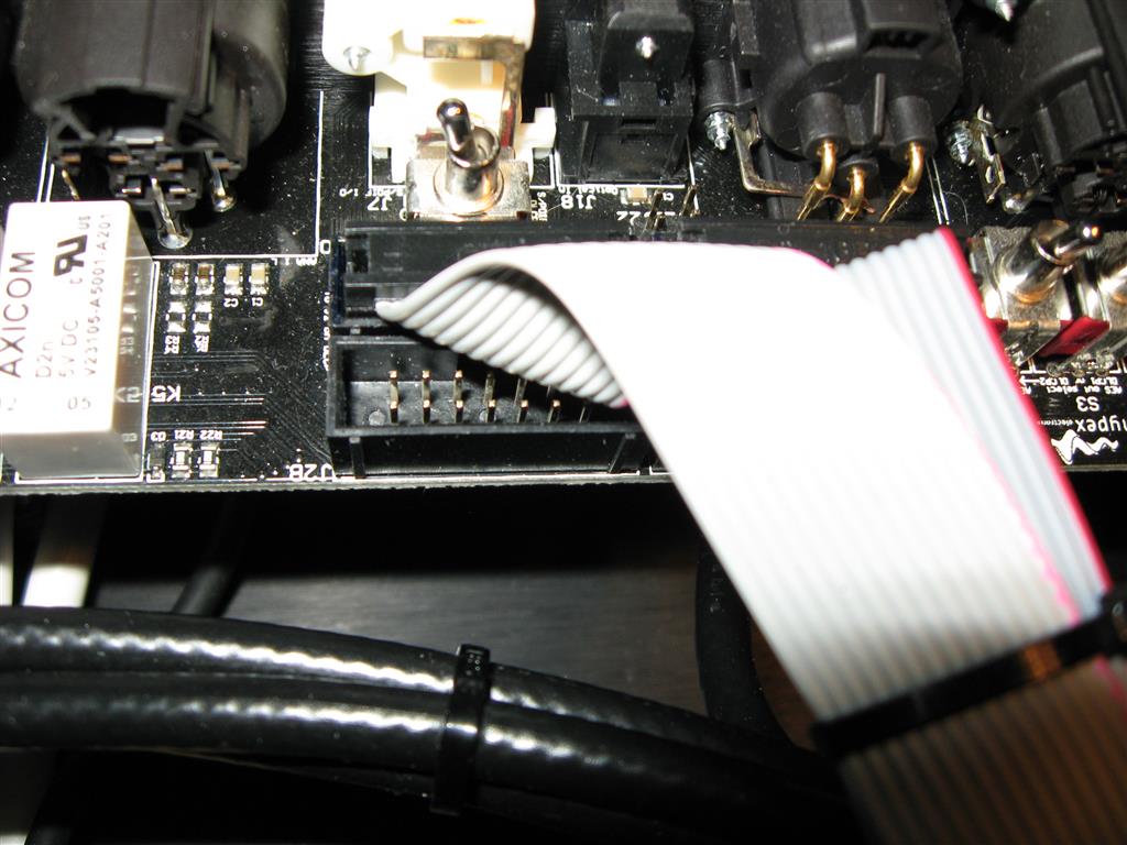

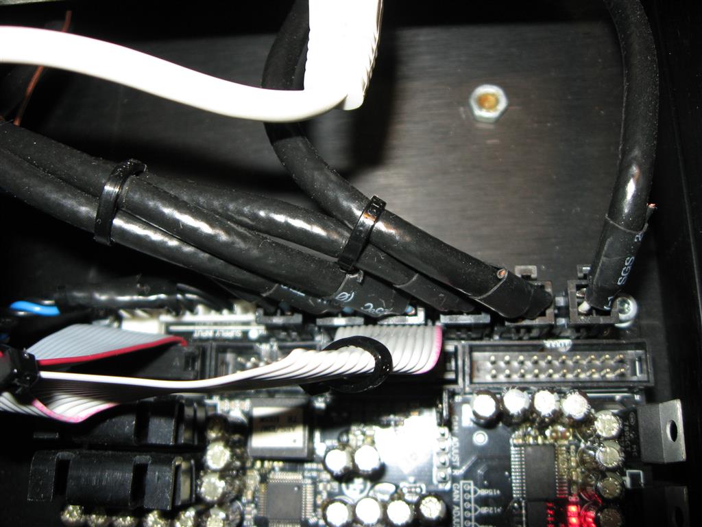

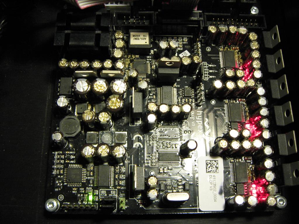

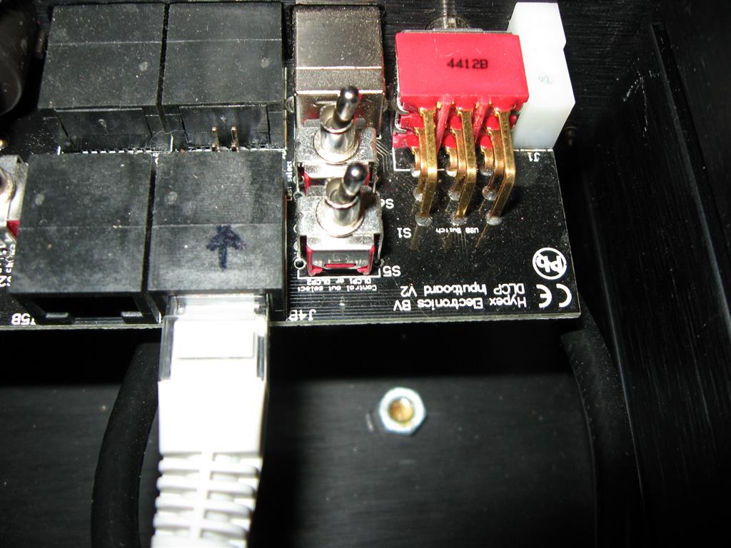

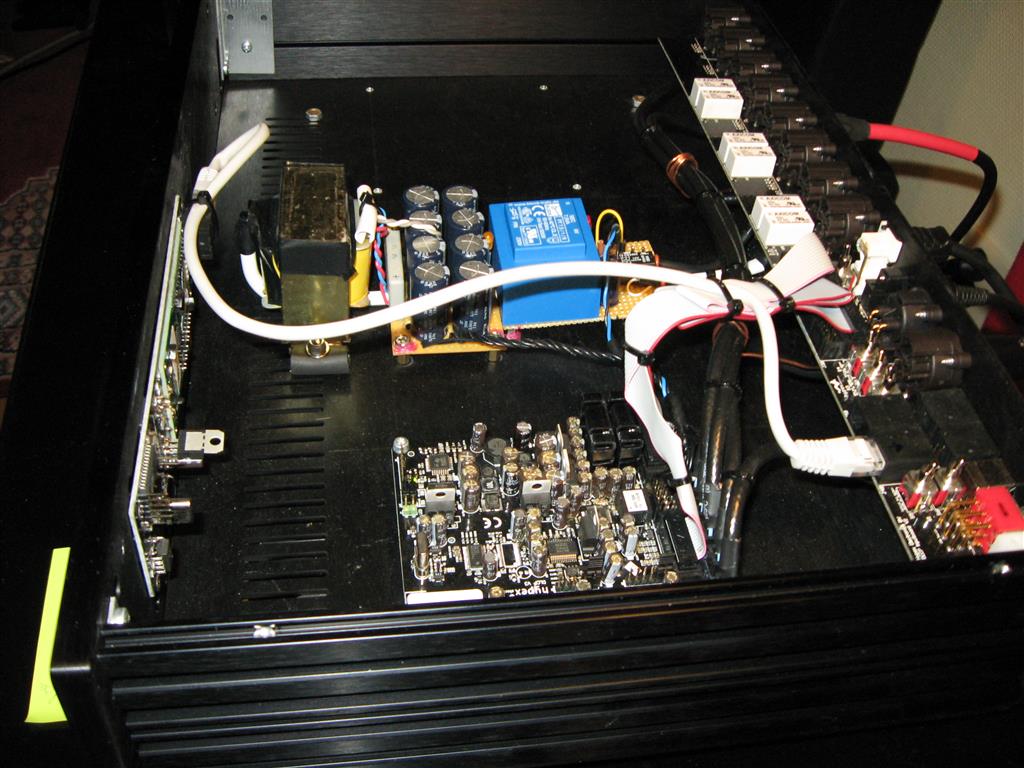

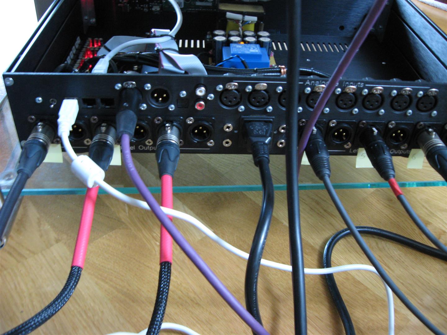

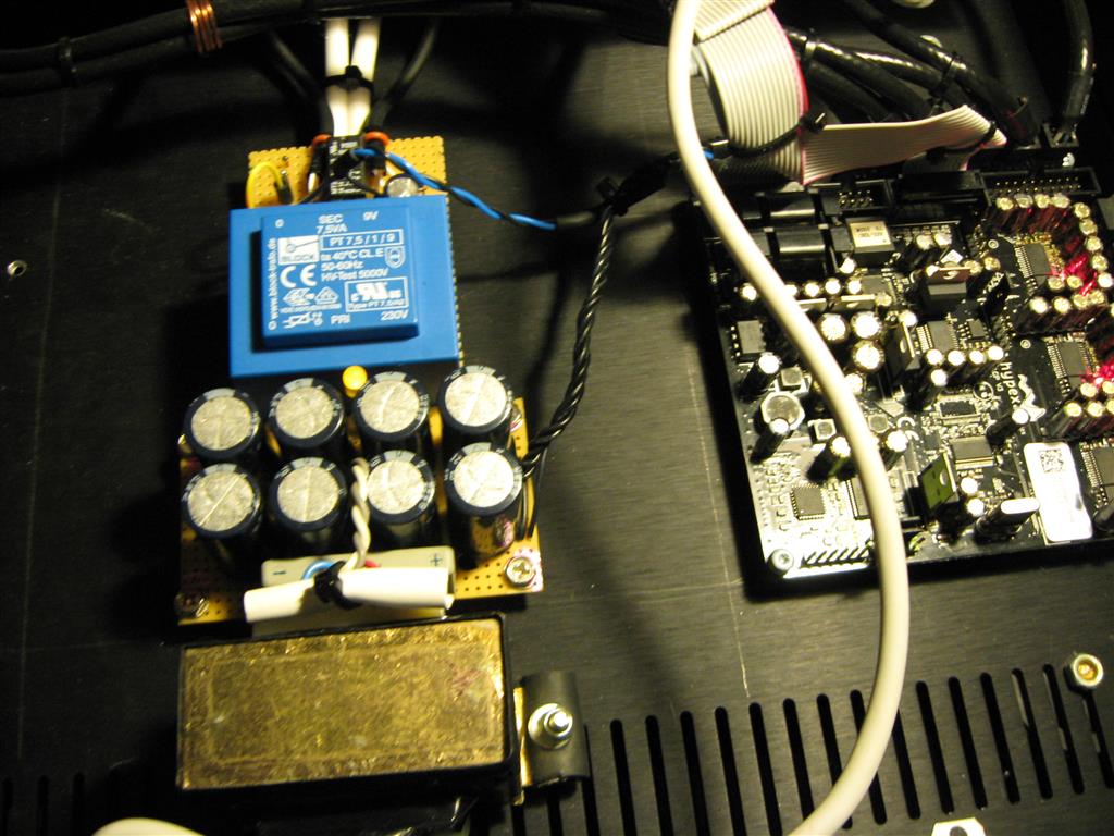

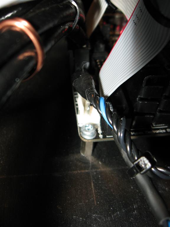

I'm not getting any sound from mine. It was installed by windows, and it connects automatically. I've tried both AES/EBU, Toslink, SPDIF, USB and analogue inputs without any sound. I've set the right input in the control panel accordingly as well as in J.River Media Center.
I haven't built mine myself but the one who did got it to work flawlessly before he sent it to me.
Can you guys see anything wrong with the connections or jumpers? There are lights both in the board, the PSU and the front display. Tried all outputs too. When I turn it on while I have the power amp on, I also get a pop in the speakers.

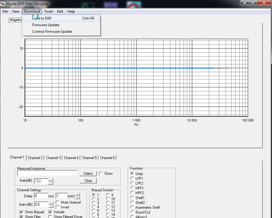

No I didn't. Trying it on pasive speakers. Talked on the phone yesterday to my builder, and he said he had sound right away without doing anything with the filter.Did you upload a filtersetting into the DLCP with Filterdesigner? No file=No sound!
But yes, you were right! I simply needed to press the download button and then "Load to DSP". Voila, sound 🙂

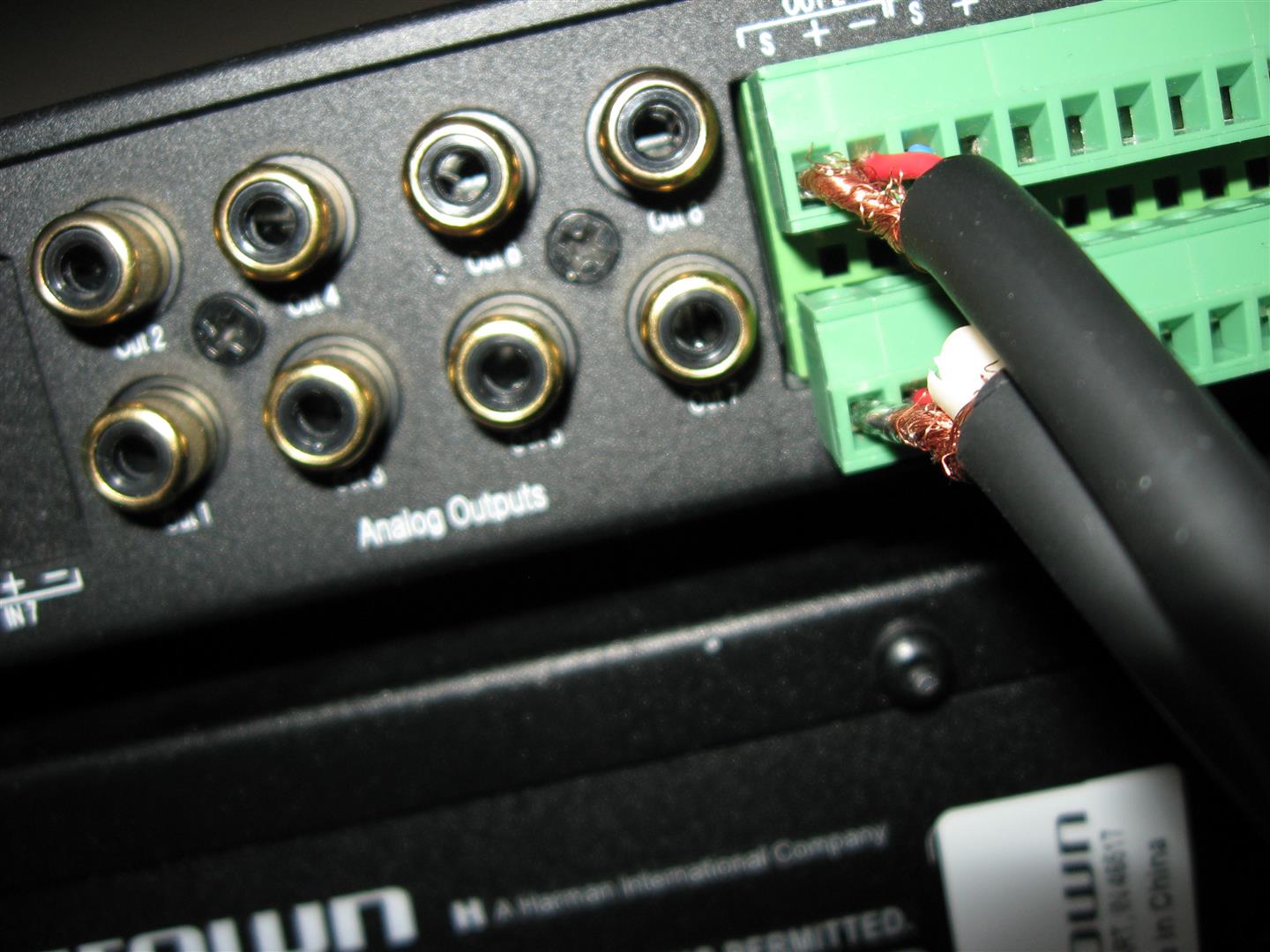

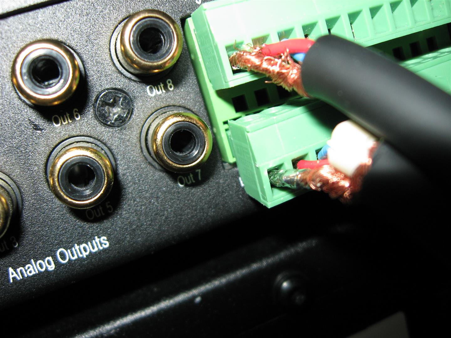

I have done some comparison between miniDSP 4x10Hd and the DLCP today, but I've been running the miniDSP mostly unbalanced so far. The reason is because I'm getting a hiss in the speakers when using balanced. The gain control is set to the lowest (4Vrms). There's less hiss when connecting my Abletec ALC1000 modules, but still some and these don't sound as good as the Ncores. I can hear the hiss from the tweeters in sweetspot at a low level.
Could it be that my connection to the Phoenix connectors aren't good enough? The ground wire is quite thick as can be seen and perhaps too much is exposed? I hate those Phoenix connectors.....
Want to make sure the grounds are more even before I share my expressions. However, I will say so much that the DLCP is impressive.

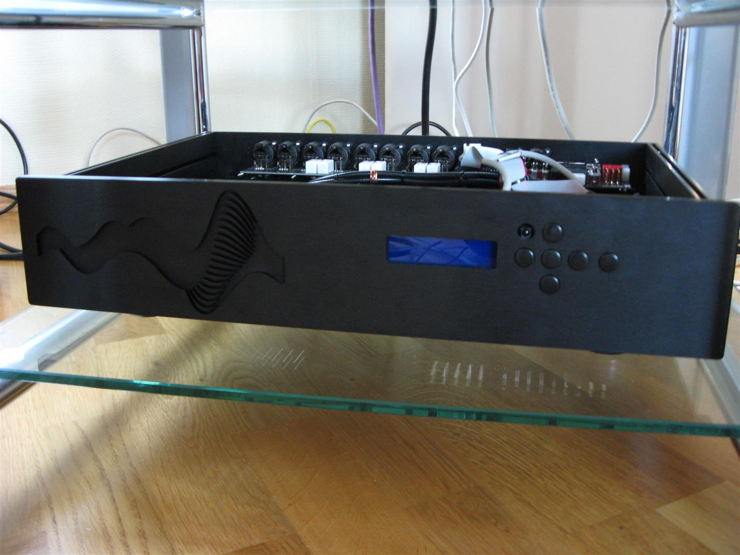

I've now moved the DLCP to my hifi setup which is of higher quality. Jan Willem was kind enough to help with adding the CBT36 settings from a manual. However I need also add a second order high pass filter at 30 Hz with a Q of 1,4 or 1,3 to protect the woofers, and I haven't figured out how to do this. The filter settings are almost greek to me. I don't understand the logic in it. Which probably speaks more about me then the DLCP....
Also I big thank you to ds23man who let me copy the drawing for the front. Very kind. Mine is made ready with outputs for another card and 12 channels.
