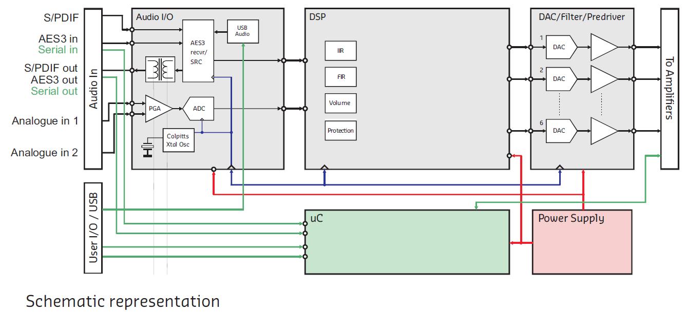

I'm Jan-Willem and i'm working on the 6 channel DSP board.
The gain of the analogue inputs is controlled before this signal reaches the ADC, therefore the ADC keeps working in it's best region.
The volume control is done inside the DSP. The volume of each input and the volume per channel can be controlled by the user. This will basically be the same as for the AS2.100 and the PSC2.400.
You will be able to control the gain of each output under filter settings in Hypex Filter Design (HFD). You got a master gain for the complete board, and there will be a gain adjust function for the inputs, so they can be matched. This is already implemented in Hypex Filter Design V2.0 for the AS2.100.
The amplifier_enable pin is used to control the UCD modules, at startup.
The supply voltage of the DSP board will be around 16-22 volt DC.
What about the DAC? Won't there be loss of resolution here?
Single +? Or +/-?
The master gain, is controlled inside the DSP, and off course the DAC's and ADC performance is the best at 0dBFS.
Excuse me, its +/- 16-22 volt DC.
