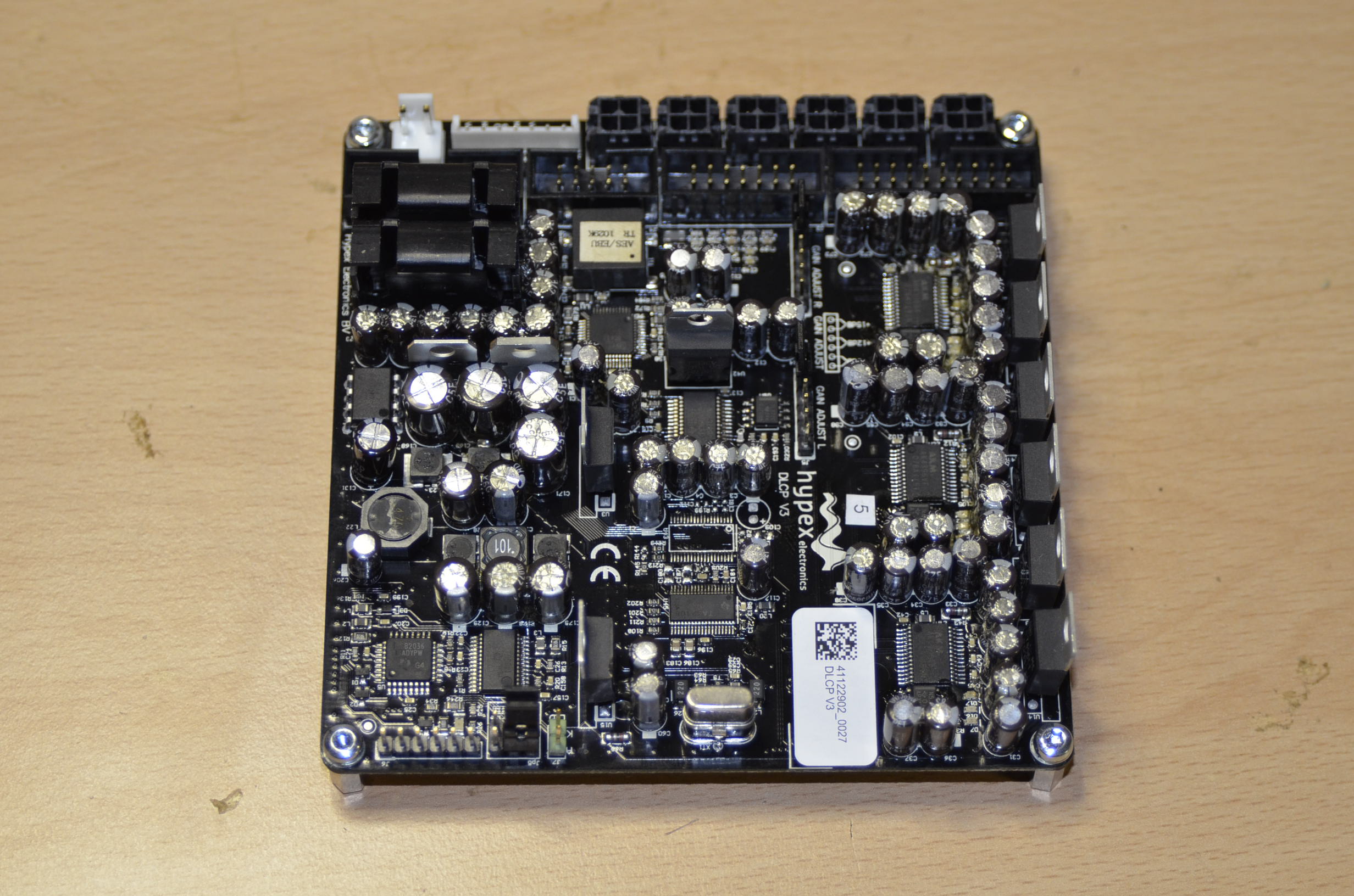

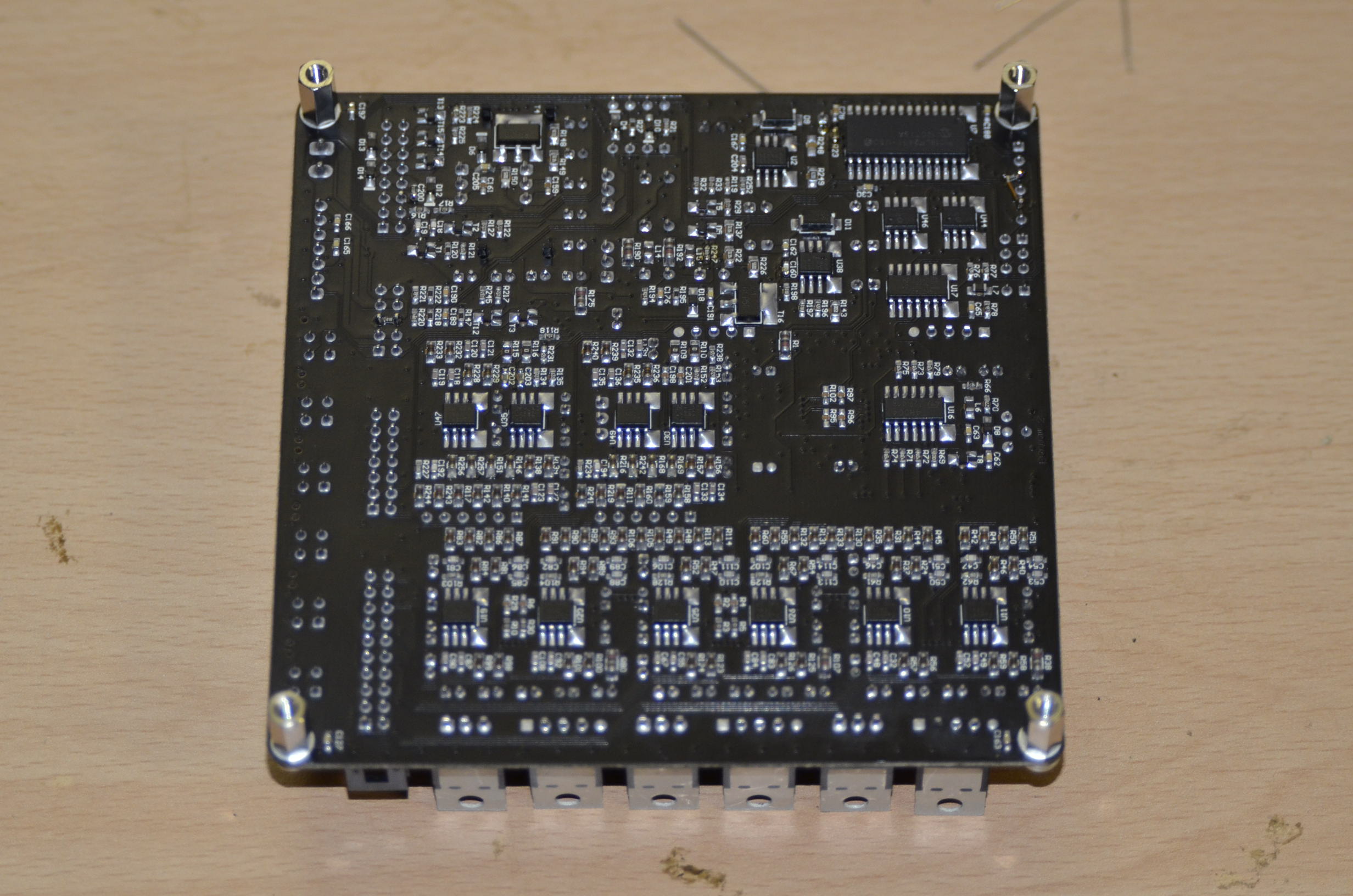

Some quick and dirty pictures, will make better ones with daylight tomorrow!
