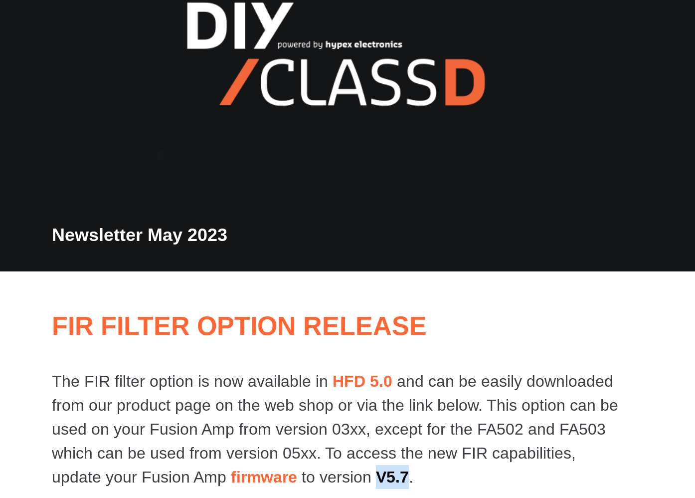

As mentioned in this thread, you need the new FusionAmp modules that have the 5.x firmware to run FIR filters. I don't, and I have eight FusionAmp modules.... What I did was to bypass the Hypex DSP and use MiniDSP instead. It's quite easy to do, by simply removing the signal cable on the nCore amps and route the output signal from MiniDSP (or any other DSP) to the nCore amp input connector.
Like this:
Like this:
