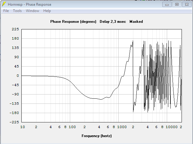

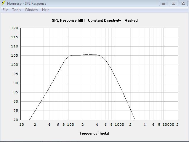

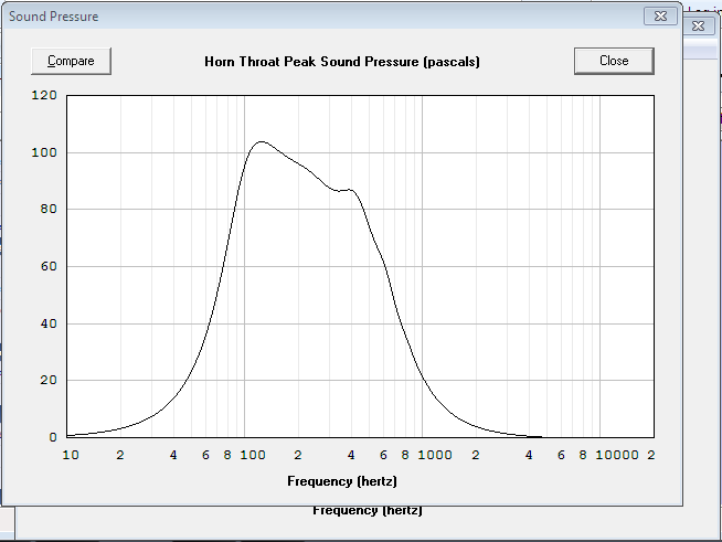

here's my old outdoors ~1/2 space graph of Dr. Edgar's early ~100Hz flare rate hypex with ~20.5"x20.5" mouth, ~20 back from mouth to an 80sq.in. throat, loaded with JBL 2220H and a clone of Klipsch K43 (sine distortion shows K43 - 2220 was ~10dB higher. I'm more a Karlson-coupler guy than a horn guy)
It would be nice to model this. Also seems interesting in that it appears to only have a flare on one axis. Parabolic in the horizontal and the hypex in the vertical, probably intended for the other orientation, but flipped for the measurements due to not so great off axis response.
Not so awesome 🙁
Code:
ID=28.00
Ang=2.0 x Pi
Eg=2.83
Rg=0.05
Cir=0.76
S1=516.13
S2=2711.28
Hyp=20.80
F12=100.07
S2=0.00
S3=0.00
L23=0.00
T=3.13
S3=0.00
S4=0.00
L34=0.00
AT=36.25
S4=0.00
S5=0.00
L45=0.00
F45=0.00
Sd=530.00
Bl=17.16
Cms=2.04E-04
Rms=2.04
Mmd=55.97
Le=1.53
Re=5.70
Nd=1
Vrc=20.00
Lrc=20.00
Ap=0.00
Lpt=0.00
Vtc=1000.00
Atc=530.00
Pmax=100
Xmax=5.0
Comment=Edgar sim

Using the System Designer in Hornresp, it gives a 100 Hz 2Pi Le Cleach horn as 122 cm long for this 12" driver, which is longer than the hyp-ex. It also gives a warning that the mouth is too small for the full flare of the horn.

Thank you for participating Jmmlc! Interesting and exciting theory, and if I understand it correct, it seems what NEO Dan has been saying about the low end response.
If time, I will post som screenshots of the horns you attached.
L 1m, S 0.5 sq.m, cutoff 75 Hz on my avatar.... horn such that the mouth is flush with the .. wall..
