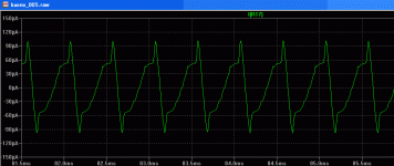

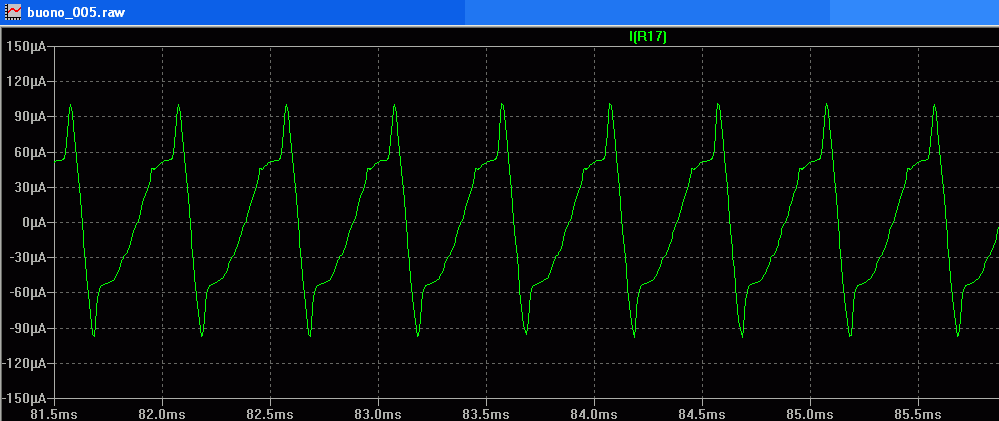

This is the gate current noise I was referring to.
Caused by Aleph's Collector overshooting the mark.
Not caused by bootstrap. Simmed with your battery.
This was straight from your 005, no modifications.
Let me see if I can fix this by throwing a little Zen
style Schading around that bipolar....

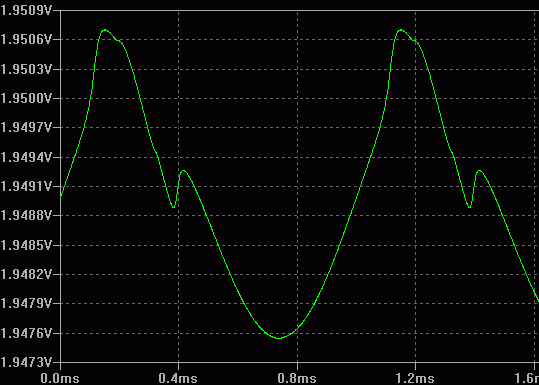

Rev, this is the wiggle measured at your 007 bias LED.
Funny thing: Cathode bias smooths out into a mostly
normal looking sine with as little as 220uF in parallel.
But this makes the output distort even more ?????
Perhaps I'm just looking at the verge of output stage
clipping, extra gain sends it further over the edge?

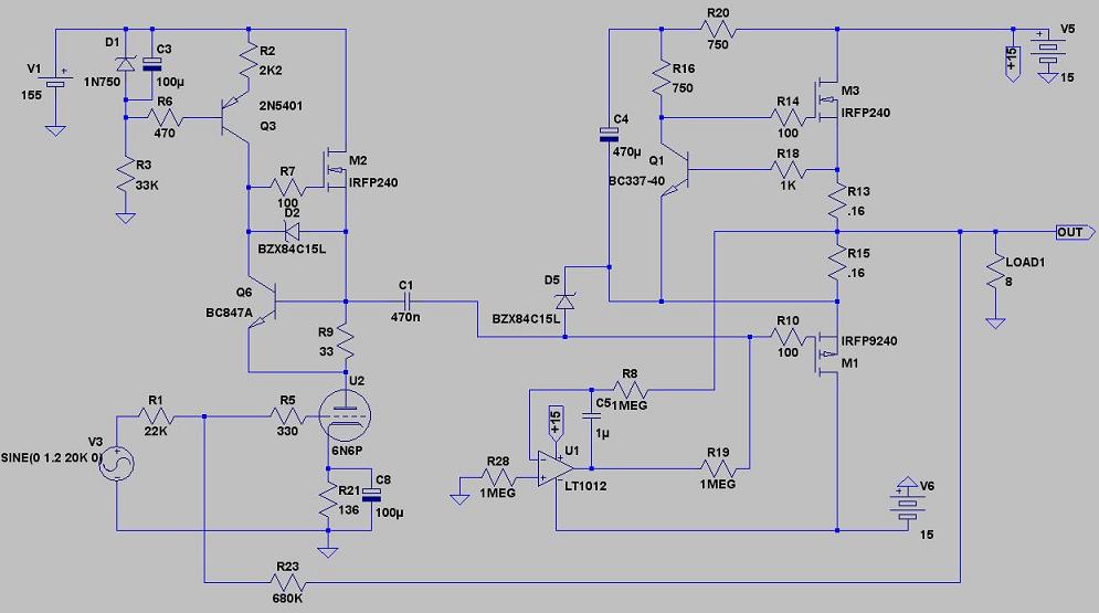

Hi all,
I didn't forget the thread, I've been very busy with my job and my real life (a daughter, a wife and a dog don't leave you so much free time...).
I ended up with a new schematic, the one below.
I tried a lot of configuration and circuit arrangement, from common cathode to LTP and beyond... and decided I like the simplicity of the schematic I'm showing you now.
The circuit sims very well, the THD and the FFT looks very fine (at least to me), and is quite simple.
One can remove the feedback and make it even simpler.
Ciao,
Giovanni
The Mu Follower node at R9 top may have lowest "impedance".
But its asymetrically slewed impedance. Pull-up appears infinite,
but pull down no better than your unaided Triode. I see nothing
in next stage that favors this imbalance of slew.
Why you didn't tap drive from the midpoint of r9? Where the
Aleph becomes an equal truly anti-opposite triode in SEPP?
Six one way, half a dozen the other...
Good job on Q3. Emitter impedance at Q6 (seen as-if a cascode)
low frequencies can't leak through bootstrap, cause now there
isn't any! But think you could have picked a smaller MOSFET with
lower gate charge. Where Q6 emitter impedance may yet droop
on the high frequency end....
I mean, its only a preamp stage. Does a triode really want to
charge and discharge the full gate capacitance of M2 IRFP240
through the Aleph's emitter? Overkill component choice...
I mean, if the purpose of the Aleph was to help this plate drive
the big gate of an M1 IRFP9240, does it make sense to load it
down (through the cascode) with an equal or larger dynamic
burden than the one you just got rid of?

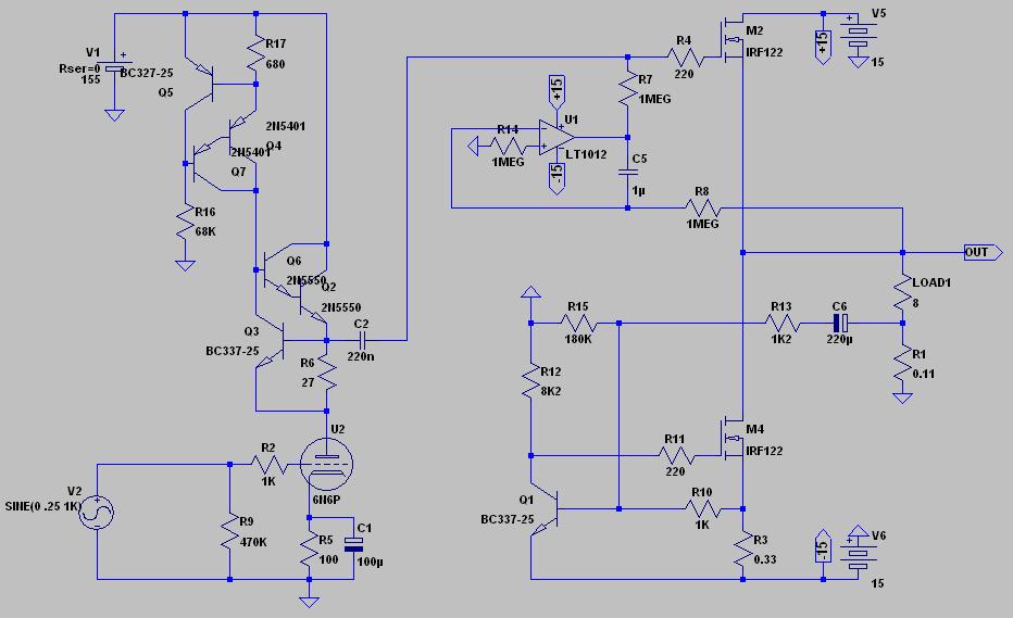

Hi all,
I didn't forget the topic nor the project, I'm simply too busy with my job, my daughter, my wife, my house, my dog...
OK, I found a bunch of IRF122 mosfet in one of my scrapboxes in my garage, so why not to use them for this project?
I can use them as a source follower, they should be good enough for the job.
The only problm is I need a complementary P-channel mosfet or bipolar for the active current source... But do I really need it?
I had a food idea (in my opinion, at least), and realized an output stage that uses only N channel mosfets (2 IRF122), keeping the Nelson Pass Active current topology.
Other advantage is we do not need anymore any bootloader for the ACS mosfet.
Attached LTspice schematic.
Ciao,
Giovanni
  • input_singolo_023.txt
Sorry, what I meant was "boot strapped circuit"; I'm a programmer, other than an electronic engineer, so the wrong word...
It simulate very well, even better than myu previous schematics on this thread.
And here is the schematic.
Ciao,
Giovanni

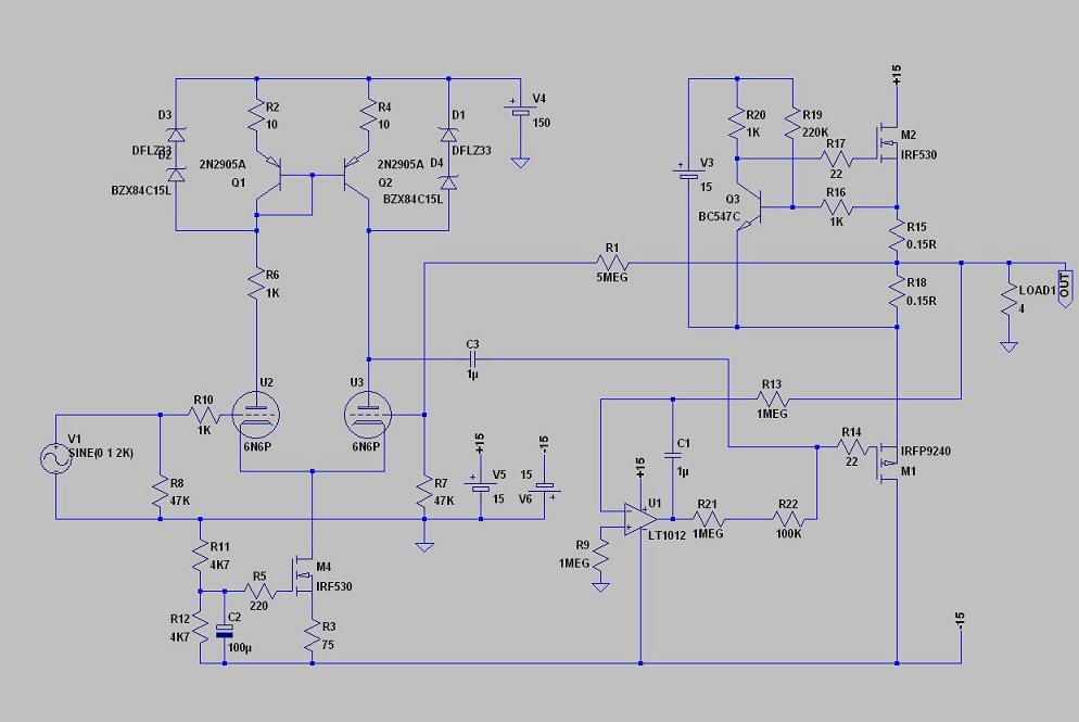

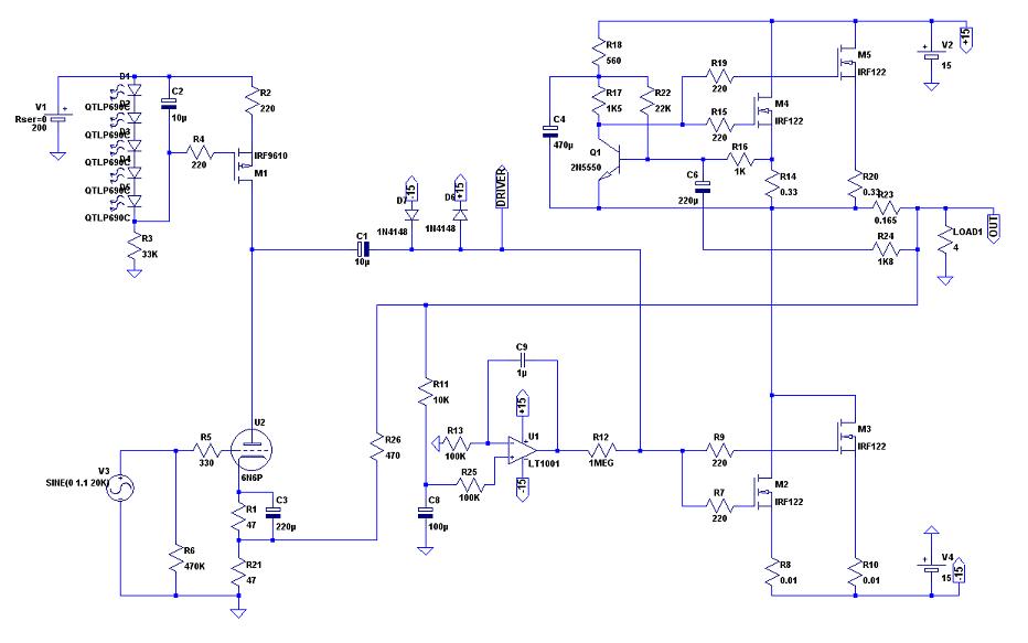

Old thread, but not dead.
I continued in my research, and I ended up with a very simple but very nice amplifier project.
I discarded the source follower and went back to a more "canonical" Aleph output topology... but keeping the input tube.
Added also "a lot" of feedback, and it seems it is worth the effort.
I also moved to a parallel output mosfet topology, which seems to lower the THD.
The circuit below simulates amazingly well in LTspice (better than the original Aleph Mini, actually); I'm now in the process of building one prototype, just to test it.
I redrawn the circuit with Eagle, and now I'm drawing a PCB I can build the prototype on.
I will let you know how it will work in real world.
Ciao ciao
