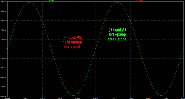

Hybrid Transimpedance Tube Amp Sim
Thank you.
In the meantime I built a prototype along the lines of the original paper but with the balancing issues resolved differently.
Some more changes:
  • overall gain reduced to 22dB
  • output pentodes from 4 x 38HK7 sweep tubes cathode biased to dissipate 12W idle
  • balancing issues resolved as shown in a reader's letter 1995: https://www.diyaudio.com/community/...-jeff-macaulays-hybrid-amplifier-jpg.1166051/
  • unorthodox power supply runs from a single isolation transformer 115+115V
  • uses 4 x booster diodes from 38HK7 (2 per channel) as rectifiers in voltage multiplier configuration
  • series heater chains from same 115V transformer windings as B+ as well as opamp ps
  • multipliers and heater chains are half wave but connect to the transformer halfs in pairs so that DC cancels
Result:
  • not very efficient (160W from mains)
  • output 20W max with 1V line input
  • output impedance about 1 Ohm
  • unexpectedly quiet despite the half wave multiplier rectifiers running in the same bottle as the outputs
  • sounds good enough for me
