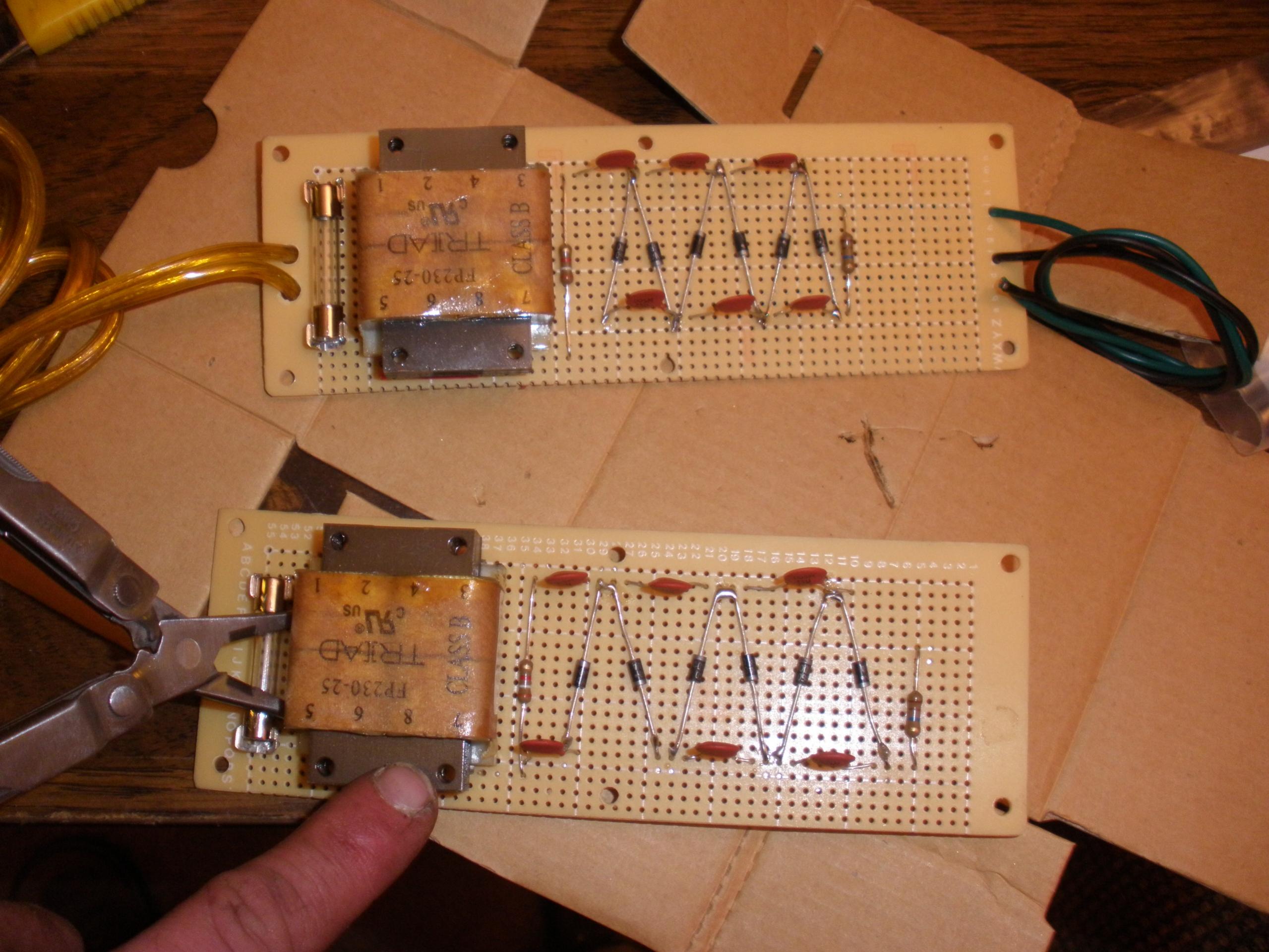

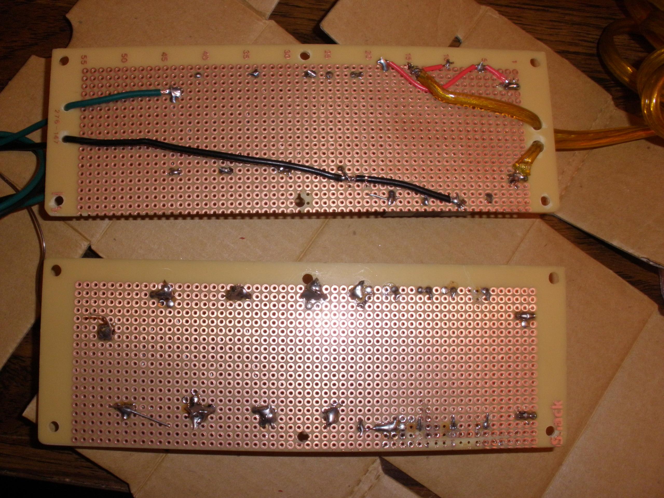

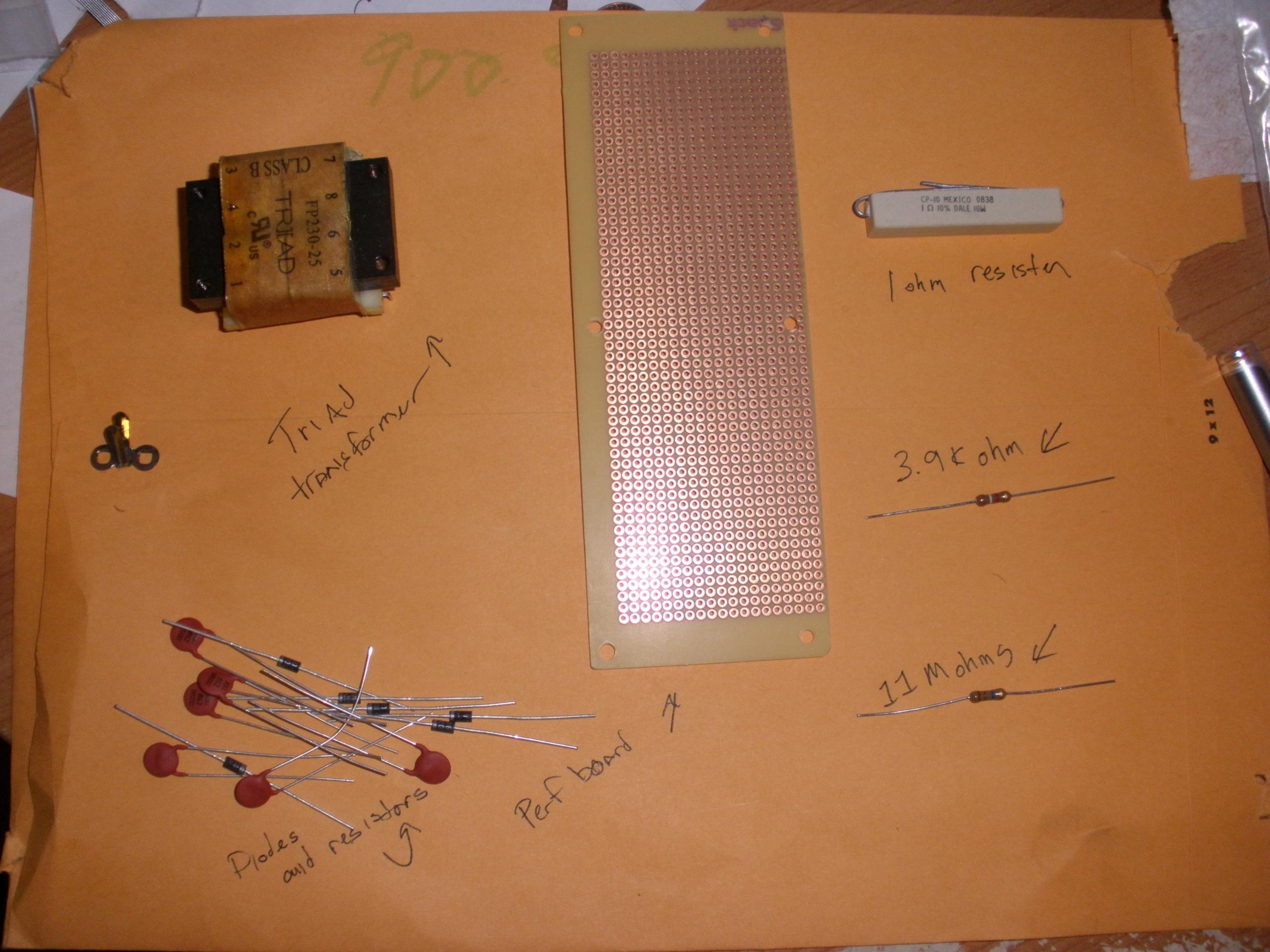

here are a few pics of the step up that CharlieM and built. PIc 2270153 has all the parts needed, you can find the souce @ jazzman-esl-page.blogspot.com . pic 2280164 is the finished top version, Charlie has built the top one, alot better than mine. Fuse holder-tranfomer-resistor-diodes-took about twenty minutes to make and cost 50usd for both.
pic 2280165 shows the solder joints made the you can compare with web site for a better idea if you like schematics, a pic is worth a thousand words.
To be honest, I am just so happy with mine that I want to share it, I have read the entire post and I myself did not want to start small, i wanted the biggest and best sounding, I have it now, thats my experience and it was awesome building something i am listening now as I am typing, mine are 16" by 40" stator, 1/16 d/s, 2k, 51% O/A, .0005 micron diagphram coated with Licron. You know the rest. Later, hope the pics help.
