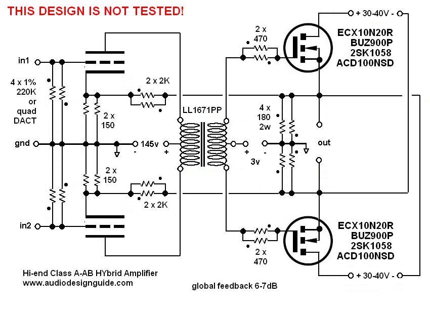

Worth to try Tube symetric(PP) driver for sure and to made some comparison listening test-Simetric drive vs SET driver.But think that symetric Tube drive configuration is more for best sound performance sensitive than original simple non GNFB SET driver.
Just think next,since you have there plenty of low impedance drive voltage/ current on the interstage Transformer secondary, you can rise the Amps out power & lower the Amps out impedance by adding more SS N Fet in parallel for Circlotron out power A class stage,(of course than PSU have to be more powerfull designed to).

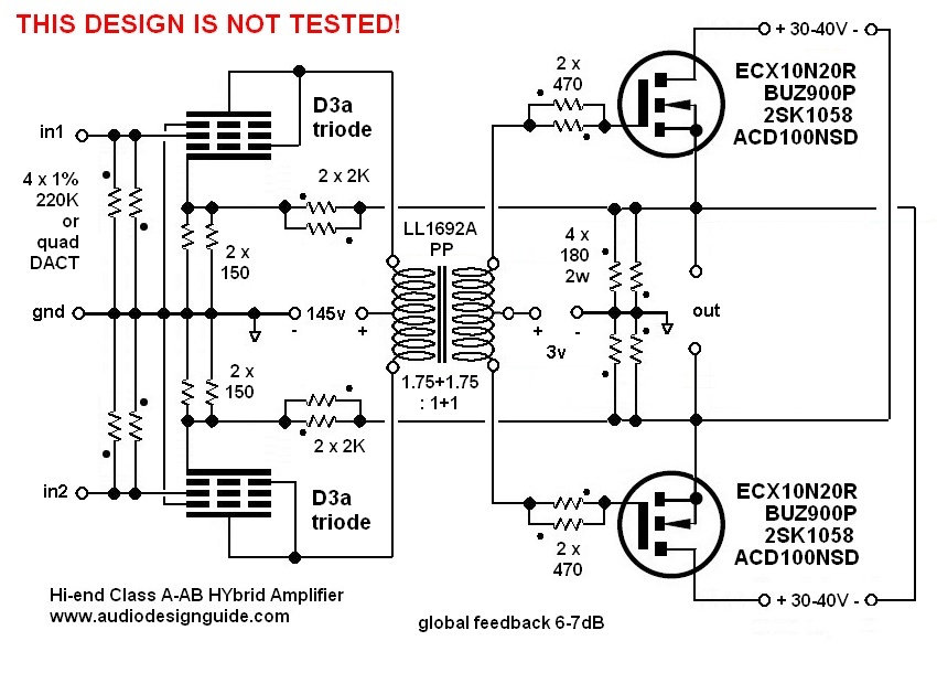

Here the last balanced version simulated with Winspice
If we want to use some feedback it is necessary use the D3a in triode connection to have a voltage stage with 70x.
It is necessary use the LL1692A instead of LL1671 to increase the primary inductance.

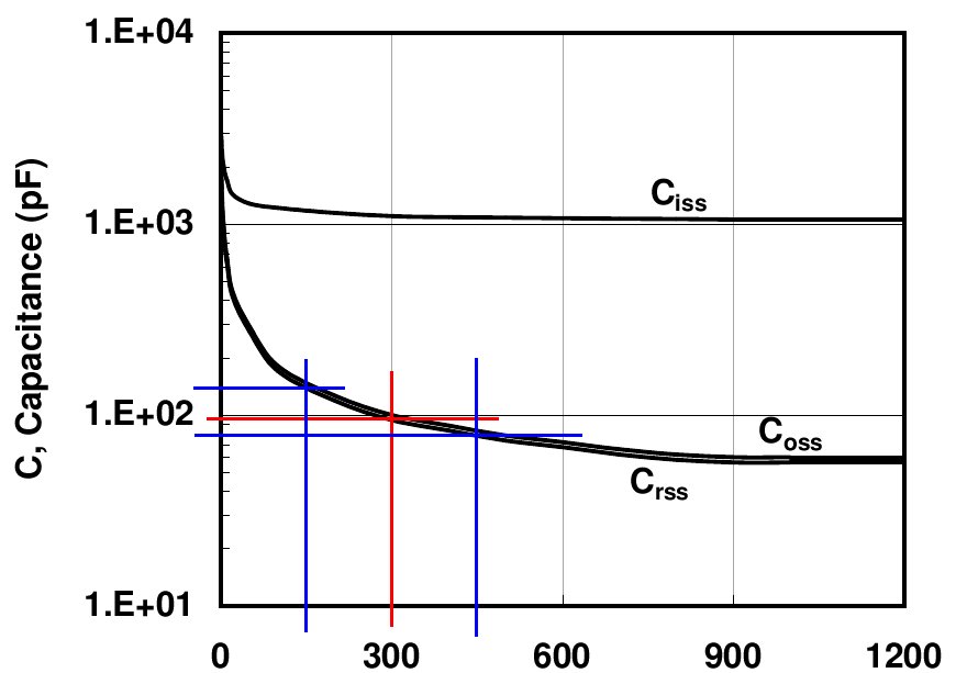

What do you think the usage for SemiSouth SJEP120R100 J-FET instead of 2SK1058?
I would avoid these in this design. Those SiC JFETs need to operate at high voltages (see attached) to keep the internal device capacitance both down and linear. At the usual MOSFET/BJT voltages, the SiC JFET has a capacitance that is enormous and nearly vertical. That will make for driving difficulties, and likely sound like
.This is an OTL design, and I would prefer to have an OPT between me and 300Vdc. Hollow state OTLs that operate at about 110Vdc are bad enough as it is.

I would avoid these in this design. Those SiC JFETs need to operate at high voltages (see attached) to keep the internal device capacitance both down and linear. At the usual MOSFET/BJT voltages, the SiC JFET has a capacitance that is enormous and nearly vertical. That will make for driving difficulties, and likely sound likeAn externally hosted image should be here but it was not working when we last tested it..
