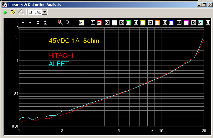

some people ask me to get higher power near to 50w so I have create a new set of measurement at 45V DC bias 1A with 3 different mosfet
The EXICON mosfet have some limits in wide voltage range.
The new entry ALFET Class-d ACD100NSD Lateral Mosfets
Mosfets/Modules - Lateral MOSFETs - ACD100NSD Lateral Mosfets - Class D
give a good damping factor and a wide linear voltage range like the Hitachi.
The ALLFET are cheaper than Hitachi.
Soon I will update the website project page.
