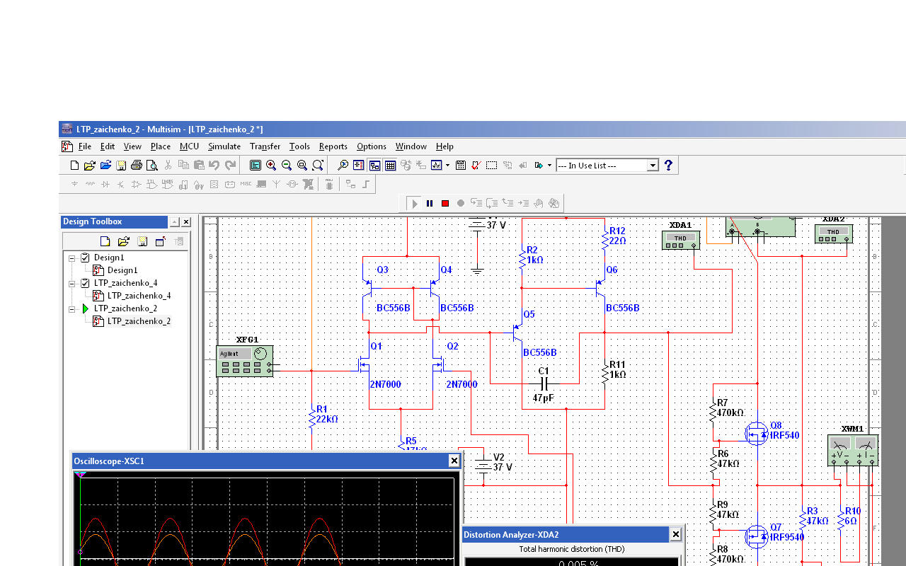

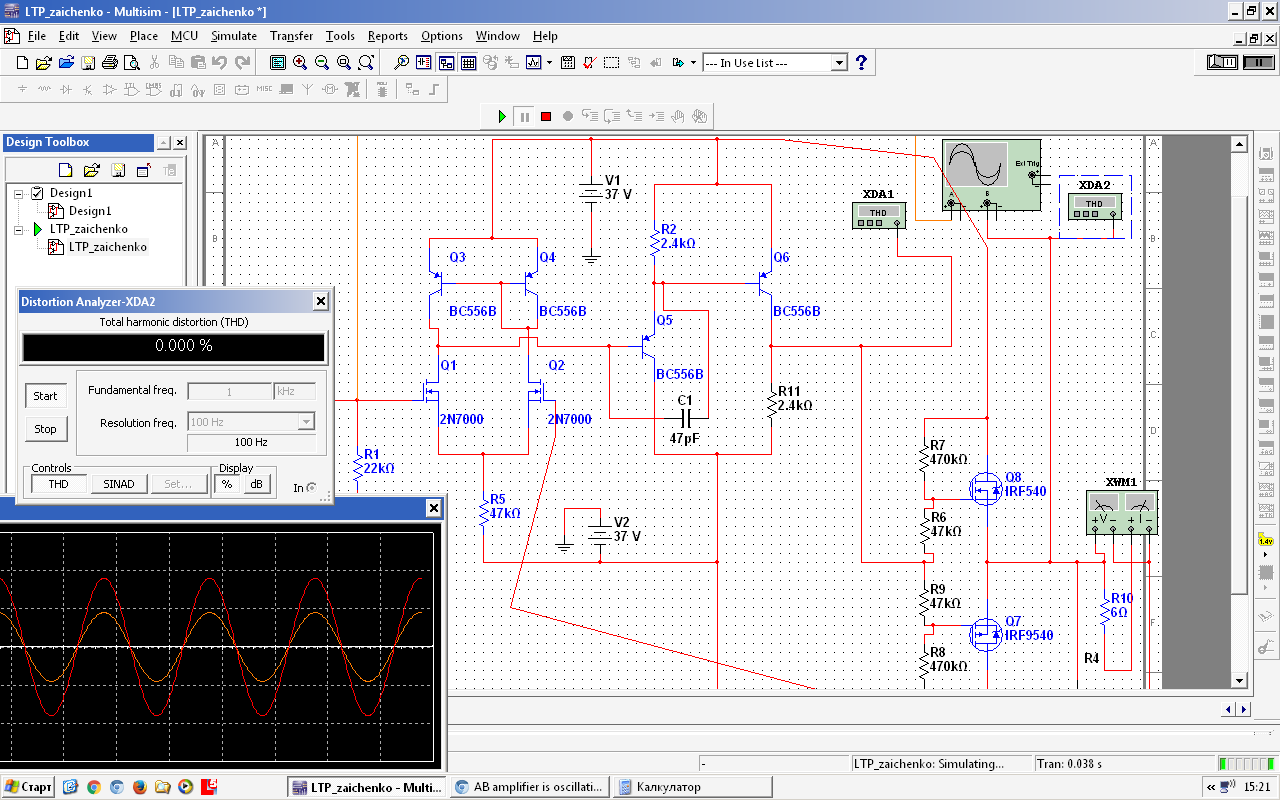

zaec, done, it works 0.000% THD
current trought R2 is abs. same as current trought R5 :O
P.S. ohh its not stable with more gain 🙁( I need more output voltage..

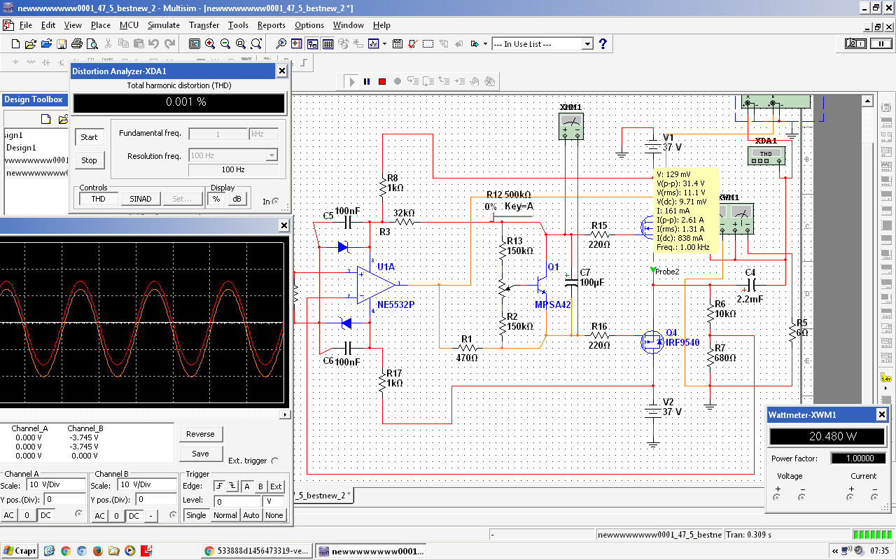

But it will be a nightmare in the real life due to many reasons. Unstable everywhere. Still very far from a working circuit, unfortunately. I can show many 0.000% THD circuits in Multisim, that will not work at all in real life.
Too many mistakes 🙂
Attached is a working circuit - one of my very old blameless front-ends. It's just upside-down in terms of npn/pnp, comparing to yours.
Note the values. And the way EF ans VAS are arranged.
Explain me what is the diff between your circuit and this -> How to design Discrete Operational Amplifier - Design Guide - Theory - Bart HRK
And also see if the info there is correct 😀

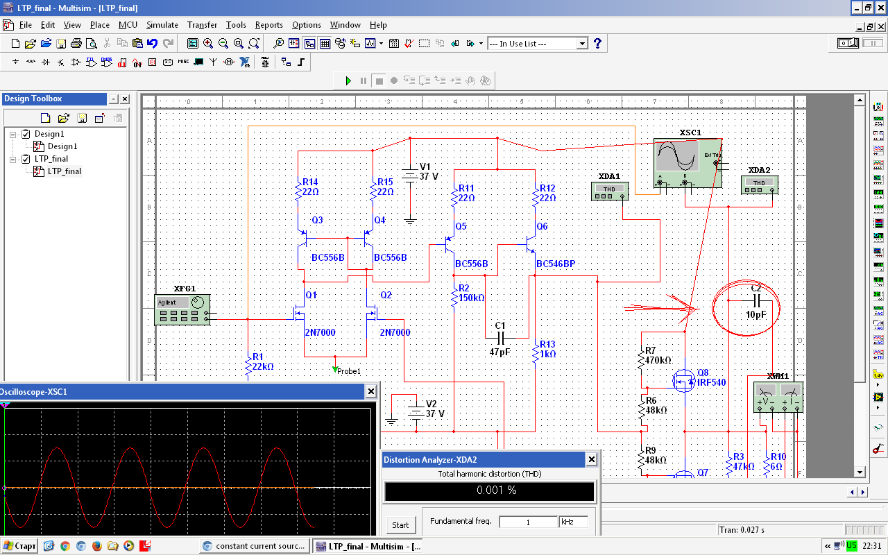

UPDATE: added a 10p shunting cap to the fb solved the oscillation mostly..
maybe if i change the fb resistors, lowering bottom resistor a bit it will be more good more shortcircuiting the HF oscills 🙂
now there is only one problem -> the voltage. Its good but its better to be higher. I havent tested with the LPF cap added..

It works vzaichenko, real life works 🙂
I havent tested a OPS yet but with phones it was very clean and nice sound !!!
I was impressed and amazed. There are no clues with it. Just perfect 🙂
With 2n7000 low power mosfets and bc546's the result is same 🙂
Ofcourse I tested on +-12V instead +-37 because MAX Vce and Vds are 60V !!!
I asked for a HV transistors for +-37V and you suggested me BC546 556 for all of my voltages !!!!

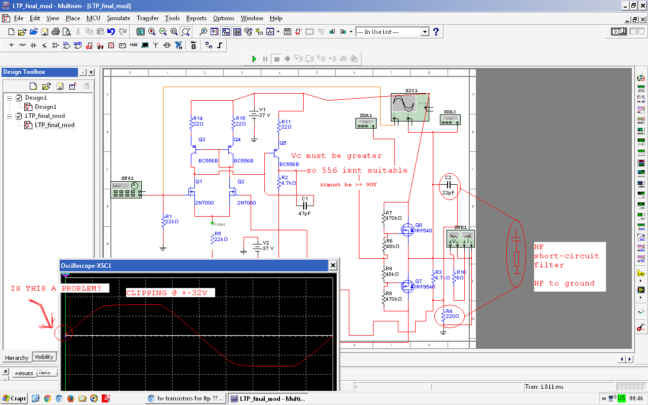

For Q5 - BC556 is not good at +/-37V as it sees the full swing.
It should be at least 2N5401.

I think A1123 and C2631 are better than 2n5401 ?For Q5 - BC556 is not good at +/-37V as it sees the full swing.

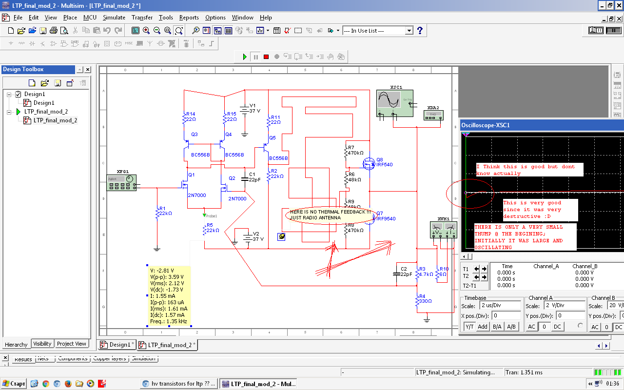

You wrote in your schematic
And yes to "Do you speak english?"
And Yes to "are"
all/most of your schematics are bonkers. You don't have much of a clue of how amplifiers are supposed to work.
That "final" schematic is just bonkers.HERE IS NO THERMAL FEEDBACK !!!
JUST RADIO ANTENNA

BC546/556 will cover all your voltages.
On the other hand, you can cascode the collectors with some high voltage transistors like 2N5551/5401.
