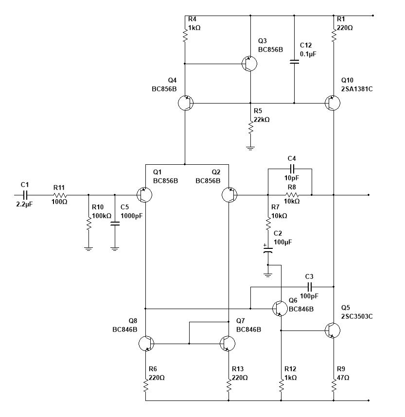

Attached is a working circuit - one of my very old blameless front-ends. It's just upside-down in terms of npn/pnp, comparing to yours.
Note the values. And the way EF ans VAS are arranged.
Just make R7 = 1.8k, R8 = 47k for your purpose - this particular one was used as a line stage with gain = 2. Just noticed...

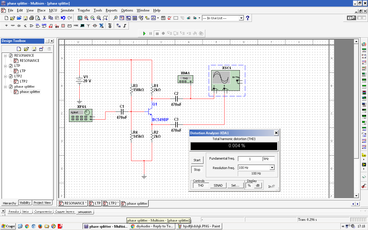

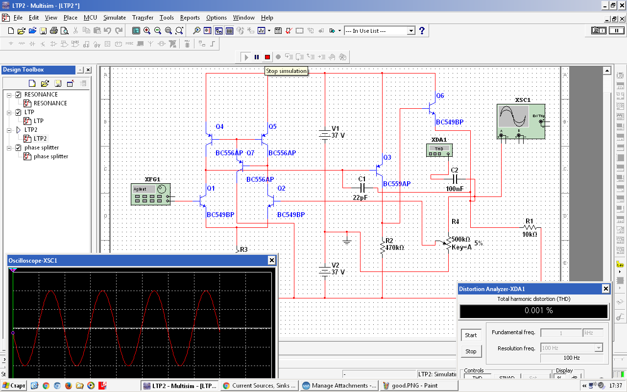

thanks, do you know why a simple phase splitter like this yields such a distortion ?
Single transistor is not that linear device by itself. So, the distortion is THAT LOW because of the deep local feedback, that, however cannot eliminate it completely.

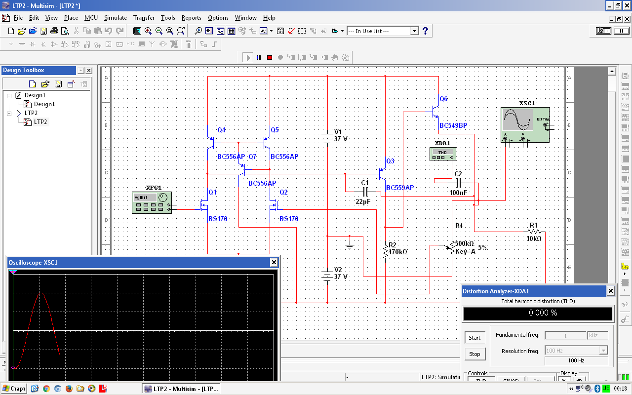

Ok, thanks, i planned to do amp with both npn fets at the output stage without any feedback, i think there would be no crossover distortion if fets are same - both n-channels.
Thats why i needed this phase splitter..

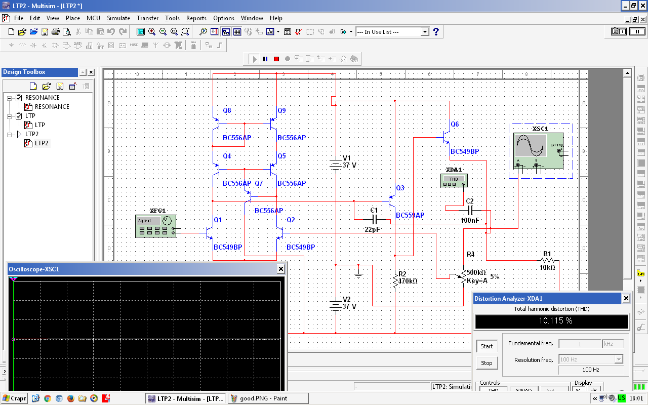

P.S. see attachment it didnt worked with quad transistor current mirror :O

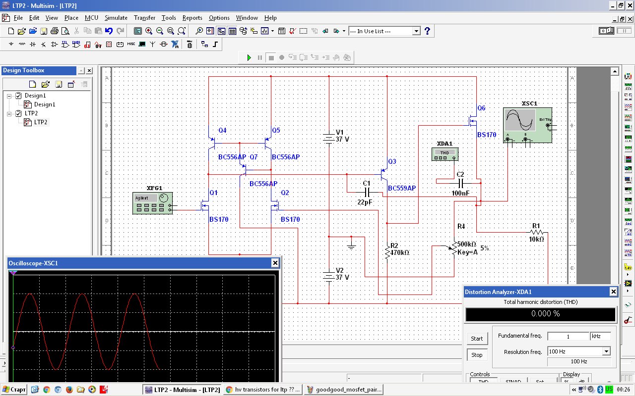

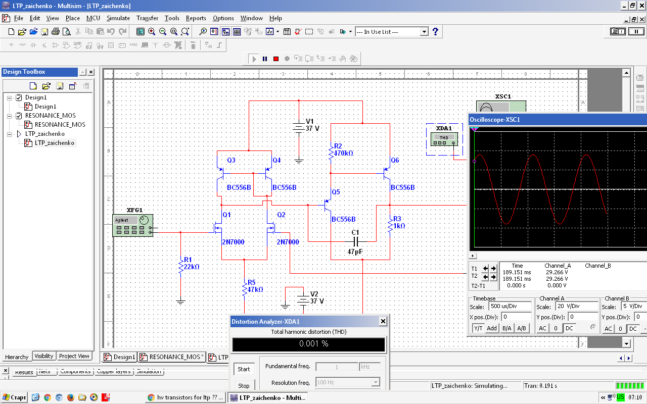

Hey, I achieved 0.000% with just using a BS170 for the pair.
pair of low power mosfets. same circuit 🙂
added second picture with a fet instead Q6. same performance 0% THD
im confused here what to use 🙄
thinking about a mosfet current mirror too

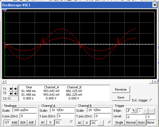

I managed to get it better with 220pf cap but its with a lot of distortion 2%..Another strangines, oscillates when I attached a sample output stage, note that the output stage is for illustrational purposes only . there i sno thermal feedback 🙂
There is no problem with the fb attached locally.

You seem to be unable to read and copy a sch.
Sort that first and then try to input the correct sch into your simulaton package.

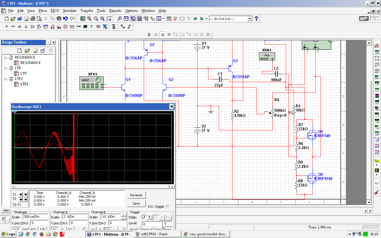

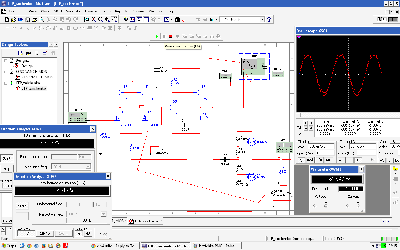

I tested with an output stage and it works only with a cap between last stage of the op amp and the OS (output stage).
resistance to ground of the OS is 200-300k.. I loaded the op amp and min resistance it could handle is 47k, so 200-300 is far far away..
I need it without cap because I need DC offset to control fets more better.
I tested with local fb because simulator gives me convergence issue, ido not know why.
Actually it starts when change the fb but look @ 2nd attach.

vzaichenko, is your circuit at post #17 your preferred method for biasing the cascode? Do you worry about about zener noise with this arrangement?
Post #17 is not my schematic - it's just the one I quickly found on the internet to illustrate what the cascode and emitter follower are in a "blameless" topology.
However, this kind of reference for the cascode - a zener, shunted with a capacitor - is ok. In many cases, you may get more noise from the input pair itself. It can be a concern, if you design a microphone pre-amp, or a phono stage. But in a power amp with 29db gain - no problem.

Those circuits - although they look like working in a sim - will not work properly in practice for so many reasons that I don't even want to start naming them.
Do you realize, that your output pair is biased to the quiescent current of around 1mA and this causes a huge crossover distortion?
Same with the emitter follower (Q5) - current through R2 is a couple of uA, so its collector current is fully dependent on the base current of Q6, which is not good at all. R2 is so huge value - it does not really influence anything there. Degeneration - another great tool - it's actually a local feedback, increasing linearity and stability and making particular cascade less dependent on active parts' tolerance. But you need to know many other things to really understand why this is the case.
In order to choose the transistors operating points properly, you need to know many things you don't seem to know yet. Take me right - I'm not criticizing, I'm willing to help, but in this case, in order to explain what is wrong, I need to start from very basics and then go through a number of electronics engineering disciplines (normally takes a year or two in the university 😛).
