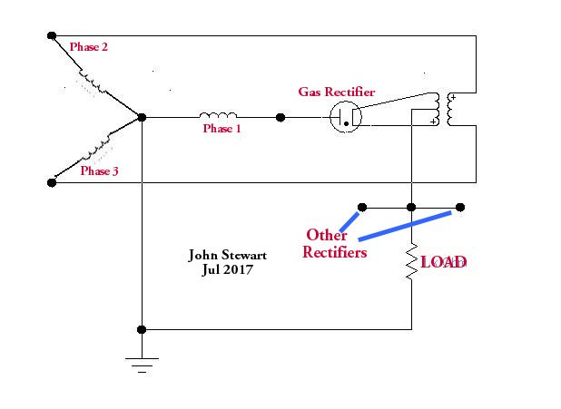

Most industrial installations are 3-phase, in which case the heaters are powered by the quadrature method.
That subject is well outside most of DIY. But I will post something later to cover that.
When I was much younger & still had hair & teeth I spent a couple of years at Ferranti in Canada in the transformer section.
The transformers were mostly 3-phase, the size that ships on a railway flat car.
The schematic shows the Quadrature heater connexion for gas & Hg rectifiers in 3-phase AC to DC conversion.
Each of the phases is 120 degrees apart from the others,. The voltage across the ends is root of 3 (1.73205) times the leg voltage.
With this hookup to the heater transformer the power is applied in quadrature to the HV to be rectified.
A commons 3-phase setup would use six diodes, The max current is delivered at the middle of the heating cycle.
The result is each of the diodes is able to deliver a larger current then possible in a single phase circuit. 👍
