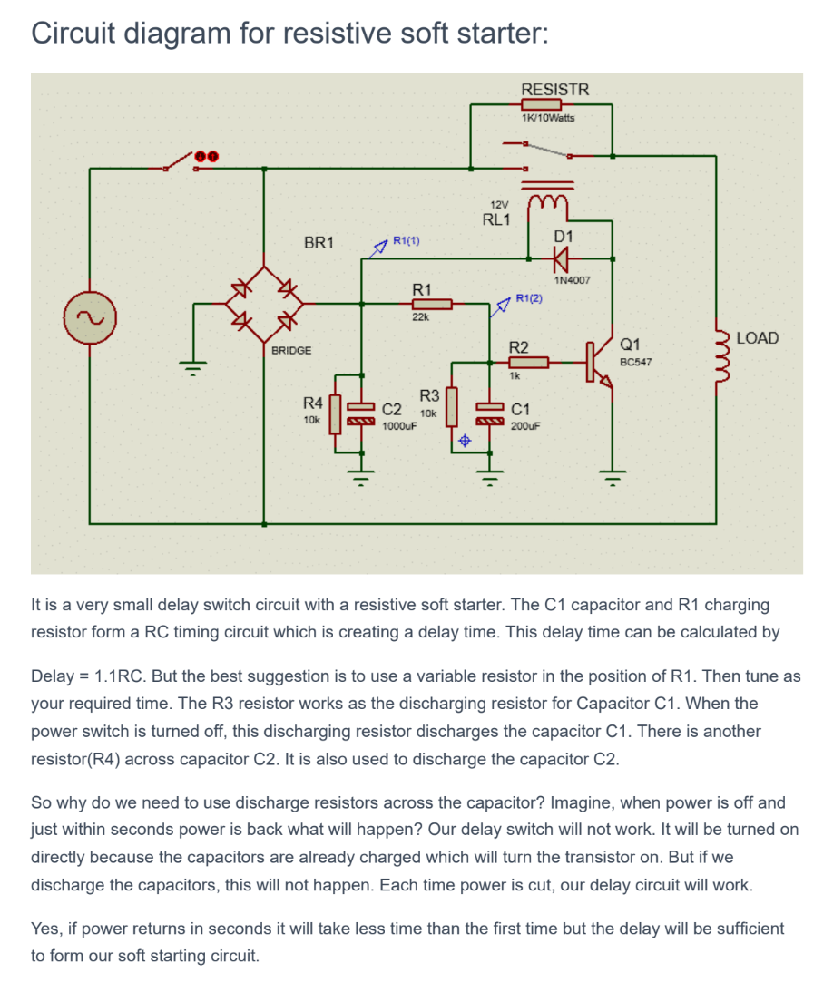

If you have a separate filament winding available... Maybe adapt this delay as a soft start (play with the 10W resistor value) or to just delay HV completely at the primary of the HV transformer by omitting the 10W resistor? A simple RC delay with few parts that can fail over time. Overrate Q1 and use a high-quality long-life C1 and a not-cheap relay and a fixed resistor for R1 and it should be ultra reliable, no? An NPN used in this way is statistically more likely to fail open not closed (if it does fail), further protecting the 83 as the relay wouldn't close if Q1 does fail.
I run 866A MVs with their separate filament transformers coming on at start-up. 120 seconds later an octal Amperite NO relay switch closes and supplies mains voltage to the PT. Works nicely and is simple to implement. If I need to condition a new pair of 866 tubes I just pull the relay and let the rectifiers cook away for 30min.

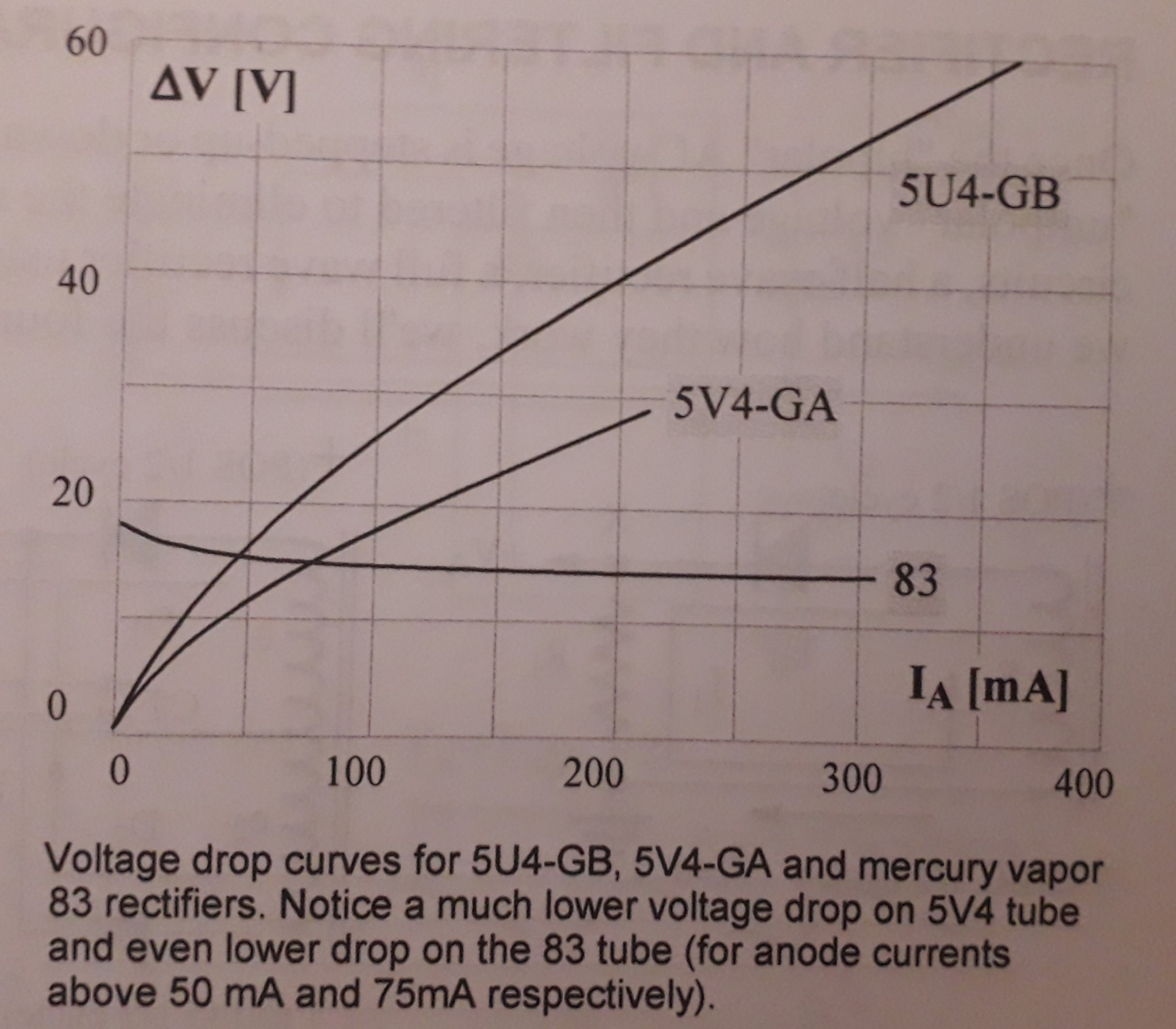

Does it ?Lower voltage drop means lower intermodulation distortion.

Notice how constant voltage drop is on 83 MV with increasing load.Does it ?
At high power levels 83 compared to other tubes, will keep the supply voltage more stiff( the voltage will not sag so much being a low drop voltage tube). Any amp at its power limit generates IMD. An amp with MV at this limit generates less IMD.
No delay required, the 82 & 83 were designed from the ground up to function without waiting for the filament.
