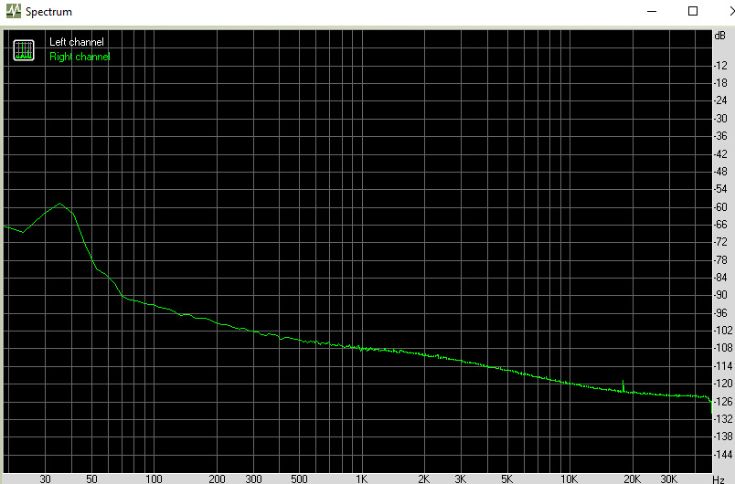

I followed your advice and tried several changes.
Picture below shows what happens when changing the 4 feet under the motor housing from the standard hard rubber to soft felt.
For the 250rpm motor the difference is not too different, but for the 500rpm motor the 200Hz component went down to a level only 3dB above the 250rpm motor, a huge step.
I also recorded the noise with motor off, and as you can see, the peak at 25Hz, is caused by the environment.
Doing the same test late at night, this peak will drop 25dB.

That seems consistent with what I measured: The higher power the motor, the higher the vibration regardless of the number of poles.
With the Hurst motors I had, the 300 RPM version was higher power; with yours, the 500 RPM version was higher power.

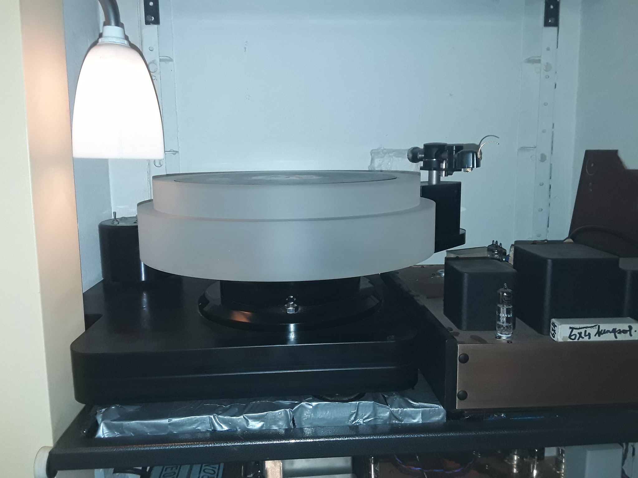

Hello,
After trying to get in touch with Teres to see if it would be an option to use their rimdrive for my partly diy and being left with no answer i come across this thread.
I already asked Pyramid in a personal message about using the Sota total eclipse package and he said it could be done if it will be possible to get the Sota unit with a bigger pulley so i wrote an email to Sota to find out if it is possible.
My turntable is in fact a standard Scheu set up with a larger diameter platter to create more flywheel effect.
the string will run on the upper part where most of the inverted bearing is but where the diameter is still bigger than usual.
The Scheu unit is attached with nylon bolts two two pieces of pom material which are partly filled with lead shot.
The Scheu motor unit stands on top of the pom plate. When using the Sota motor unit i can make a circular housing, ( filled with lead shot or just a big '' chunk of lead) and decouple it from the pom by using one of the products in the link. I thought they would be hard to find but i found out Mouser is selling them. O think it will be possible to create a motor housing with the right weight and with the right dampers it will function very well.
Greetings, Eduard
P.s maybe it can be possible to machine a rim identical to the one used by Teres ( the rubber ring is a well available product in the USA)

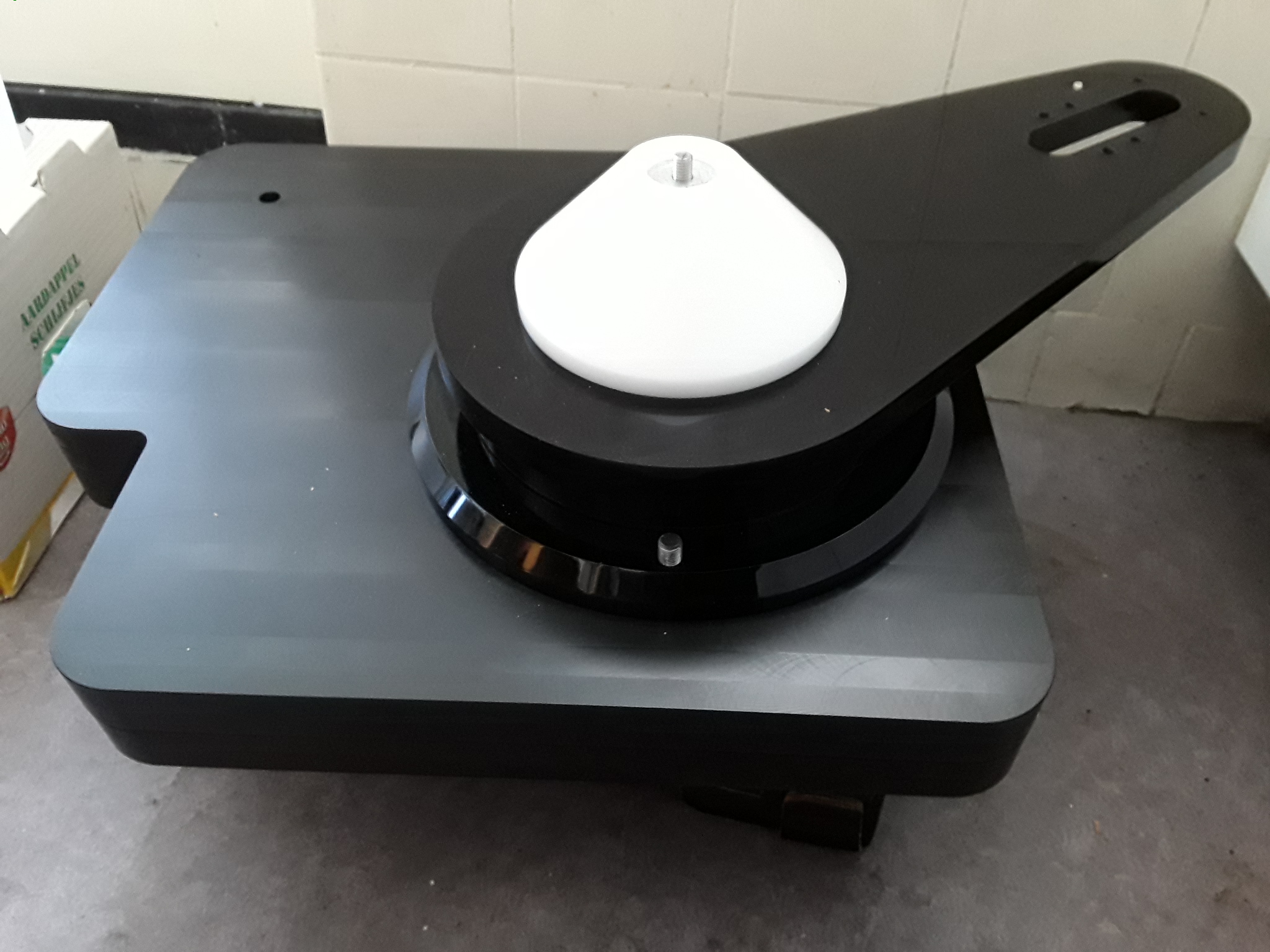

That’s right Edw
I am very pleased with my BLDC rim drive Edw.
It has nothing to do with the noisy and vibrating Hurst Motors. My Avenger reference‘s performance, dimensionality, detail, dynamics, accuracy and timing has reached unbelievable levels.
At my case the performance was further improved with the high biased Class AB amplifier and the linear power supply both made a very noticeable sound difference.
Surprisingly I have experienced the same improvement at my Brinkmann Balance. The tube Ront power supply made a very noticeable sound improvement.
Also By replacing the RIM drive flywheel with a center belt pulley I am converting the drive into a belt one within seconds. But I prefer the sound of the rim drive.
I know that a number of Avenger reference users are looking to convert their rim drives into BLDC too
I totally agree with your statement ....silence is bliss....
Can’t thank enough Bill Carlin....

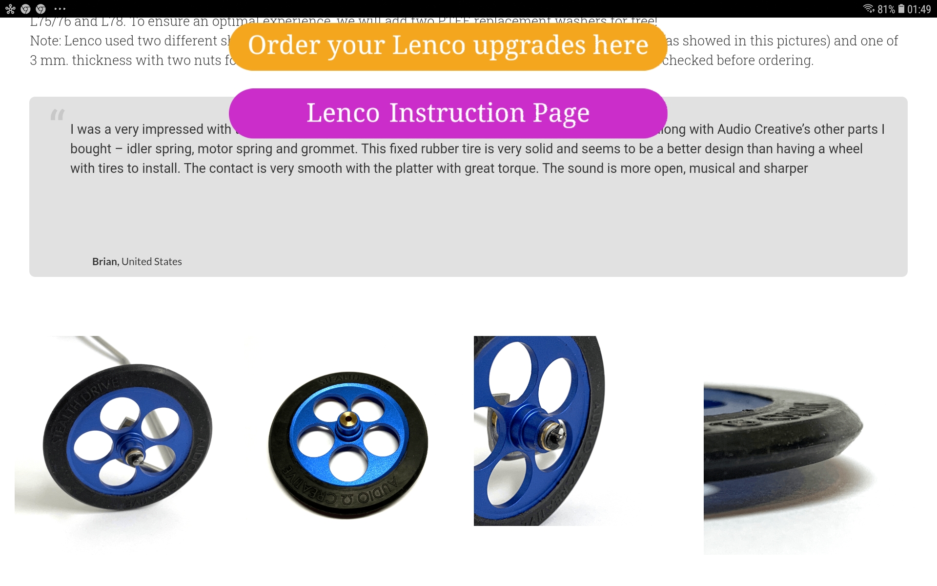

Hello,
Rim drive sounds like a nice option if you can find the right rim. Maybe this one?
Lenco refurbish and restore - Audio Creative Shop
And you will have to change the speed from the motor which could be difficult.
Greetings, Eduard
