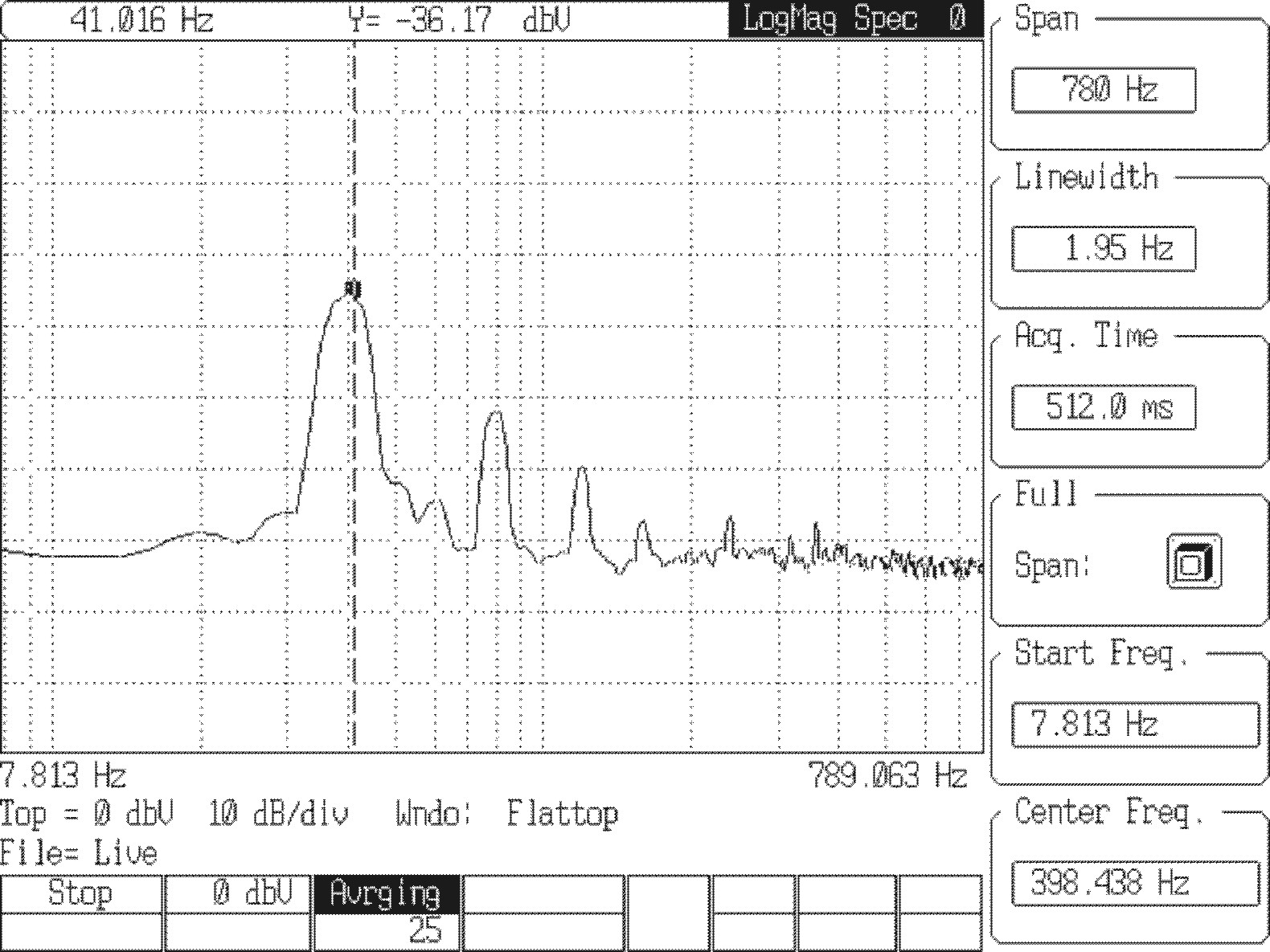

Hans-
The plots below were made with the same 5.5W 600 RPM motor in the same SAMA housing with the accelermeter located at the same point on the SS ring of the housing, with pulley attached but no belt (or platter). Adding the platter to the equation seems to reduce the vibration levels about 3dB.
The first plot is with the motor driven from single phase wall power with factory phase cap; the main response is at 120Hz (cogging) at ~-52dB.

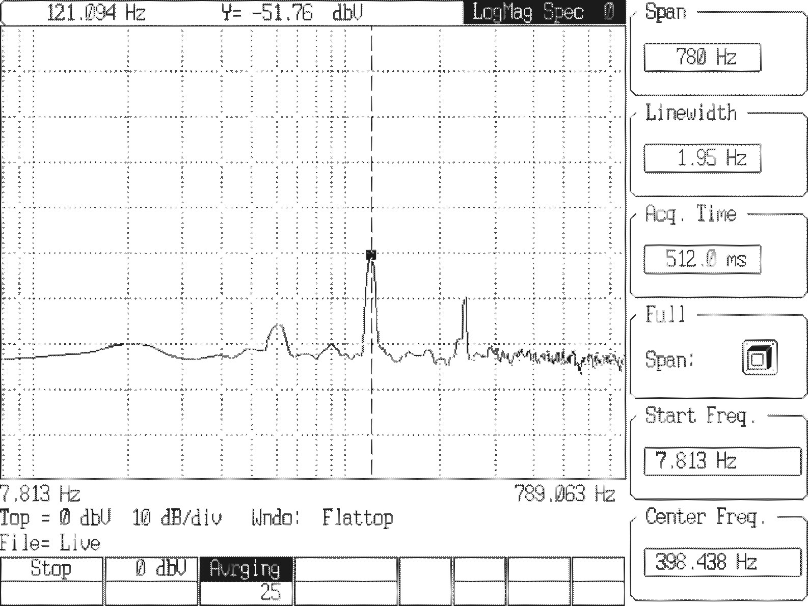

The second plot is with the motor driven from a dual phase supply set to 90° phase offset and full voltage. The cogging response is down ~9dB.

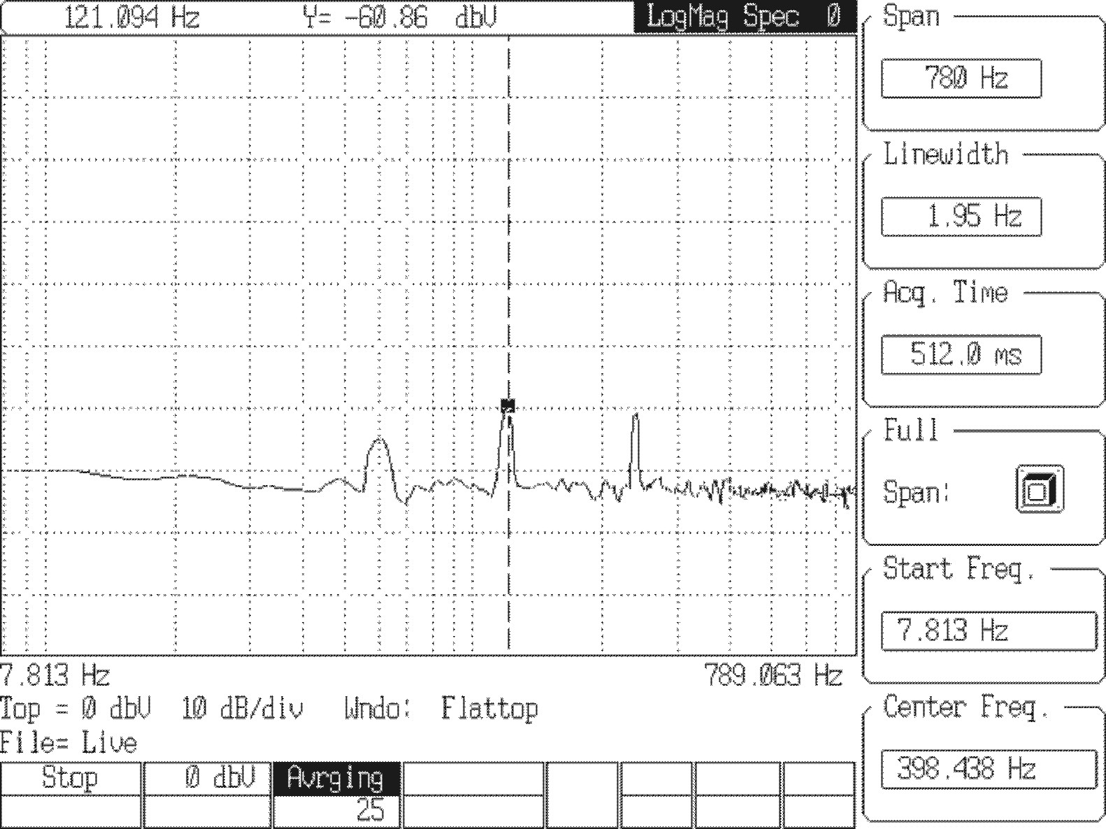

The third plot is with dual phase drive, but the voltage reduced to 90VAC. The cogging response is about the same, but the motor started vibrating at ~40Hz at a level of -36dB. The response at 60Hz also came up dramatically at a level of ~-52dB. This got worse the lower the applied voltage was.
The motor has the brass collar on the shaft and in the past, I was able to reduce the random vibration that seems to occur with these motors, but it is mostly hit and miss. YMMV...

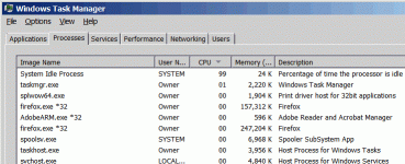

The edit-box runs on *your* computer. Ask what else your computer is doing at the time.
In older Windows, "Task Manager" is useful to see which programs or background processes are chewing-up a lot of time. Windows Update can be very greedy. So can viruses.
Here's TaskMan on my machine. I keep few background processes. Jiggling the mouse in FireFox browser bumps it to 6% (but I can't get back to TaskMan fast enough to screen-grab). My Google Photo Backup pops to a few % every minute. I recall Windows Update eating 50%-99% of a Pentium. I've found viruses by them hogging the CPU.

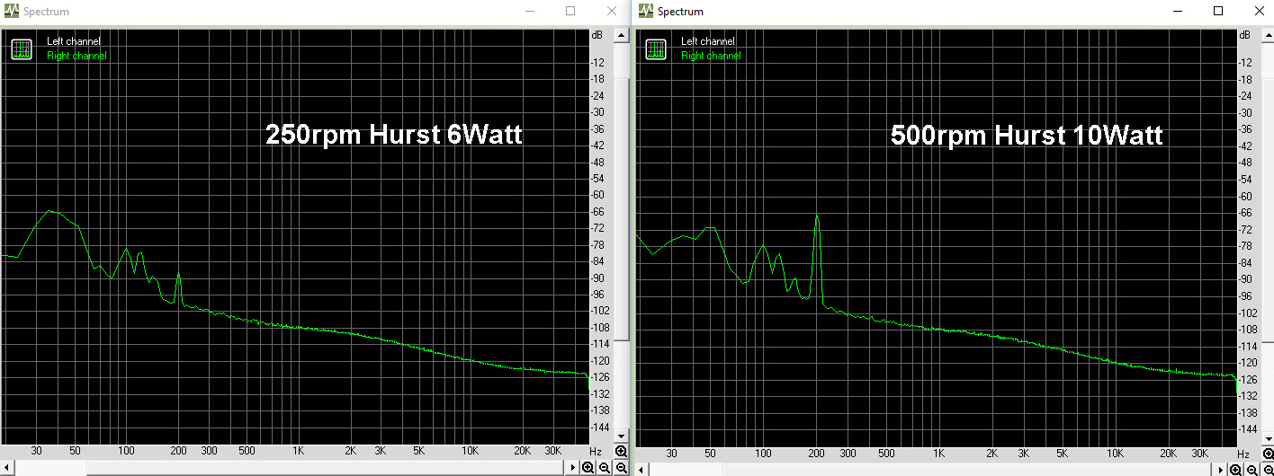

It's a while ago since you compared motors, but maybe you would like to add my measurements to your collection.
For my VPI, I have two motors, a 250rpm 6W Hurst motor and a 500rpm 10W Hurst motor.
The motor is (of course) driven by 2 phases shifted exactly 90 degrees, each having a distortion of less than 0.5%.
I have recorded through my Cart, needle on the record with the belt removed and the motor turning.
As you can see below, the 500rpm motor has a strong 200Hz vibration that is 20dB less with the 250rpm motor.
At 50Hz they are comparable and below 50hz the 250rpm motor makes a bit more noise.
So in this case I would say that the 250rpm is the better one of the two.
