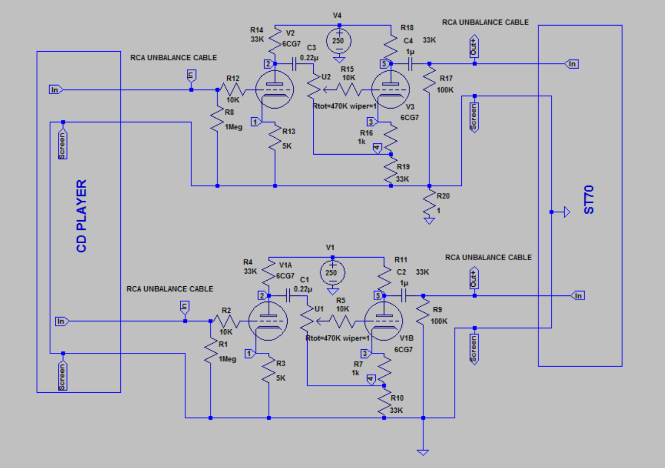

looking at the way he split the plate load resistors, could he be thinking balanced outputs?
my take is to replace that pot with a 470k resistor, then move that pot to input instead...
the last thing you'd want in any tube amp is to change operating points,
you change the signal input level, but you want the gains of stages fixed....
in my tube amp, all ground wires return to the psu last cap negative lead and
that point is the point that connects to chasis metal frame...single point star...
this worked for me all the time, my amps are quiet, no hum and no hiss...
at this point, carefull attention to flament wiring is also a must,
twisting the flament leads, grounding filament winding center tap or a vrtual center tap,
or lifting it with dc voltage bias, all these taken together helps...
and this last one takes care of the buzz...
once you learn these, then all your succeeding bulds will be a breeze....

HBRL and HBRR as the link to Dannel's article is interested I wish I could also sim the problem myself, I believe there is a difference in HBRL and HBRR and mine I already suspected ground lift the screen on both cable is not quite enough.. thanks for all the infoes.
Koo, you are not alone in not recognising the need for HBRR/HBRL.
You are also not alone in putting the added resistor in the wrong location.
Bonzai has it wrong in his amplifier wiring guide. He also has it wrong in the NX pdf build guide.
Yet whoever designed the layout of the NX PCB actually put the HBRR in the correct location even though this is different from the published schematics.
I have added added resistor in wrong place? Ya in the begin I repeat others mistake, but my later mod will catch up because I have real thing in-front of me, I believed mine have fixed both HBRR/HBRL and RCA ground loop in one go (1 ohm), and the OTL amp hum fixed, take me many months to find a reasonable solution for RCA interconnect. It's not HBRR/HBRL problem to begin with it was when I put in both RCA cable. Again your're able to differential them, good, but pay attention to the actual issue applied and don't comment beyond the core issue of RCA interconnect say from DAC player (Although HBRR/HBRL is off the issue, I still thank for the comment and help!), or do you mean they're the same problem?Koo, you are not alone in not recognising the need for HBRR/HBRL.

Chop, Have you checked for 10 ohms between the RCA jack ground side and the chassis, yet? If the original 10R on the board has the board to jack jumper then that is all you need. Adding anything else is going to create a loop.
It is not that simple. The single resistor solution is just not good. Take the example from post 14. It does very little to prevent ground loop currents, plus the input and output interconnects are parallel to the resistor. The audio signal will return via the interconnects (and PE) instead of the resistor.
You should not just insert resistors and believe all is good just because the hum is reduced. You need to know at what cost.
