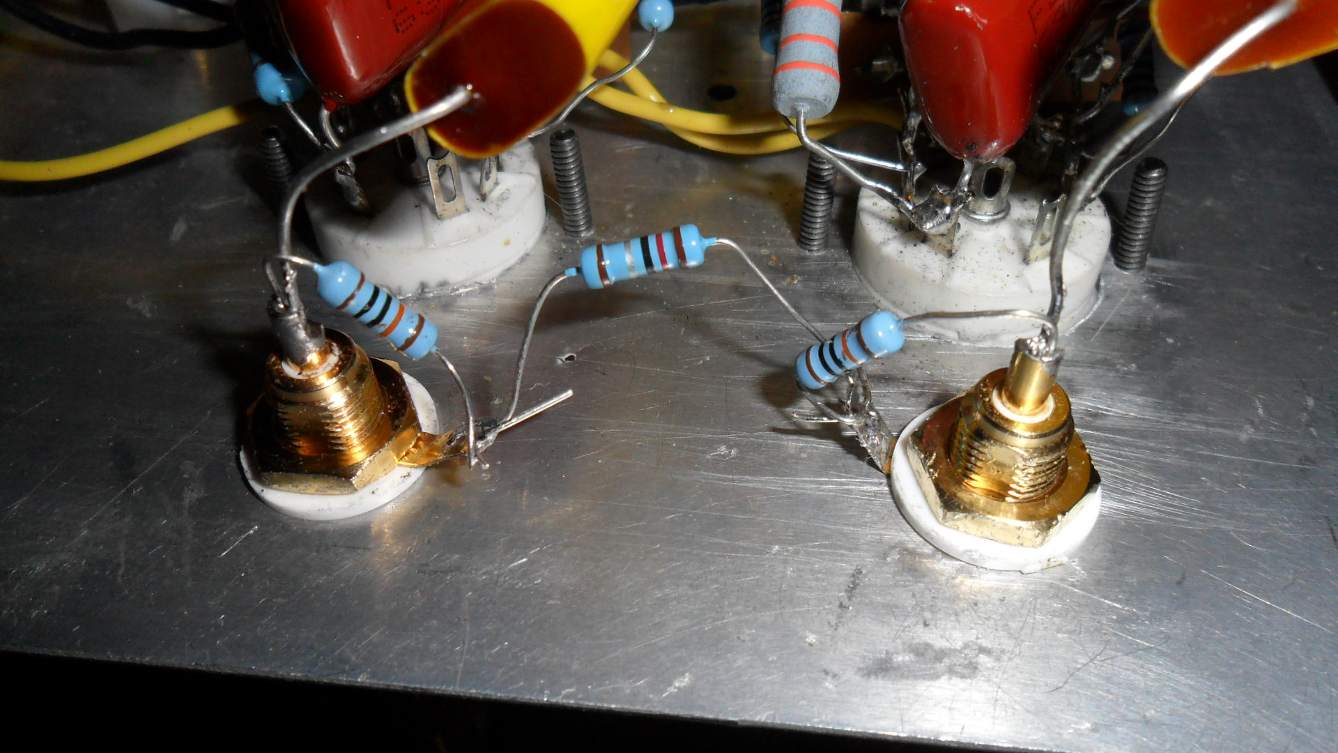

Buzz may be due to connecting into the PSU Zero Volts, where there can be large current pulses charging up the smoothing capacitors.
You are using the chassis as audio ground (non isolated RCA) or am I not seeing this correctly?

Looks like PE is not connected chassis but to 0V.
RCA's and the other grounds from post #1 are all separately connected to the chassis in a PCB ground plane style.
strip that out and start again.
The signal connection is a two wire connection.
You must have two wires running from RCA socket to your input stage.
I can only see one ! Going to the capacitor.
Where is the other?

looking at your input rca jacks, there should only be a resistor shunting the
inputs, this resistor can be anywhere from 100k to 470k, these resistors
terminate your input jack, now for the jack outer shell, there should be a ground
wire that connects to the psu last cap negative lead...
i would like to see a wire each that runs to the last psu cap negative lead...

the output is also a two wire connection.this is the output
Strip it out and build it properly with a close coupled two wire connection.

it's grounded to the chassis. you want me to ground it to acommon "star" ground? is this what you mean by "close coupled"?the output is also a two wire connection.
thanks
two wires so close together that they touch all the way along the route.
Or better if they are a twisted pair. The twisting helps cancel interference fields.
When you have the two wires separated you have created a loop. That loop is an aerial, it picks up interference and it emits interference.
The bigger the loop the worse the interference.
Your pic of the output showed a single wire. The other half of the loop must have been the chassis. That will act as an aerial.
EVERY circuit requires a two wire connection, to allow the current to Flow out of the Source around the circuit (circular route) and back to the Source.
There are no exceptions. the current must come back to the source.
Use close coupled two wire connections to connect all modules. The smaller the LOOP AREA the smaller the interference.

Not superb. Is the original 10R resistor from the ground side of the RCA jack to pcb ground missing?
are you referring to HBRR, or something else?Not superb. Is the original 10R resistor from the ground side of the RCA jack to pcb ground missing?
HBRR/HBRL only apply to multi-channel amplifiers when the source has a commoned signal return connection.
If one needs that HBRR/HBRL solution then one adds the required resistor to each channel in the correct location.
This has absolutely nothing to do with minimising LOOP AREAS.
