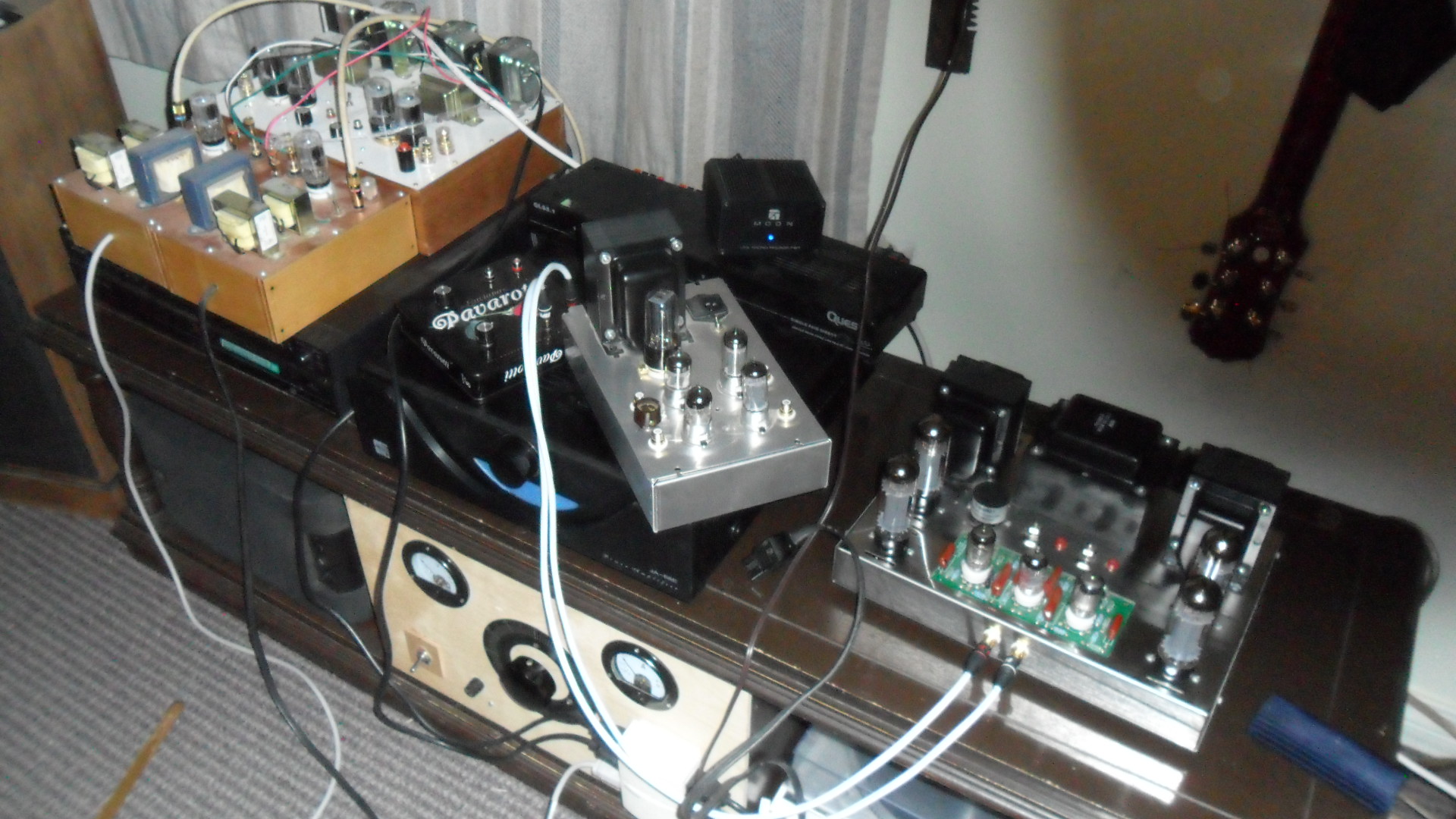

humm and buzz
i plug in the preamp to the transistor power amp and it is quite as a mouse but if i plug it into the st70 it humms and buzzes like a hive of angry bees.
any recommendations?

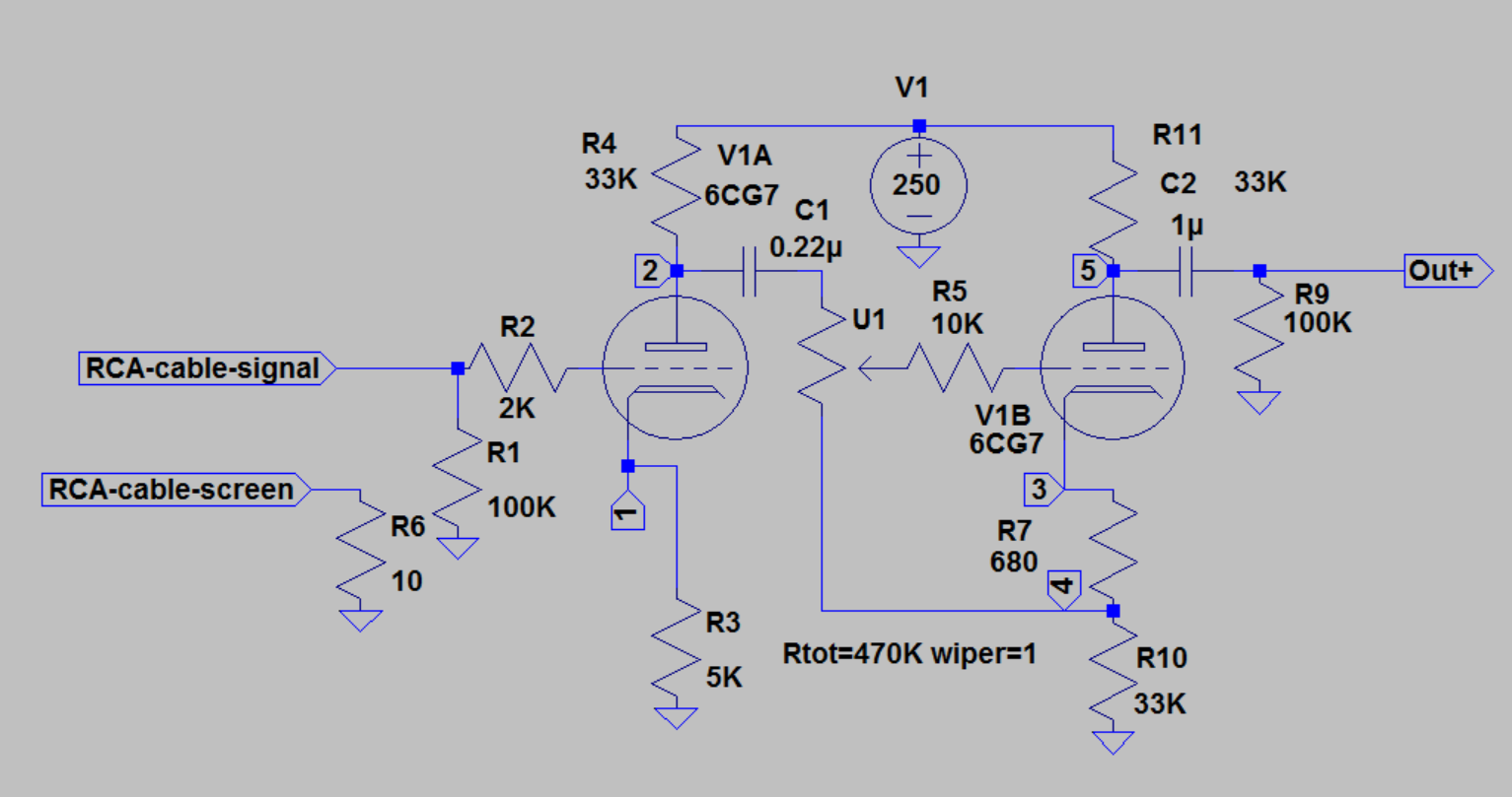

You should determine where ground loop first so you apply ground lift in that problem areas:
1) in common earth ground loop simply by temporary disconnecting the earth from either preamp or amp side. If so a isolation transformer can be used to break the ground loop.
2) in RCA cable screen ground, any hum if only plug in one cable? If so, you'll need a ground lift of 10 ohms resistor on screen signal ground and ground on both input, see attached

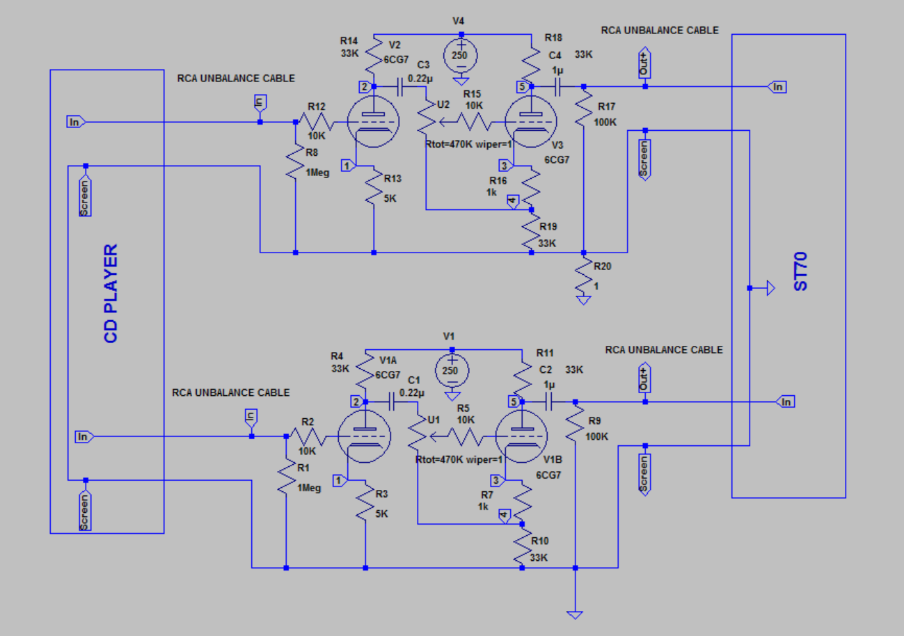

Try the RCA screen cable ground loop breaker: just add 1 ohm resistor on one channel to lift the ground. This resistor value being higher than the screen copper resistance forces the ground loop to go out from pre-amp chassis into the chassis of amp and CD player instead through it's own chassis or ground, thereby eliminated the hum and noise. I have used on my power amp and it works.

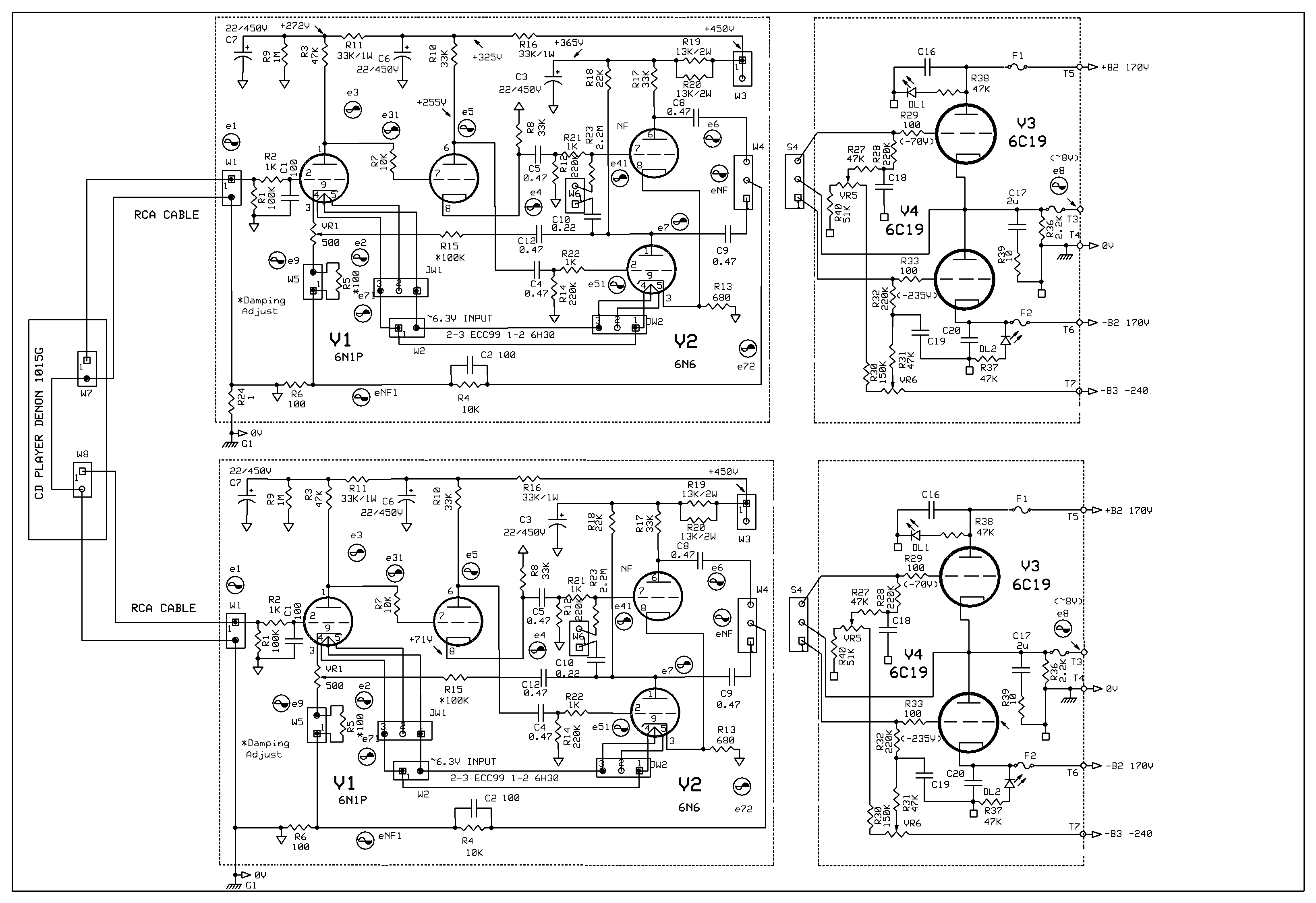

The added 1r0 is an interference current attenuator.
Fit one to each channel of the pre-amp.
Fit one to each channel of the Power amplifier.
These added resistors are referred to as HBRL and HBRR in other Threads.
These added resistors are NOT loop breakers.
They do not break any loops, the loops still exist ! look at the sch !!!!!!

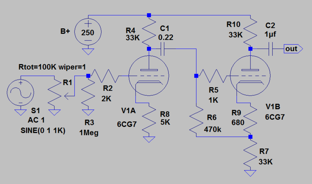

imho your preamp as drawn has flaws,
the varable pot at the second stage changes the operating points
of the 2nd stage as you turn the pot, to me this is the cause of your difficulty...
why not put the volume control at the input of the first stage instead?
this is the first time i see this preamp topology,
why not do a strarightorward Broskie CCDA?
CCDA: constant-current-draw amplifier
my tube preamps using the broskie ccda are dead quiet,
no hum, no hiss, just music....😉
why not post a picture of your actual build so as we can do away with speculations....

Ya agree, just happen to be another variation, it does change the bias resistance, it would affect bias if DC coupled. The builder is ChopChip, the sch is attached as post #1, he has vol pot in front I believe, ChopChip please you're ask to send a picture of actual build.
Ya I really mean the same. "ground loop hum breaker". I prefer to add resistor to one channel, as the ground resistance should be kept as low as possible, and this is offered on the other channel which is dead short for DC, and also for effectiveness of hum current attenuation, AC flows from high ground to low, not via visa, if go both way AC flows and so no attenuation.
Doesn't AC current just flow one way and then the other? In this case 50 or 60 times per second.
You are better using multiple resistors along the ground loop(s). Reduce the current while moving the voltage(s) to where they will do the least damage to the input and output signals.

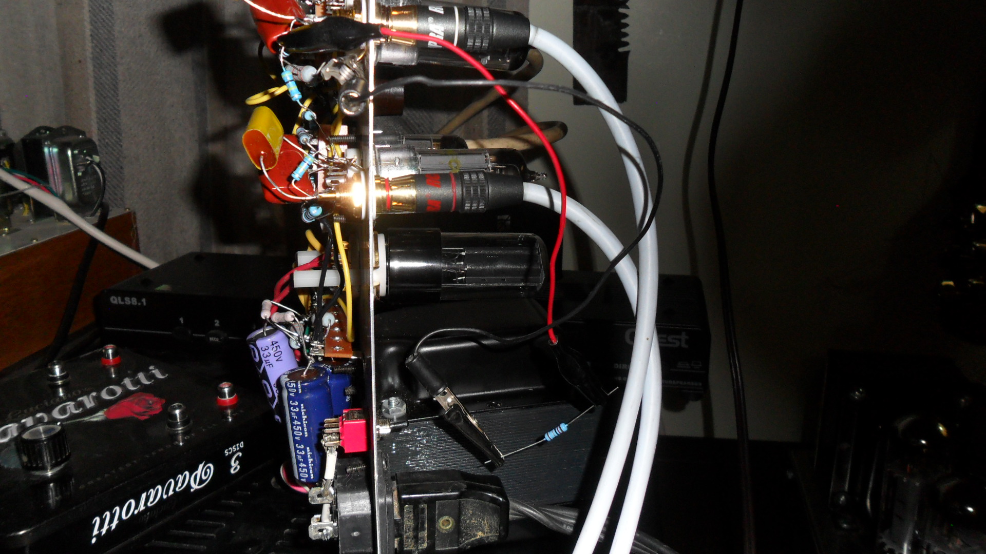

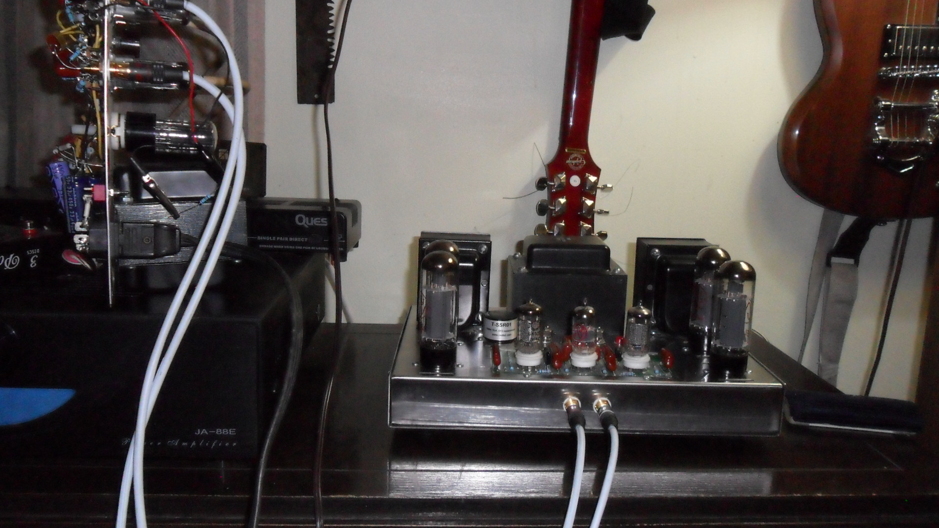

here are some pictures of the build.
i installed a 1.5 ohm, couldn't find a 1 ohm, and it seems to have gotten rid of the humm but there is still bzzz.
thanks again for the help.
