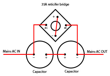

Me again, I would like to build this, to see if it will solve the noise problem (not sure of the cost of parts?). I was wondering if there is someone out there that would like to take the time to turn the schematic into a somewhat simpler diagram with parts list for an inexperienced diyer. Please see my original post for attached "Humbuster" schematic
Thanks David
DC OFF SET
How's This
"Much simpler, so I am just running one side of the AC (-) thru this"
Correct ... it inserts in the neutral line
You need to keep an eye on the bridge as it could get very hot and may require a sink
When I added the cost of putting one together with a premium outlet and IEC plus a heavy aluminium case ... I just bought 2 PS Audio Humbuster III at $150 each instead

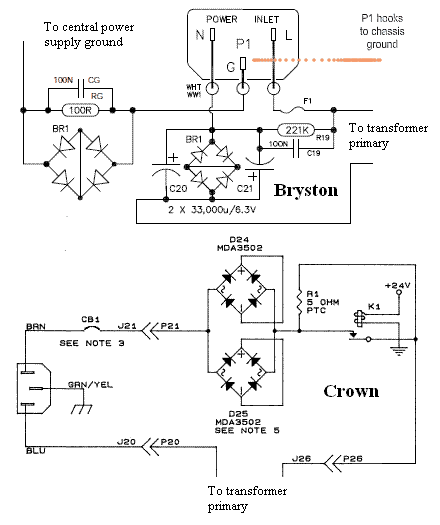

Some of the valuve's of the caps I've seen are 2200uF and 3300uF at 16v
4700uF at 35v and if you look at the attached you'll see Bryston uses the circuit in some of their amps with 33000uF 6V caps
Sorry I can’t make a recommendation .. it was my own indecisions that led me to take the safe route and buy the HBIII’s

Much, an enormous amount of very much, has be posted about the way these AC Mains supplies can have a net DC component in the distorted AC waveform.
Similar amounts of explanation have been given on why some transformers are susceptible to this form of waveform distortion and why the DC blocker can come to the aid of these susceptible transformers.
And yet I still see all the crap being repeated on what the DC blocker is NOT capable of doing.
The capacitors are the working element in the DC blocker.
To remove DC you need some ...... capacitors,
The diodes are an overload bypass.
