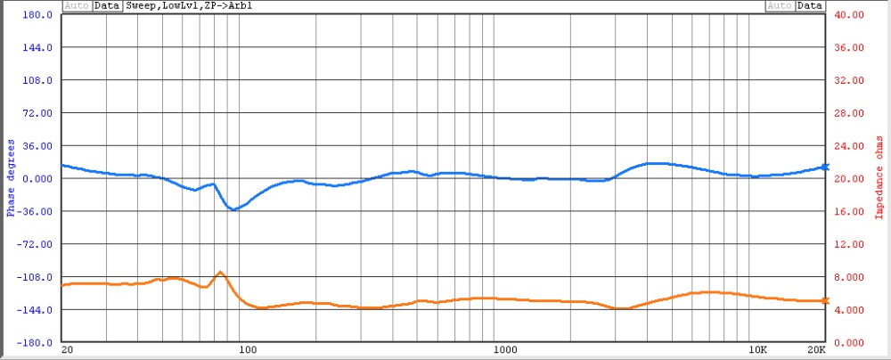

I must second the sense of 'ease' when the impedance is benign in the nether regions. A trick I have used and worked nicely in my sealed box bass 3 way, was to stagger the peaks of the sealed woofers with the aperiodic midbass, and in a manner parallel them by gradually cutting the midbass unit, letting it go low but slow. That resulted in a very 'driveable' under 100Hz impedance with minute peaking, and a bass quality, that subjectively sounds almost as free as when a TL is being driven.

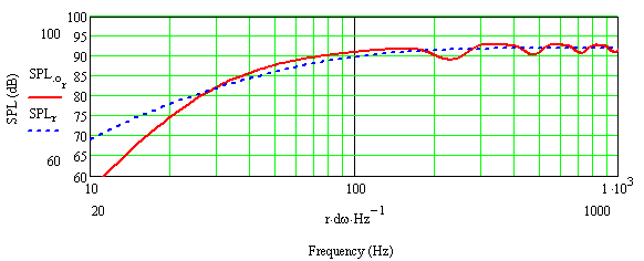

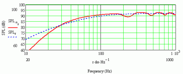

Scott:
Over the closed box of equal volume, (dotted blue line), your solution seems to yield 2 dB ripple in the midbass/midrange in exchange or a 2 dB extra sensitivity in the bass range.
Is it really worth the trouble to go through all that fine tuning the TL requires over the closed box?
http://www.diyaudio.com/forums/attachment.php?postid=1284252

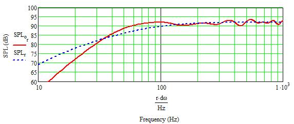

I have just discovered too late this discussion. I hope that my contribution will be wellcomed ...
After many years of listening of a prototype now I would like to have a better, nicer (and more expensive) enclosure for my TL.
In the meanwhile I discovered the Tony Gee's work with the Optimo, and since we use the same mid-woofer (Scan-Speak 18W/4531G00) it was quite natural to me to make some comparisons, ... and have some doubt.
So: if I have to spend money for a better enclosure, what is better, keep my original design or use the Optimo design ?
My design has S0=0.037m^2, SL=0.013m^2, L=0.164m, woofer offset=36.7cm (sorry if I don't use Imperials). On the line there are 300g of suffing distributed over 4/5 of the line under the woofer (12kg/m^3).
The MJK worksheet predictions are in attach.
How it sounds ? different from a BR. Bass is present but without emphasis, there are recordings full of basses where they go deep, really deep, other recordings have less basses and the basses are not "invented", like it happens with other systems.
A BR aficionado can react with much perplexity.
Me, I could on the other side emphasize the speed of the basses, and the cleanliness of the midrange.
Any comment at this stage will be greatly appreciated.
