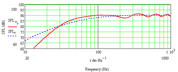

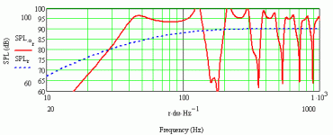

If I were to build a classic aperiodic TL with these units, personally, I'd do something on these lines, derived mostly from Martin's alignment tables.
Line 76.3in long with a ~3:1 taper. So = 74.5in^3, Sl=23.25in^3. Driver centre mounted 25.5in down from So. Should allow for the vent to be near the floor too, so you get more lift from the room. Lynn Olson noted this when he built his Ariels -the room lights up when you get the vent close to the floor boundary condition. Stuff 0.54lbs ft^3 from the top 68in down & adjust to taste / the room requirements. The density will depend on what you use for material, though differences are usually very subtle. Augsperger found some differences, though nothing I'd loose any sleep over. FWIW, I'd use an internal width of ~7.5in.

1) The midrange response between the cabinets should theoretically change very little, the tapered line being a little cleaner if anything as higher pipe harmonic modes are reduced naturally rather than needing extra damping to do it. Output from the terminus should be done by ~200Hz. In both cabinets, most of the midrange will be damped out by the stuffing / lining used in the cabinet, which is in the first half of the line, where the velocity of such frequencies is highest. Leaving the 2nd half of the line (relatively) undamped will preserve the cabinet 1st mode, and a little (but not much) of the lower mids.
2) Why would the filter have to be redesigned? I see nothing in the XO that would make any dramatic difference in the response between the two cabinets below 1KHz. Above that, the enclosure ceases to have any real function, aside from providing a solid mounting point for the driver.
Going onto general terms, a proper TL (and you can count on the fingers of one hand how many real TLs there've been) should be just as neutral as a sealed box, but with a far easier impedence curve (so for those without monster amps, it'll probably beat the sealed box in the neutrality stakes as the amp isn't having to work as hard). Most, like this, or the rough suggestion I made above, are hybrid, aperiodic lines, damping most of the driver's BW & presenting as flat an impedence to the amp as practicable, response, while preserving a little of the QW fundamental to prop the bass up fractionally -a pretty good compromise. Bailey (ignoring his misleading title) did this with his original design, and the Radfords developed from it.

What about the bass and low-mid ranges? Your tapered line will change enough of output energy in these areas and the baffle step compensation (so L2 and therefore almost all the other components too...it's a series filter!) will very probably have to be redesigned. I guess that the amount of damping material will not be suffisant to get the proper balanced sound. Personaly I would not change this loading design without preparing me to change the filter. :sad:
If you noticed, although I suggested a 7.5in internal width for ease, all I did was give cross sectional areas. You can use any width you want -all you have to do is adjust the depth dimension to keep the line CSA correct. Hardly a big deal. The original for those who don't like fooling with XOs (me included, mainly because I don't like most XOs) or a different width to the original for those who do enjoy XO tweaks. That's up to the builder. You'd have to make a change of several inches in diameter though before things became noticable. A slightly wider baffle than a circuit is designed for isn't usually audible. It's when a baffle is narrower than said circuit is designed for that things start to go pear-shaped in a big way. :xeye:
Beyond that, gain shouldn't be any different (just with a considerable reduction of harmonic nulls), you just get more extension at the bottom end.

IMO unsmoothed ripples can be heard in the bass and low-mid ranges: Besides other parameters, it is mainly these peaks and valleys that give the different sounding character of such speakers, not the impedance peak at fb or higher (except with valves amps or poor solid states which furthermore can be compensated with a LCR-network); dampening material cannot help in this matter except if very heavy.
So frequencies balance is different vs a speaker with smoothed ripples. And in a filter this needs to be corrected in an almost identical manner than BSC.;)
Ah, I see what you're driving at now. Believe me though, your English is good. My language skills are ~non existant.
Actually, IMO, harmonic ripple should not be treated in the same way as baffle step loss. A BSC circuit works by attenuating everything above the transition from 4pi radiation space to 2pi radiation space to rebalance the sound. Harmonic ripple however are actually nulls in the response. There shouldn't be anything to attenuate, unless you're hoping to reduce the gain BW -a rather odd thing to do, becuase the damping will have brought it back into line with the drivers IB response anyway (that's the entire point of using it in a semi-resonant / aperiodic line). Whatever, the XO should work fine in a different line geometry, assuming its been designed to provide the same gain as the original. The basic balance of the speaker will be unaffected. Some might miss the nulls in the response, personally, I prefer something a bit more accurate.

It is true that the difference between bass reflex and transmission line will have repurcussions above the lowest bass octave. However, the bass loading, whether transmission line or bass reflex, is at a maximum an octave or so above the -3 dB down point. After that, the port output in either type of enclosure goes down, down, down. There might be a few peaks in the TL line a couple of octaves above that if you don't damp the enclosure correctly, but that is it. The more octaves you go above the octave where the bass loading is most active, the less you will be affected.
The -3 dB down point of this speaker is 40 Hz or so.
But the crossover is at 2500 Hz. The crossover point is fully six octaves above the octave where the bass loading is most active. Whatever differences exist between bass reflex and transmission line enclosures will have have diminished to nothing by the time you get up to the sixth octave, so the same crossover should be used in both types of enclosure.
