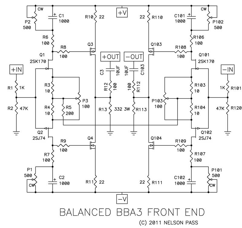

HI Zen Mod, you mean the output stage of BA-3? isn't it the same effect increasing source resistor or putting in a drain resistor and not changing the source resistor.....? I am bit ashamed not to know this....🙄🙄
look at attached Papa's (witty drawn) schematic ;
( nobody can' say that he don't have unexpected sense of humor
you can decrease gain in two , or in both ways :
- put appropriate sized resistor between drains of Q1 and Q101 and same value resistor between drains of Q2 and Q102
- put appropriate sized resistor between sources of Q3 and Q103 and same value resistor between drains of Q4 and Q104
dunno which way is more effective ; I'm always lazy to simulate anything , and my head is now even fuzzier than usual ; probably lack of sleep ....
O.k. I understand, it is the same idea you showed with changing the gain of the differential pair of j74......
That's a good tip! I will try first solution and I will take a 5k pot for the beginning.
the sense is I can partially combine + and - signal to cancel a certain amount, correct.....?😀
But isn't this a kind of feedback?😱

well
when walking on the street , on nice lazy evening , you twist your neck to see some German beauty ......... do you call that - feedback ?
everything is feedback ; even Papa's 200R resistor from one half to another is sort of feedback
edit:
don't use pot - it's hard to balance lower and upper
use fixed resistors
you can start from 1k (even 470R) and go down from that

contemplating about BBA3 FE:
now - you have famous resistor between sources
sort of current sharing SUSY setup.
you forgot , and didn't asked , that you can also implement resistors between upper drains and , of same value , one between lower drains ?
I must admit, that like Generg, I do not understand how this affects thing. This is tricky situation of understanding gain, Q-point and degeneration and how they work together?
nope ; it isn't SUSY anymore ; heart of SUSY is differential feedback around stages (looping them , if that's right verb) ; this is similar , but still more in a manner of degeneration /loading
it's called different , I think , but let Papa say what he have to say , when time comes . I'm pretty sure that he coined nice name for it
