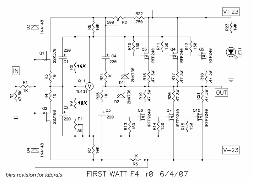

I have come upon a realization in trying to fire up the Lat version. I need a regulator with a lower Vref. Lm431LV should work. I was considering any possibilies of paralleling the the output of the regulator with resistors, but don't think it will work. Oh well. Next time I will know some things better😀
No. The Vgs on the laterals is lower for the current we need. Minimum bias voltage on Lt431 is 5V. With the laterals only takes about 2V to get a full 1A out of each. This is lower than is achievable with that regulator. The regulator I showed has a Vref of 1.25 so using it along with making the top and bottom bias resistors equal, we should be able to get our bias voltage. This almost ensures only using 1-2 pairs based on my heatsink. The only other option is a discrete regulator. Check out the datasheet for the LM431LV and also a great datasheet on biasing mosfets, including the laterals coming your way, AN1645. THis tells you a lot about working through an output stage like we are using, including finding correct resistor values.

TL431 has reference voltage of 2.5. Using the formula that is given by the datasheet, the lowest value you can get is 5V. Split two ways, this is 2.5V for each fet, N & P. This would put the bias of the two laterals at or above 1.5A each. Thats cookin!.

post exact schm you're using and I'll re-draw what's needed
I am using the F4 boards and so trying to make it work with them. The LM431 LV(Low Voltage) has a Vref of 1.25.
ya catchin' my drift ?
:clown:
now just re-calculate values to have adequate bias range

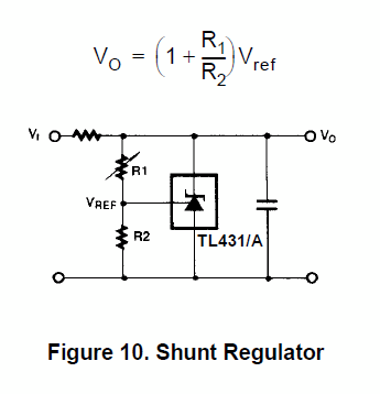

see - Vo= (1+R1/R2) x Vref ( in datasheet nomenclature )
when R1 is diminishing in value , Vout is approaching Vref value

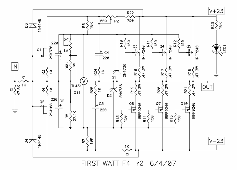

ok now - let's be serious
previous schm was drawn just for learning purposes , and now you can see what's changed to have biasing voltage across 431 in range of 4V45 to 5V0
while thinking about needed range , do not forget voltage drop across output source resistors
simple , isn't it .....

Thanks ZM. I was going to figure up the resistor values today. I don't have 18k and had planned on using another 22K on R9 and keep R8 the same. Only question was to check datasheet and see if current was sufficient for the TL part. Will run the numbers on the different options while traveling today.
