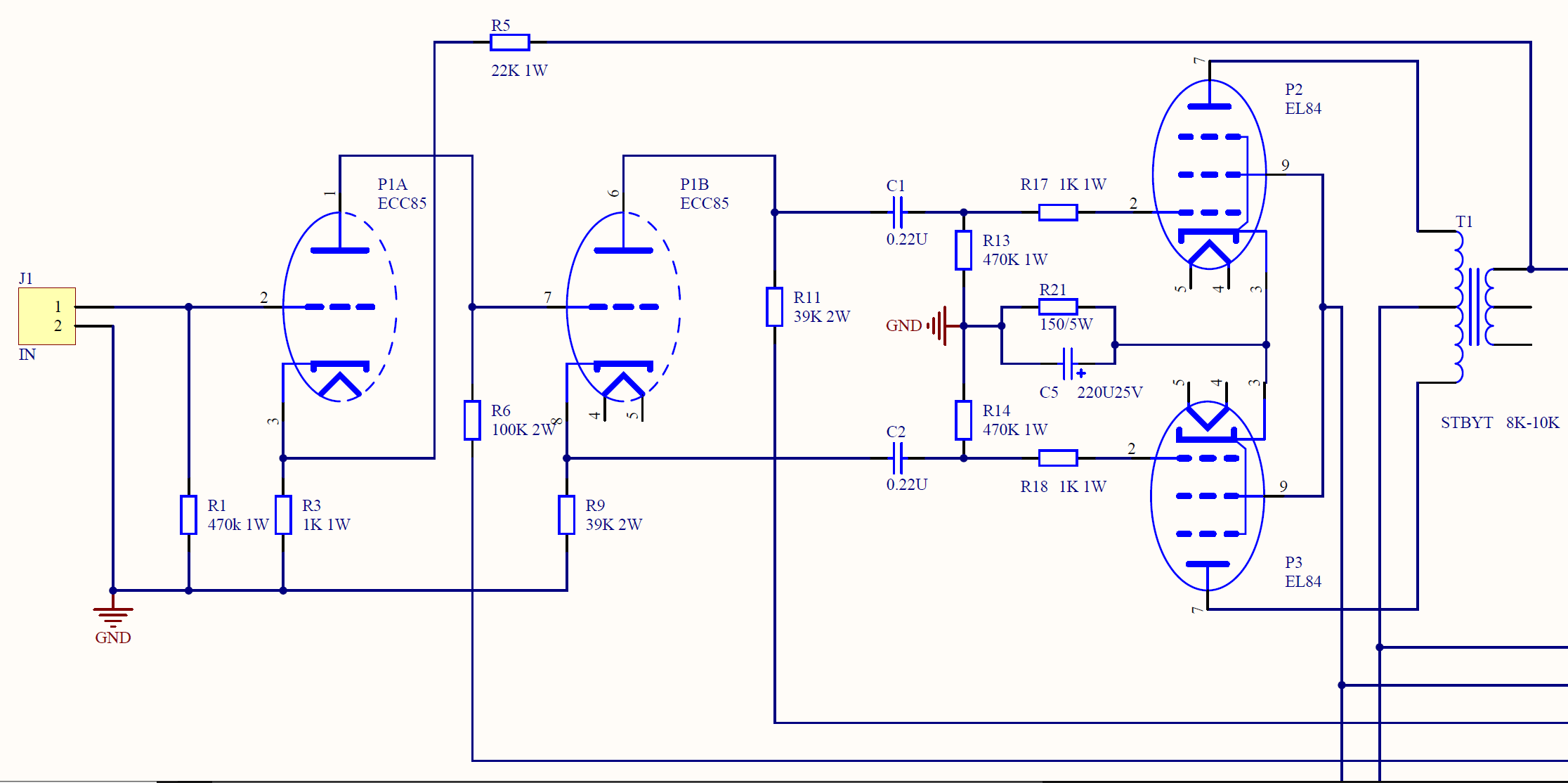

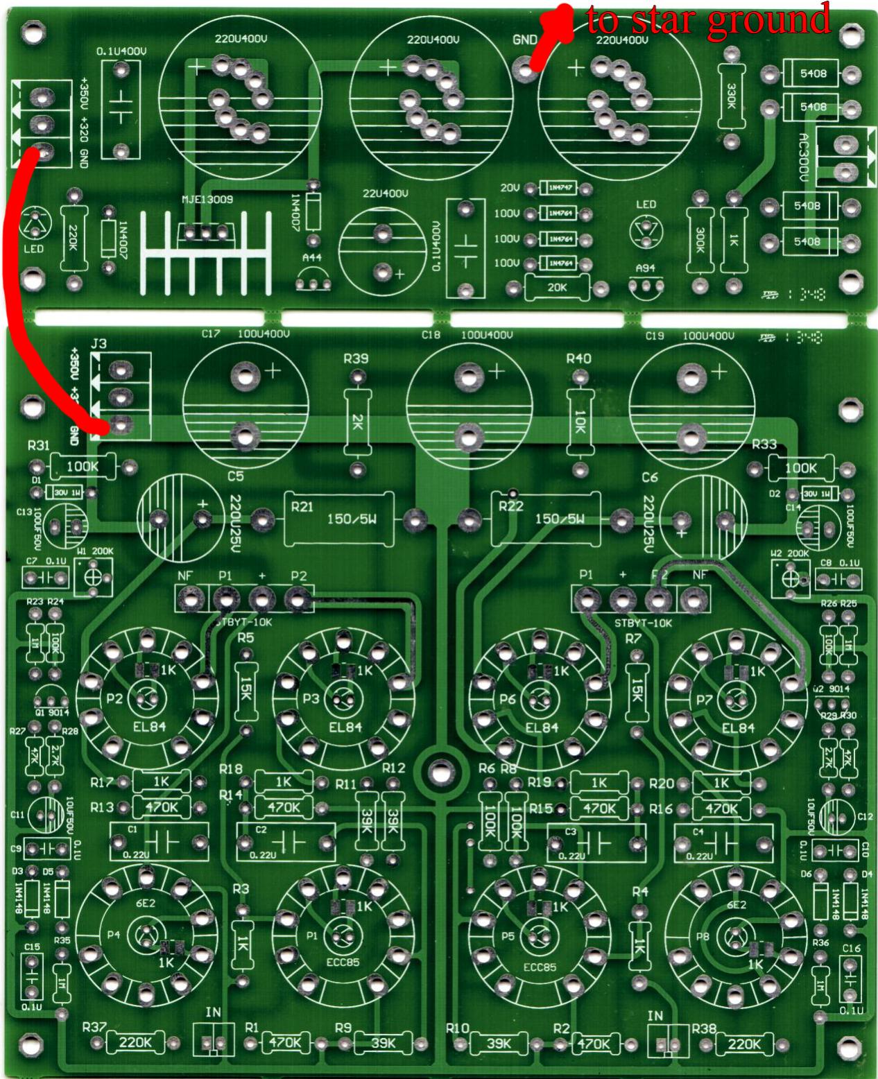

I recently built my first push-pull amplifier from a kit (ECC85+EL84).
During testing I noticed the following:
In addition to an inaudible 100Hz hum (living in Europe) there are oscillations in the same interval (see attachments). Does anyone have an idea where they could come from?
Missing grid stopper resistors?
I'm grateful for any idea.

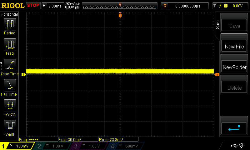

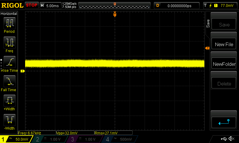

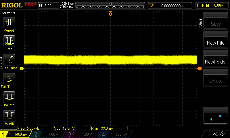

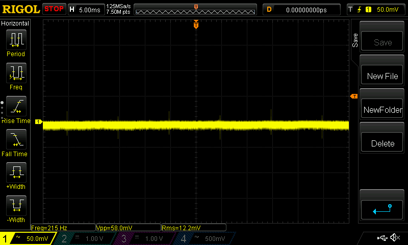

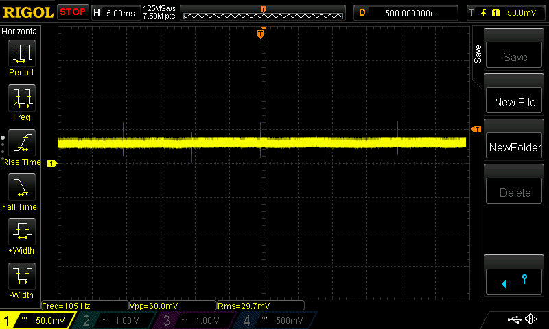

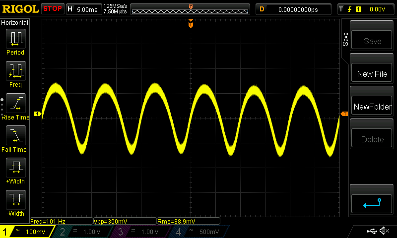

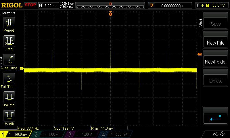

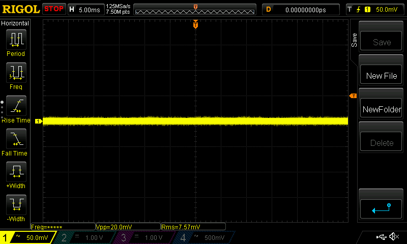

Good evening
Did some troubleshooting today. So far no luck.
The power supply seems fine to me. Could not see that kind of oscillations there. See the attached measurements/screenshots for the +300V rail (screen) and B+.
I also added grid stoppers (1K Ohm) without seeing a change.
The oscillations are the same in both channels. In the first seconds after switching on, the amplitude slowly increases. Having disconnected all the input signals makes no difference.
The oscillations seem to appear after the first triode.
I am rather at a loss.
Good evening

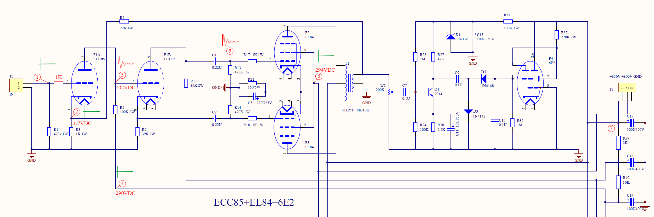

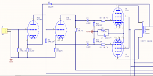

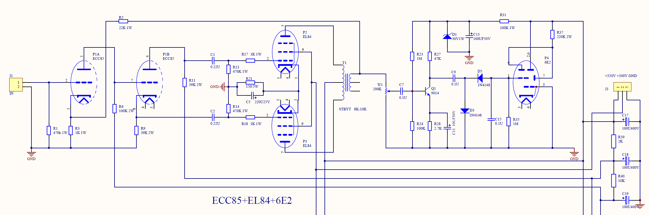

There is a question concerning a part of the schematic that is incomplete as drawn. The secondary of the output transformer is shown as only having one side connected to anything. Obviously (presumably!) you actually have a speaker connected. But what about the grounding of the other end of the secondary? Again, since this is not shown, one can only speculate on whether it has been grounded or not. But the feedback would not work properly, and could maybe have weird consequences, if the other end of the secondary were not grounded.
Thank you very much for your hints!
The output transformers are 8/4ohm ones with the 3th tap grounded to the single star ground point.
Did not change the oscillations. Still seeing them in measurement point 3 and output.Disconnect the Fb resistors from the cathode of Ecc85

After removing both ECC85s still the same in measurement point 3, 5 and output.Also try output stage only, removing ECC85 from the socket.

The power supply is way over-built, when a much simpler traditional (CLC/CRC) supply would be just fine.
Also, the 0.22uf output coupling caps are not needed, a 0.047uf cap in its place would be just fine.

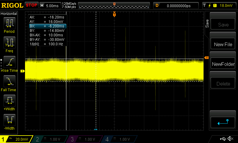

That would make perfect sense. Unfortunately, I couldn't reproduce it.
With the probe tip and ground clip connected to the amp chassis, and oscilloscope & amp both connected to same mains power ground with 3 wire cord no pulses or oscillations visible.

I guess that is not it.
But one more, try these settings:
Set your acquisition to peak.
Set your trigger at 18mV, like your first plots.
Speed up the time/div to 2 msec.

What about the wire dress?
You do have an 8 Ohm non-inductive resistor on the 8 Ohm output tap to secondary common, right?

I'm not familiar with your software 'scope, but if you are indeed showing things happening at only a few 10's of milliVolts, that's likely not oscillation. Much more likely to be switching noise from a nearby source.
Star grounding is fine on paper but often has issues with implementation. The necessarily longer "ground" wires are good antennas and unsuspected ground loops arrive with two channels' signal returns connected together somewhere else.

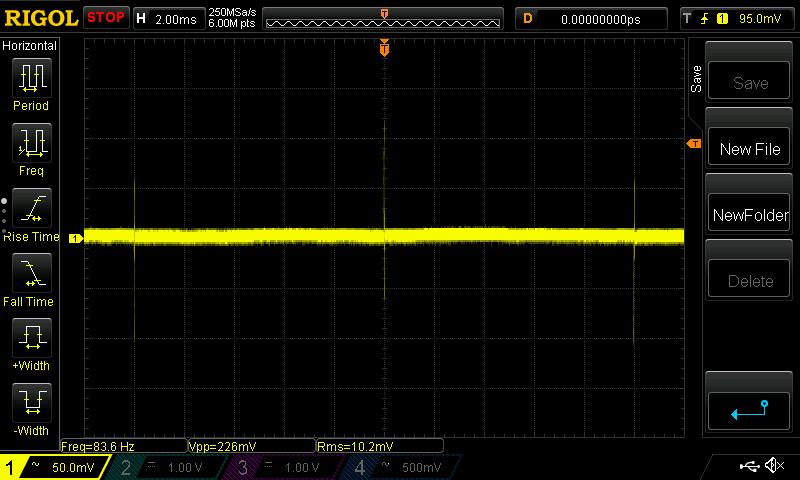

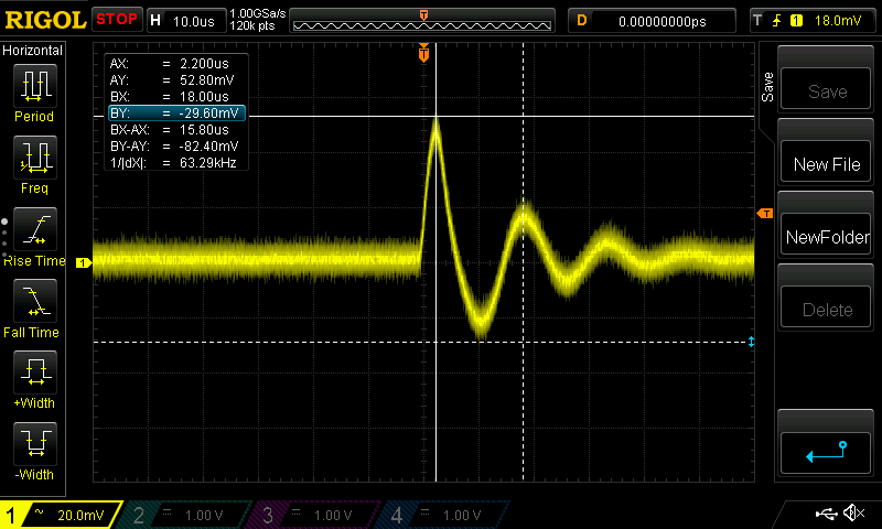

There are two separate things occurring. First, something is getting “burped” at the rectified line rate, and then the amp is ringing a bit at about 60kHz in response to each burp.
My guess is, since the burp itself is short, is that it’s related to the short current surge that the power supply uses to top off the big filter cap on each half cycle. How is your grounding? Could the negative return of the cap be whispering to the input tube through the grounds?
You can separately check the ringing by looking at a square wave. Some ringing may not be bad. Compare the square wave response to other similar amps. You can further chase it by removing the feedback. If ringing is still there, then you have some other feedback path that shouldn’t be, also maybe via fishy grounds. If the ringing is gone with no feedback, then you have a feedback-induced instability.
Hi everyone
Many thanks for the hints and suggestions!
I am on duty for the next few days and therefore have little time for further testing.
Im using a Rigol DS1054Z for the measurements with 8 Ohm/50watt dummy loads connected to each output channel. I'm played around with the acquisition settings to be sure that i'm not missing the oscillations. That is why the settings are slightly different.
Disconnecting the global negativ feedback did not have any influence. I'll try with a 300 ohm EL84 cathode resistor.
The wiring is certainly not perfect, but I have tried to follow the recommendations (e.g. here Heater Wiring - the Good the Bad and the Ugly)
Since both channels are equally affected, something like this seems most plausible to me. I'm pretty sure it's not external interference, as the measurements at another location were exactly the same. The amplitude of the oscillations is indeed very small and does not influence the sound reproduction noticeably. I am simply tempted to find or explain the cause of such problems/phenomena.
As I mentioned, it is a reasonably priced kit, but I have a good overall impression of it. Besides transformers it included two PCB boards for the power supply and the actual amplifier circuit. There are 5 points connected to the star ground point (AC input socket, power transformer, filaments center, output transformers and power ciruit board) with quite short connections. I didn't take a picture of the PCBs, but could find one from a previous board revision online. Apart from a few minor changes, they are practically identical.
Meanwhile i suspect that the oscillations come from the power supply, even though I couldn't detect them on the +350V or +300V line.
Could this possibly be a ringing from the bridge rectifier diodes as a result of the switching? (see http://peufeu.free.fr/audio/articles/Snubber Networks in Power Supplies.pdf). I'm thinking about ordering the components for a snubber network for a try. Which capacitors and resistors would you recommend for this purpose?
If that is still not it, then do the following:
Change the EL84 cathode resistor to 300 Ohms
Pull out one EL84 (the top one, that has the pulse signal from the phase splitter).
Take out the feedback resistor.
(suppose the output stage is oscillating, it could possibly feedback to the earlier stage or stages).

Go back to basics.
Does the 100HZ hum reduce when the W1 is turned down or has it any effect?
If it doesn't the hum is in the output stage, if it doesn't, it is in the driver stage.
