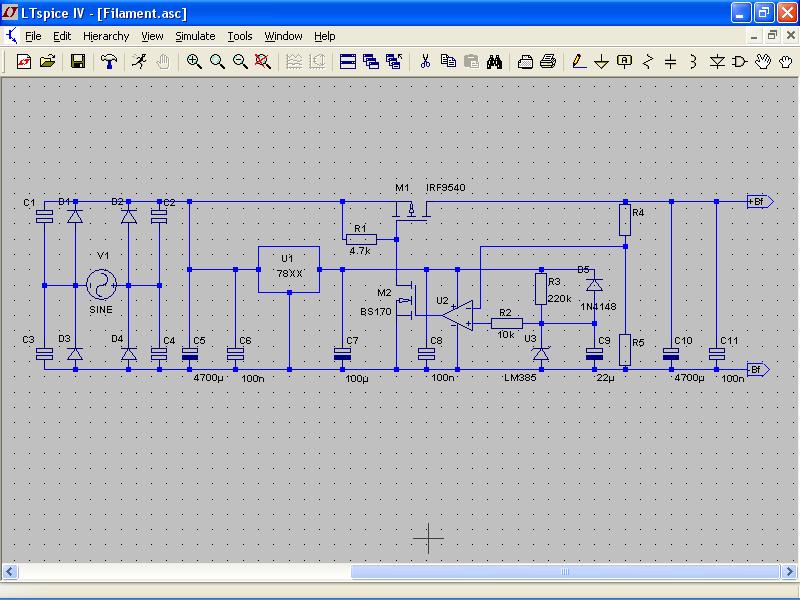

Thanks for all your comments and ideas. It seems I made some progress :)
Well, first I removed the PCB, transformers etc. out of the chassis and tried to elaborate with power transformer's position with respect to PCB and output transformer's position. No change. Then I covered the power trnasformer with magnetic iron shiled. Again no improvement.
The next thing I tried was to:
- disconnect CT resistor network in AC heater voltage from the ground
- replace AC heater voltage by DC - bridge rectifier + 4700u elko + 7805 with 2 diodes + 2x decoupling 100n at the input and output --> 6.3 V DC
- connect minus pin of this DC regulated power supply to amp GND (star GND on the PCB) - without grounding it there was a lot of noise in speakers - oscillations
and WOW - there is no hum in one channel now!
And now the question - what should I do with it?
Well, I can build 2 DC power supplies (left + right channel) for heater using original AC voltage + above described regulator but... more components (space) + a lot of heat from the 7805 regulator and bridge rectifier.
Any other suggestions? If we analyze the root cause - AC heater voltage - and found that making it DC helps are there any other things to try while keeping the heater voltage AC? e.g. CT resisots network connected to +B to GND resistor divider discussed before?
You may be able to use AC by disconnecting the heater traces on the PCB and using tightly twisted wire instead. If you are very careful in cutting the traces you might even be able to repair them again if you decide to go to DC heaters. The idea is to isolate each heater connection from the PCB trace, yet leaving just enough copper to solder a wire to. The newly unused heater tracks should then be grounded.
Regarding DC heaters, you may find that the existing secondaries cannot supply DC as that will require about 3 times as much VA rating.

AC heaters are a PITA, try this, is a DC PSU with low voltage drop, and put an end to about 70 V with respect to ground.
BTW. On both sides of the power transformer, you have enough space.
Ufil = [(R4+R5)/R5)] Ureff
Ureff = 1.2V (LM385 1.2)
Ureff = 2.5V (LM385 2.5)
Hint: If a 7805 seems too much, you can use a 5 V zener.
Any low noise, single supply, op amp can work. ;)
