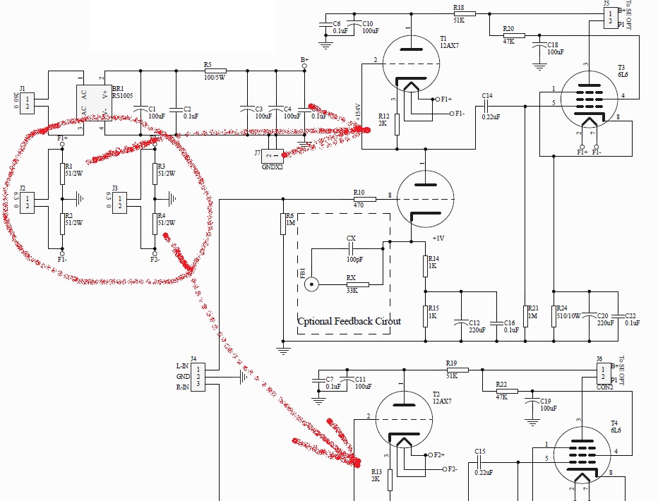

Hi! Yes, there is a CT resistor network connected to GND. Please check attached picture.
And even if there are separate AC heater voltages for both channels the audible hum is the same level in both channels.

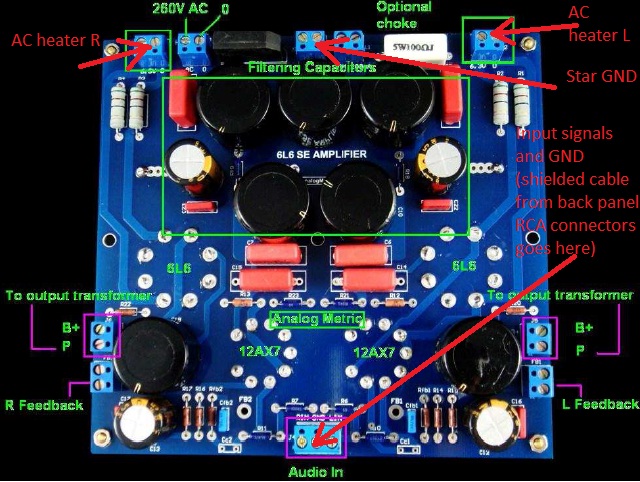

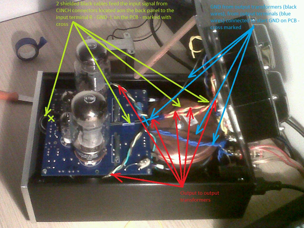

I'm trying to attach some pictures. The circuit is realized on PCB - see the first page with link to supplier's web page.
All pictures show top plate of amp with output transformers open but there is not difference in 100 Hz hum if the top plate is open or closed.
I have a couple of questions, Vcelkamaja:
1) Are the PCB standoffs completely isolated from the PCB ground plane(s)? They should be - it's hard to tell looking at the photos and the website doesn't provide the PCB layer stackup. Easy to check with an ohmmeter with the PCB out of the box - each of the standoff vias should be isolated, connected to nothing. If they're connected to the PCB ground, then you will probably should use non-conductive standoffs (unless you already are using them...)
Also make sure that your mounting hardware have not broken through the soldermask and are touching a ground-plane on the PCB. It happens, soldermask is quite brittle and sometimes a washer can poke through and make contact. Check both sides - make sure there is no outer-layer copper plane that is under your mounting hardware. Use insulated washers if necessary or, better, hardware that does not rest on top of any outer-copper layer on either side of the PCB.
The PCB photos on the mfgr website have shadowing that might be copper-planes which appear to be very close to the mounting holes - it's impossible to tell from the photos, but hardware breaking through and touching outer ground-plane layers is something that's burned me in the past so I'm sensitive to mounting hardware issues...
2) What are the two black wires that are taped to the board with blue tape? Looks like they come from the power transformer area and are soldered somewhere in the preamp area. I couldn't tell where they're connected from your photos - the preamp tubes shadow the area.
Good luck - hope you have the amp humless soon!
~ RF Dude

rfengineer2013: The PCB is isolated from the chasiss and there is now connection realized by the standoffs. I have checked it with ohmemeter. The only connection is with the single wire from star GND to chassis. If I disconnect this wire the PCB GNS is isolated from the chassis.
As for the wires the black wires you've mentioned are the wires feeding input signal from the jacks to input terminal on the PCB. They are shielded.

Thanks Thomas. Not trying to increase the noise level...
You might be on to something with the elevated cathode potential. The board photo on the Analogmetric website clearly shows pins 2 and 6 of T2 connected together - which implies the upper and lower triodes are indeed in the same tube.
And the last time I checked, Thomas, the 12AX7 used a center-connected filament for both triodes :)
The upper cathode is running at about 155V, and with the filament way down at 6.3VAC seems like a good opportunity for mischief.
Yes, the battery idea has great merit! I think Thomas might have suggested it earlier, or on his blog, and I will certainly 3rd the motion!
Thanks for all your comments. Regarding heaters:
- there are separate heater voltages for left and right channel (separate transformer windings)
- input and output tubes share heater voltage
- heater volatges are AC and there is a CT resistor networ grounded in the middle
One thinkg I tried as well was that I doscinnected AC heater volateg from one channel while keeping B+ voltage connected and this channel was without hum. Does this mean that there is something wrong with heaters?
So if I understand correctly the 3 things to try now to identify hum in input triode are:
1. increasing filtering capacitor to input tube
2. elevate CT resistors in heaters - remove the center tap from GND and put it onto cathode?
3. replace AC heating voltage with 6 V battery or DC power supply
Right?
Hi!
Yes worth trying, although I think the üproblem has to do with the heaters, so maybe try this first:
Yes, apply a voltage divider from B+ which will put that node to maybe 60-70V positive. Important: Decouple that node AC wise, that means put a cap from there to ground, maybe 47uF. Don't make teh voltage divider too high impedance. Keep the resistance of the lower resistor in the voltage divider under 20k.
Even if that doesn't solve the hum problem, it is more healthy for your tubes and should be done anyways

What would be easier, at the moment, and could be very helpful, would be more PHOTOS of the details of the WIRING and the pcb.
Also, exactly where is your star ground, relative to the smoothing caps' grounds?
gootee: I don't resist :) I'm just not sure what to improve. I believe that I don't have any ground loops. As for the input - there are inpit jacks on the back panel (isolated) with shielded coaxial cable feeding both GND and signal wire to input terminal. Here the GNDs for L and R channel are connected together and to PCB. Please check attached photo. Is there anything wrong with it?
As for the star GND it is shown on the photo as well and it is close to filter capacitors. All the wires from output transformers and outpu terminals goes to this point (not the input GND that is connected on the other side of the PCB to input terminal). Star GND is connected to chassis with a single wire as well PE from mains and trnasformer shielding is connected to this single point on chassis.
If I shorten the input RCA jack, input terminal or grid of input triode to GND it is always the same. I mean the audible hum level is not changed.
