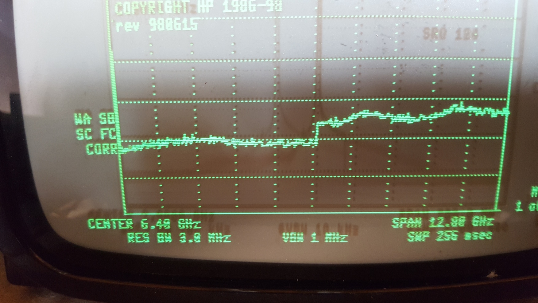

well, I got my dirty little fingers on a nice mint HP8596E Spectrum Analyzer, unfortunately it has a problem, the CRT remains blank as if there is a problem with the HV power supply. When I plug a monitor into the video output, I get good display on the video monitor so the analyzer itself works fine.

Soja, I have been working on this pesky CRT assembly for the HP analyzer all day. I replaced all electrolytic capacitors. The once removed measured all well below rated capacitance and for my taste with too high ESR.
The CRT display seems crippled, it is very dim and at intermittent times it flares up to full brightness. I probed around and measured voltages. The +60V rail measured +75V and the -200V rail only measures -142V. So I replaced D3 and R76 but no change. I guess the flyback transformer is done.🙁

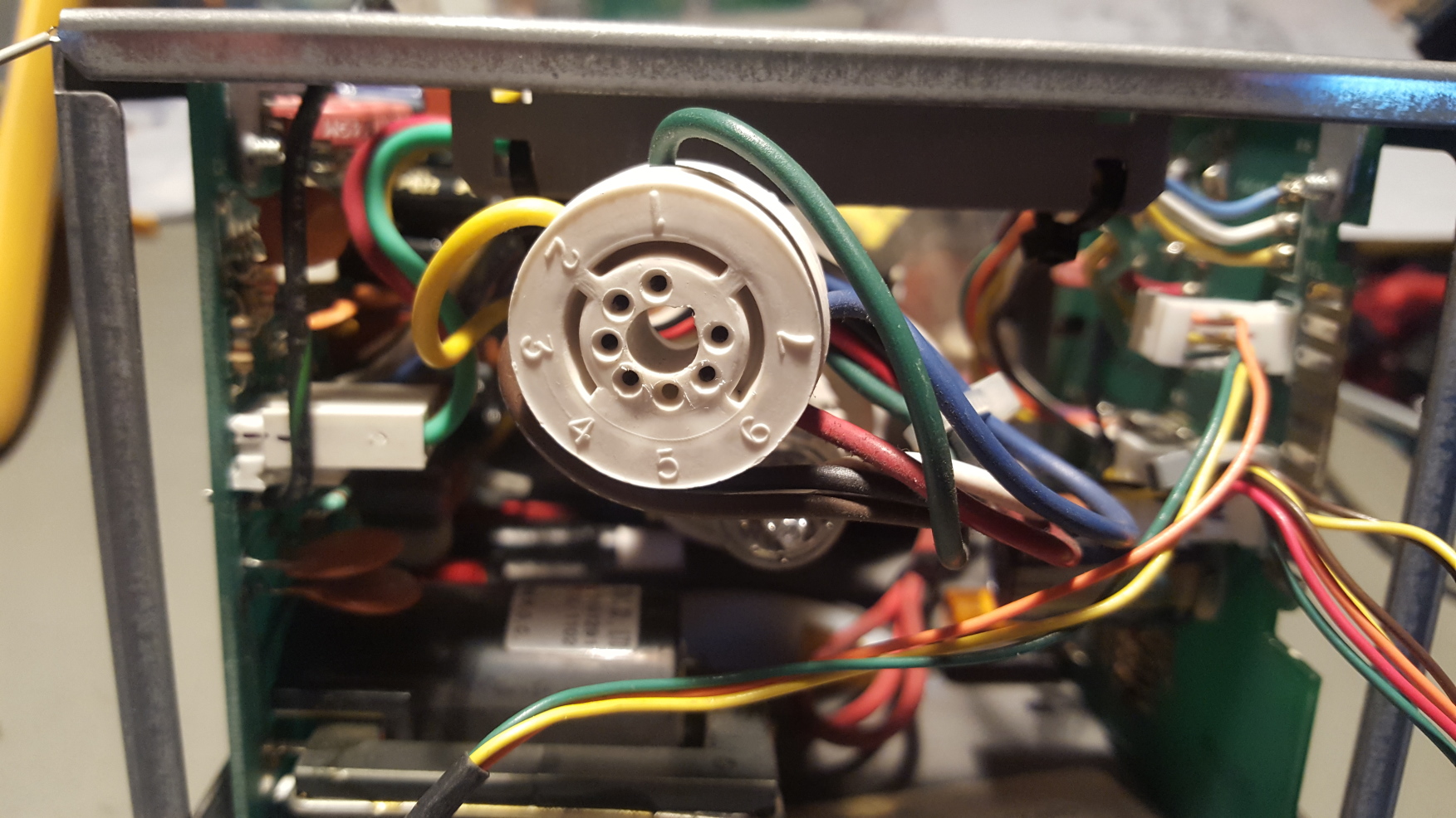

Check that the socket hasn't arc'd over. Not uncommon when dirt and grime get inside.

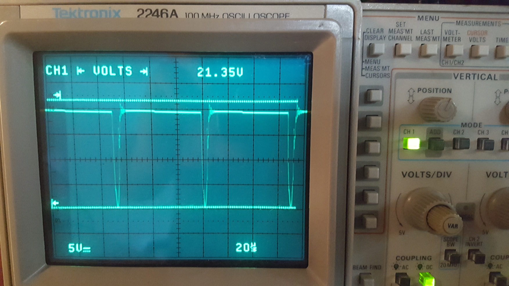

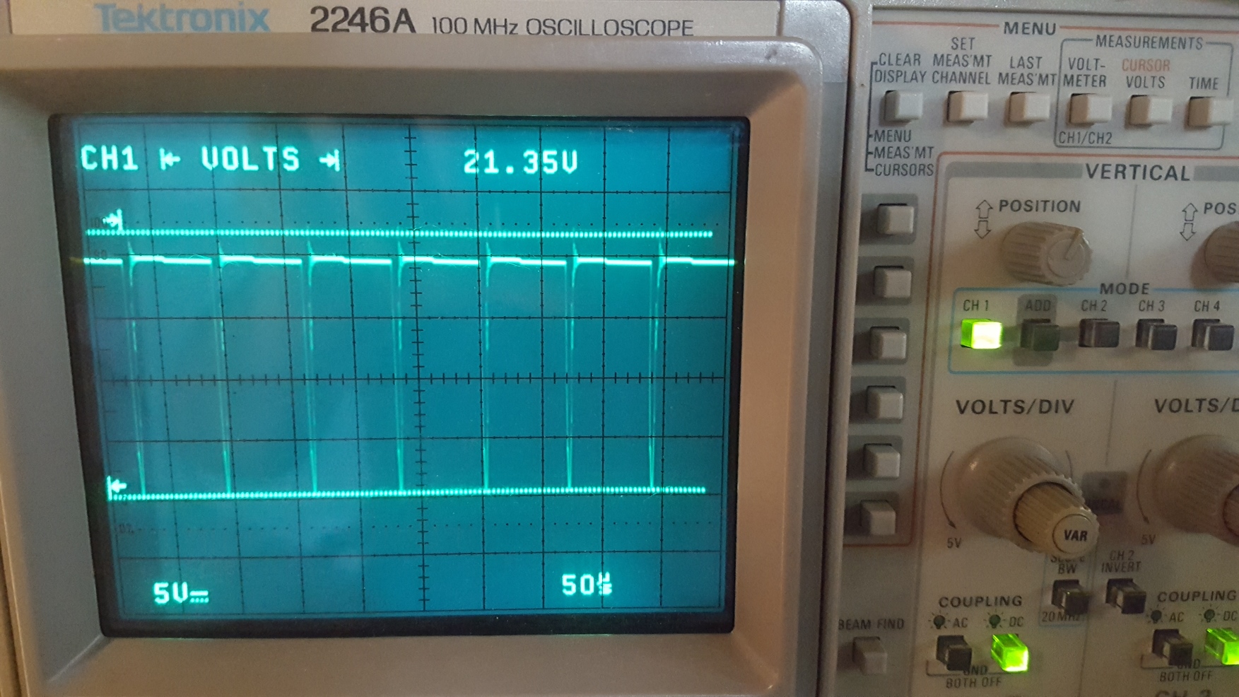

Well, poking around a bit more, this is what I got. The socket seems surprisingly clean. The filament measures about 49 Ohm. and the signal waveform on the 200V winding (pin 8 FLBT DCA) looks like this, getting about 210Vpp. I am not experienced with CRT and tube stuff, so I have no clue if this is a decent waveform but I do not like the hiccup on the rising edge.
I also pulled R75 to see if the -200V rail normalizes, but nope still short at -140V. R75 and C49 measure good.
What do you guys think ?

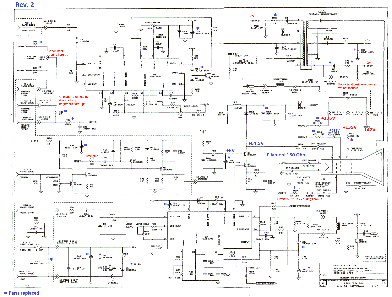

Well, I am not having much luck with this CRT module. I replaced R53, R50, R51, R86 on the brightness circuit except R52 the master pot itself. I increased C36 to 220nF. This seems to tame down the up-flaring a bit. The voltage on the R52 wiper is constant when I get these flare ups. I get these brightness flareups also with the front panel pot disconnected. The 600V rail is constant at 567V. I also replaced R27, R55, R59, R76. I found that during a flareup the voltage drop over the 1k R59 increases from about 50mV to about 350mV. I had a meter directly on the CRT pin 1 and there the voltage changes from about -50V to +30V during a flareup. Overall the image is not really sharp as I would expect it, the focus dial R28 is dialed all the way to the positive side.
Unfortunately I can not verify the HV coming from the FLB. I am running out of ideas, could the CRT itself be bad ?

Those symptoms look like an HV cap in the grid/cathode circuit may be intermittently breaking down. The focus bias and the cathode grid all interact. It could even be contamination around the CRT socket. Lots to check. There may be a tutorial on CRT troubleshooting on the web somewhere.
Many Thanks for your help.
Yes, contamination was suggested, I looked for it, but so far the socket seems clean, no indication of arcing. It appears the socket can not be opened without damage, so I have not attempted to look inside the CRT socket.
Can you have a look at the schematic and advise which caps you might think could cause this ?

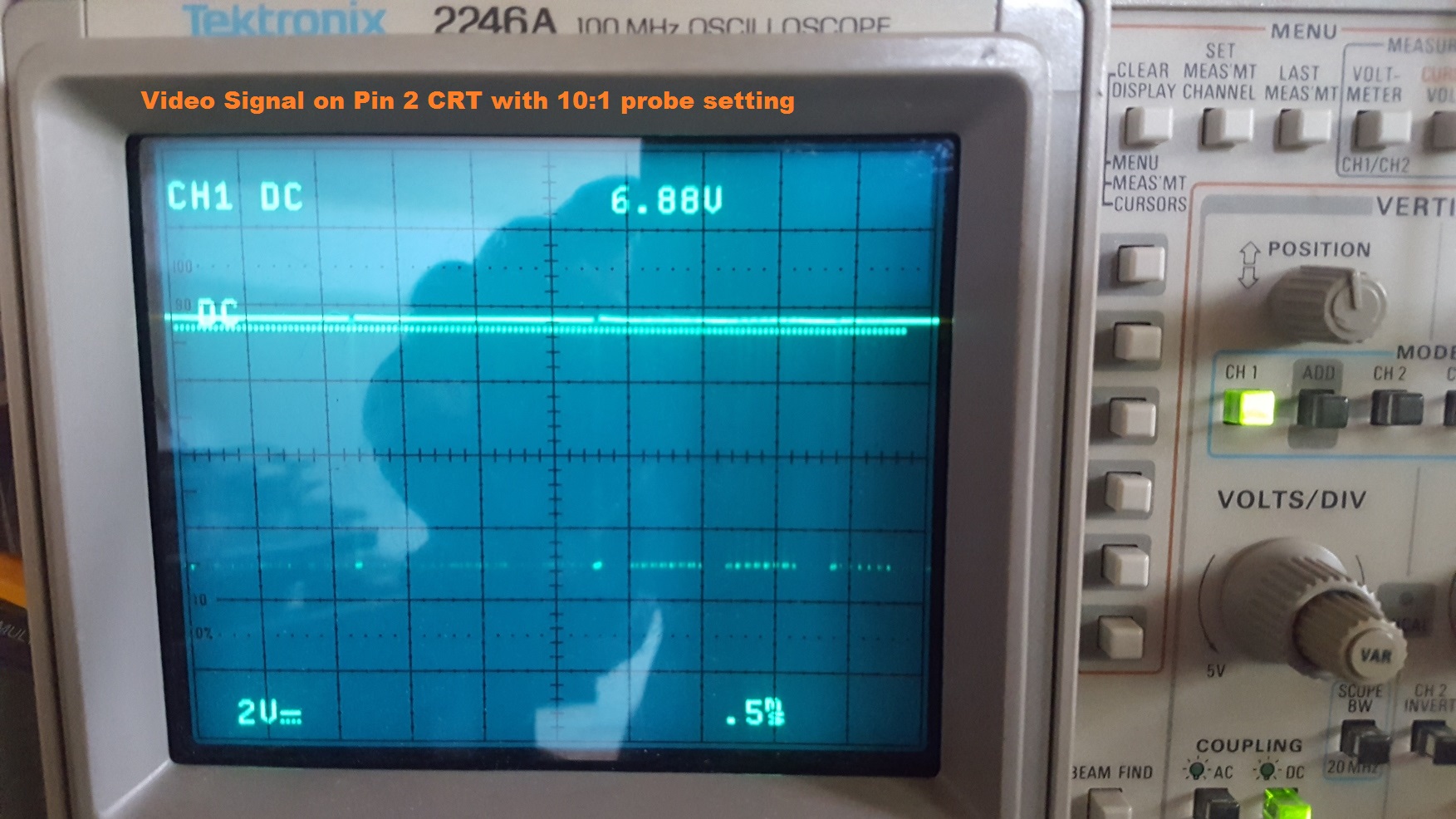

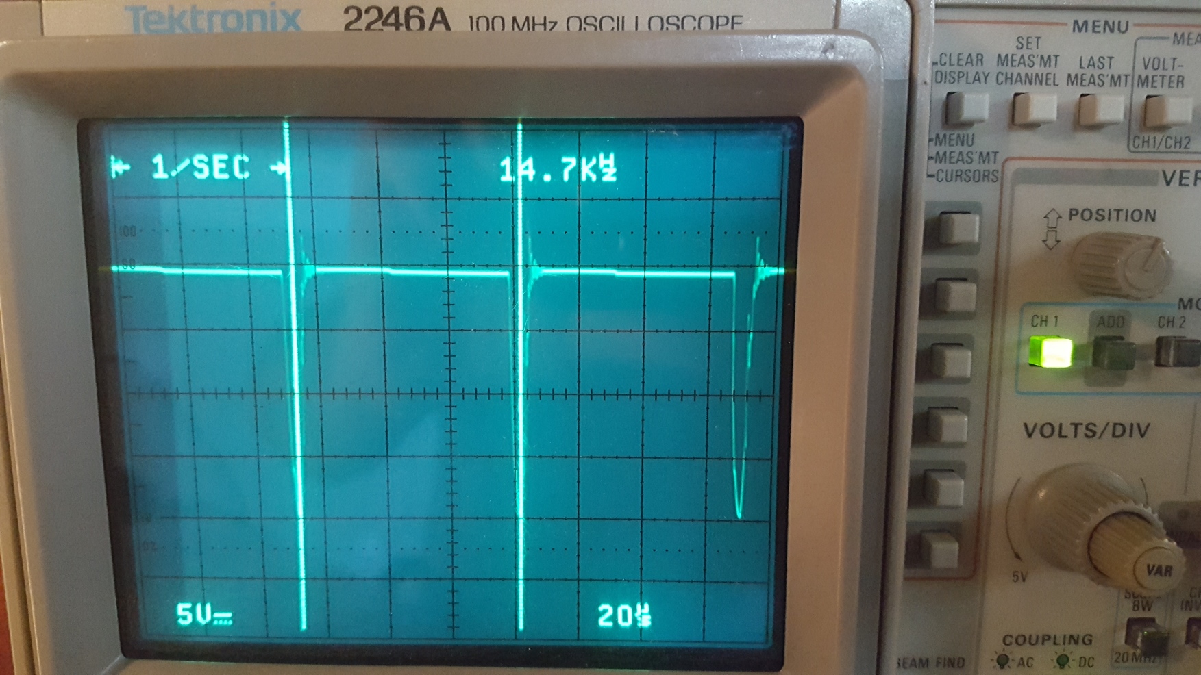

So I opened up the CRT socket, found nothing indicating trouble. I removed each contact re-soldered it and gently pushed the contact forks to have more bite on the CRT pins when engaging. This seems to have helped noticeably with image sharpness. However the flareups still persist. I had the scope probe 10:1 connected to Pin 2 CRT to view the video signal during a flareup. This signal remains absolutely stable. as seen in the image below. Then I had the scope probe 10:1 connected to Pin 1 CRT, there I can observe an substantial instability during these flareup events, as seen in the video linked below. Average DC is rising.

Hi kct,
The schematic doesn't render very clearly on my screen. It appears that R59 might connect to C15? But I doubt my guess is correct, as then there would be no path for DC bias to CRT pin 1. Would you clarify for me where the R59 and C15 connections go and the signal names noted on the schematic?
Thanks.
