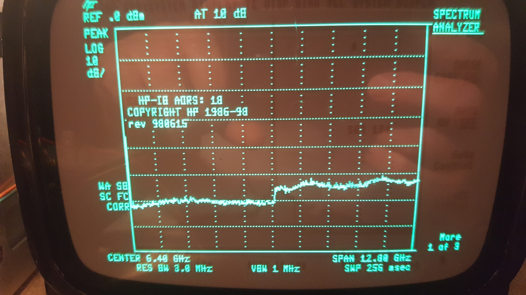

HP8596E Spectrum Analyzer repair

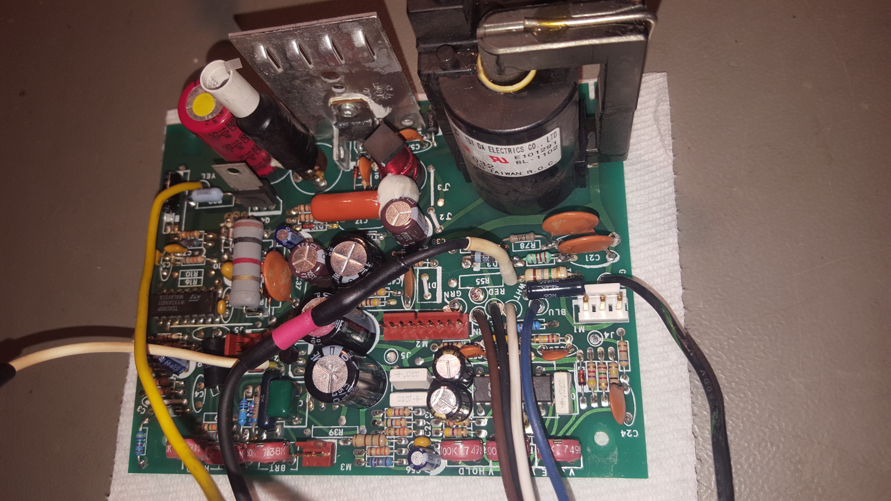

Please bear with me here for a second as I explain my theory. I checked on ebay, and found two such CRT monitors offered, both seem to have noticeable screen burn-in's as bad as mine. Sure this could just mean operators cranked up the brightness with little regard to CRT life, but I suspect a design flaw here. I believe many of these CRT of this type suffer from the same issue. Someone suggested to look for contamination that could offer a creep path for high voltage I looked the CRT socket as many have found problems there, at least on some TV. So at the CRT socket life is good, but what about on the other end of the connection ?
The thing that kept me up at night is that it flares up in brightness not down, this means G1 gets more positive. Confirmed as seen in the video I took of G1. Everything is stable at some DC on G1 and then suddenly I see the G1 rise erratically just to settle back down to about the same DC for a while and then this spectacle repeats.
I suspect intermittent creep currents but not inside the CRT tube, but outside of it.

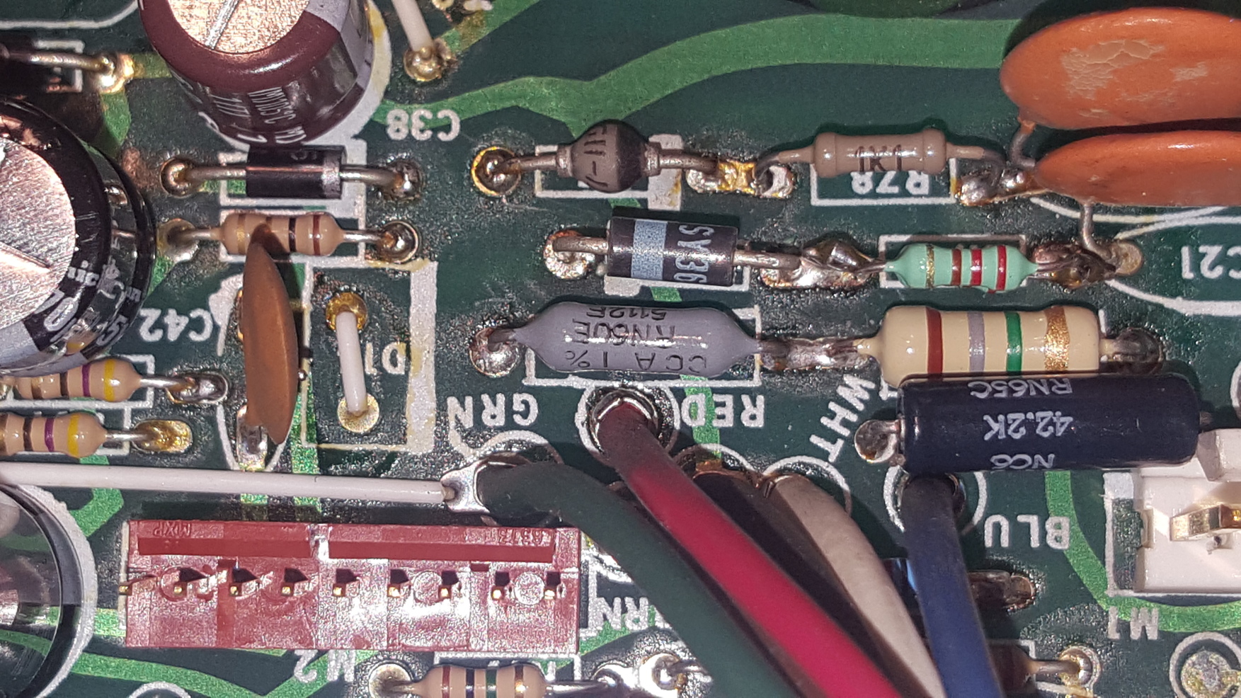

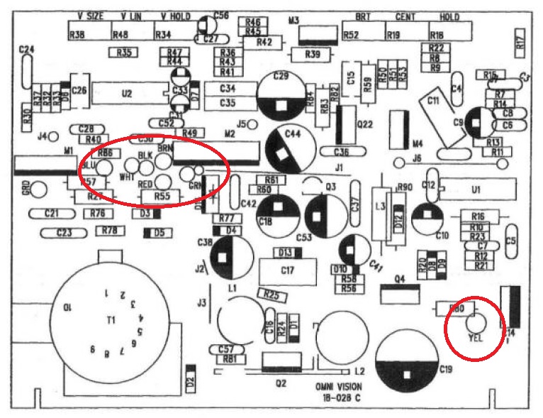

Looking at the PCB diagram, G1 (GRN) is located right next to G2 (RED) on this PCB, perhaps separated by about 4mm or even less than that. Other CRT connection are clustered in very close proximity there as well, except Yellow, the video signal on the Cathode. This signal is far away on the opposite side of the board and well clear of anything nearby.
So G2 (RED) sitting neatly at a healthy 567V just 4 mm away from G1 (GRN)....😀
Hmmmm....
I am not sure what the Layout guy was thinking when squishing these signals this tightly together and on top of that running a jumper J1 (G1) half across the board when he could have conveniently have G1 (GRN) located at the other end of J1. Saving himself the trouble of putting the jumper, using up board space while easing up the CRT connection congestion.
Hmmmm....
Must have been a bad Monday, I guess....
My theory is that, I might have creep right there between GRN and RED, either on the component side or on the bottom. I suspect on the component side, its very crowded an the wires leading to the CRT socket have a little contact crimped to them which is then soldered into the board.
To confirm this theory I will dismantle this entire assembly to get good access to clean this board thoroughly, I will then apply something to add insulation to these connections, I am thinking using my wife's finger nail lacquer or perhaps some silicone. Then after reassembly I have a strong feeling the flareups will be gone.
The more I look at this exceptionally terrible layout design, the more I lean towards my theory.
What do you guys think ?
Does this sound reasonable for a theory ?

Maybe you could just move the circuitry off the board between the brightness control and the CRT socket. It is a resistor and a cap all of which are non critical for parasitics.
The PCB could easily have an issue either internally or on a surface you can't see. If G2 is stable and the cathode is pretty stable then the current to move G1 comes from somewhere else and the PCB could be the culprit.
Those monitors are not built to the same standards as the rest of the instrument. It was a pretty cutthroat business with huge cost down pressure.
Long term the LCD replacement would be the best move but a simple fix would be a good value. Are there connections for an external monitor? Maybe worthwhile to add a VGA connector with H,V and video connected as a backup.
Your theory may well be correct.
To narrow the possibilities, I'd adopt Demian's approach and "air wire" a 270K resistor between the the remote pot wiper and CRT pin 1 so that the board circuitry is unused and disconnected. I wouldn't bother adding the capacitors--- the 270K would be the only part in the grid circuit. If the resulting raster still flares, the defect is likely a grid to other tube element intermittent. With luck, maybe defect will prove to be on the PCB.
It's hard to imagine large grid currents in normal operation, but maybe the designers were intending to cover the possibility of a shorted grid. Q22 appears to generate 50V switching on its collector. Maybe R50 is sized for smoke avoidance? 😉

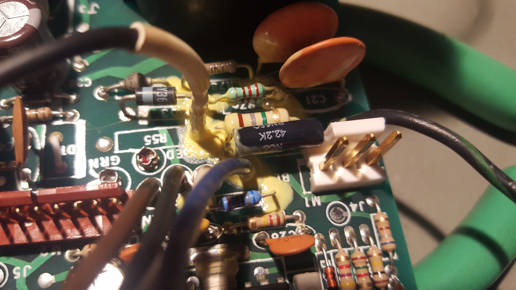

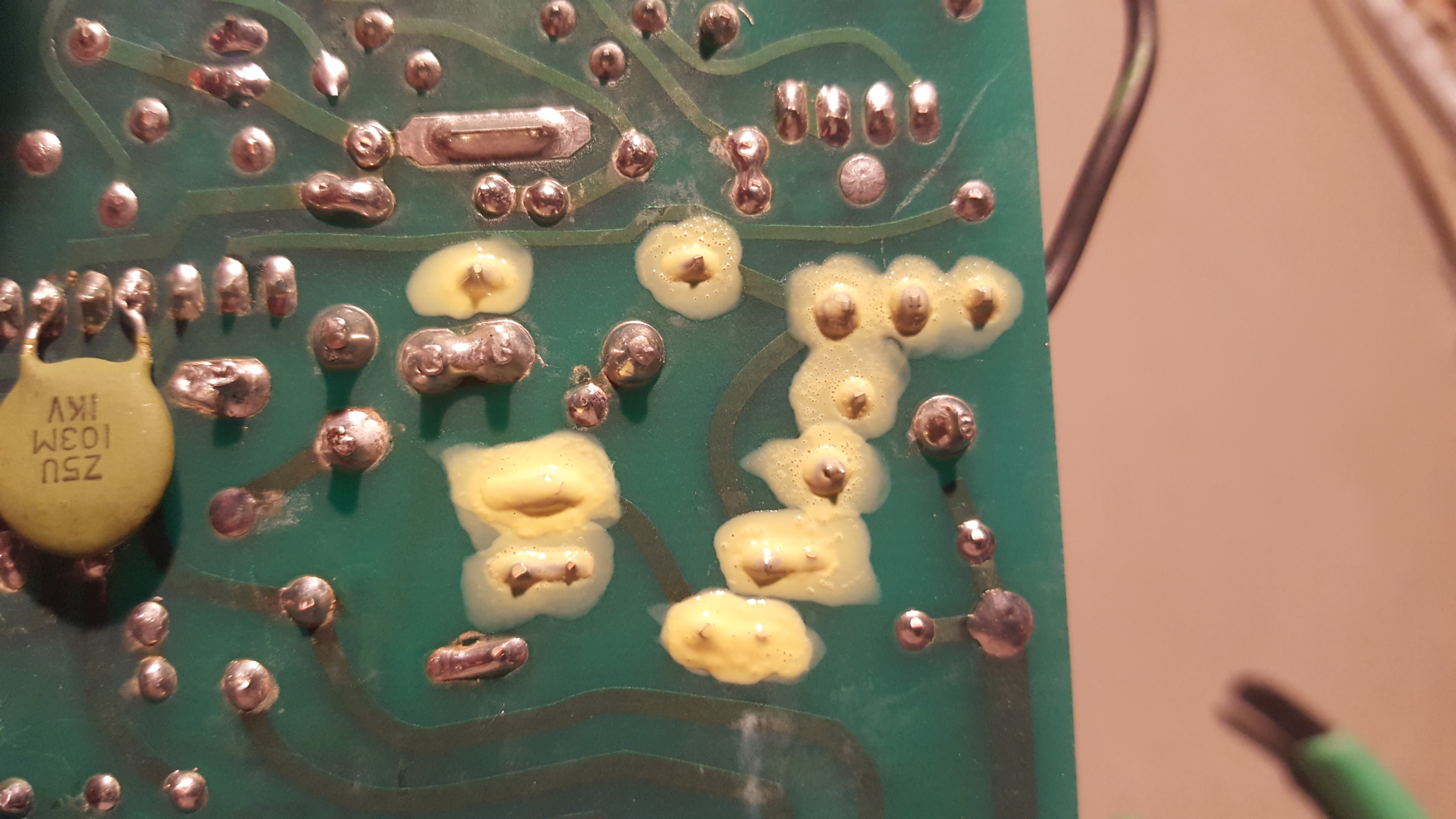

Well, in short, my theory did not work out. The flareups still persists. 🙁
I took this thing apart again and throughly cleaned the PCBs, noticing they were not properly cleaned when manufactured, virtually every solder joint had some flux residue even on the component side.
I rewired G1 and G2 such that they are separated well from each other, I also put nail lacquer on the higher voltage part leads and solder joints.
So now I am back to square one. I guess now I have no further excuse to avoid messing with the HV. Altho I don't think this is a HV problem.
Yes, I also wondered why would they do a 270k with a 1k in series, while the 1k is a fat one. It does not make sense to me at all at this point. For the time been, I put a 2k and another 2k in series, so I have now 270k + 2k + 2k. In between the 2k's I put a 220nF to ground. This tames the flareups a little bit and slows things down altho it does nothing about the absolute brightness variation. Brightness is all over the place, from very dim to somewhat normal and then super ultra bright so much so I worry I could burn something out. For brief periods the image is quite pleasant and acceptable.
